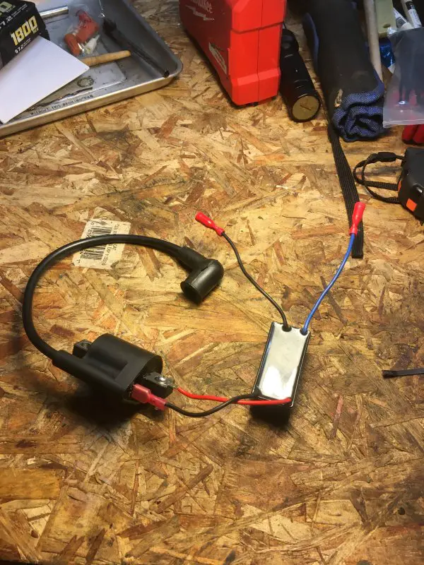

To bench check a cdi you require a multimeter and st it on ohms. I just got a super cdi and being an ex motorcycle mechanic among other trades first thing I do is check electrical components I purchase. Connect meter between red and black wire. No resistance= no good.... BTW mine came with ground wire solder joint to ground pin broken, had to resolder
Oh crap sorry man I for some reason was thinking magneto lol. Well if no spark no work.sorry for misunderstanding. I have spare regular cdi's I am selling cheap if you are stuck.
