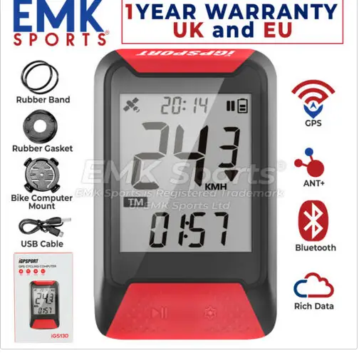

I ruined an old analog MPH speedometer on the 212cc bike and trying to find another one wasn't working. I ended up going with
a more expensive GPS digital speedometer. There are no sensors to add for the IGS130-IGPSPORT unit. I've had it for a year
now and the only thing I found was the 212cc will accelerate fast enough that the GPS has to have time to register the speed.
The unit is back lit for night driving and turns off on daylight. I checked a analog speedometer with it that registers KMH and
found the analog was accurate on another bike. This one is expensive but is worth it just make sure to order a better mount
for it so you can remove it so it won't get stolen. I got mine on sale off of Ebay and the mount was high priced but was also
worth it.

Yeah I went with a gps model as well, I discovered that the resetting wasn’t the vibration but the engine itself, it’s realllllly electrically noisy and interferes with the little cheap speedometers.

I had the best luck on the analog ones which has the mechanical pickup which uses a small pickup on the spokes which
drive a cable to the speedometer. Forget about the magnetic sensor magnet type they never did work worth a darn.
The expensive GPS speedometers are the way to go! (^)
