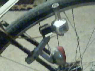

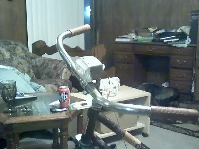

this is an old bike i picked up at the junk yard and to answere the question YES IT WORKS(^) i couldnt belive it but i turned the crank and it lit up
btw this bike cost 3$
i would pay double that for the light!
the part of the frame that holds the rear tire is bent but im only using the front tire, pedal assembly and crank, handlebars, light and seat post

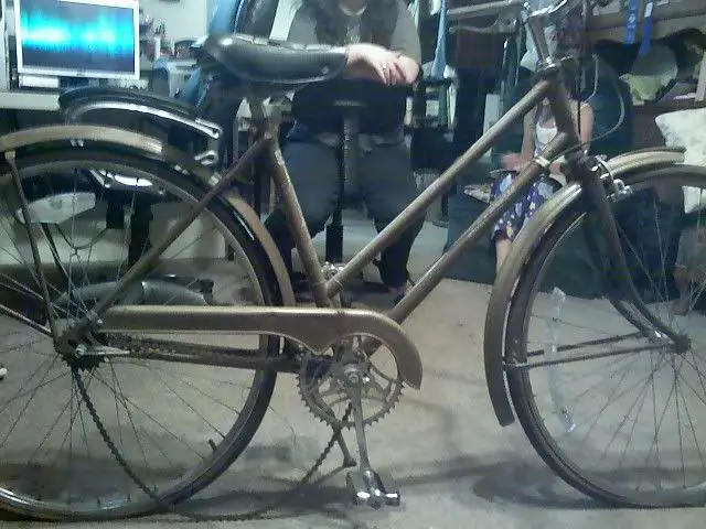

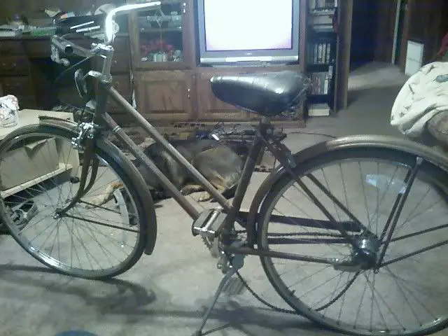

and this is the bike im using the seat , forks, rear tire, brakes, frame patern, the clamp that holds the handle bars and bolts from (the bolts have the brand symbol on them
also the kickstand ^
the finall bike is going to look like the above bike with a bamboo frame because thats the frame im using as a guide

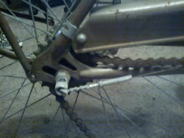

I had problems with the sturmey 3 speed hub, it's too big for the drive sprocket's bolt pattern.
-Ben
Why would you have to change drive sprockets on the hub? If it is too wide, you can allow for that when you build the frame. If you are trying to mount it to the existing frame, you can carefully widen the rear triangle of the bike. Instructions for doing so are available.
If you decide you can't use the S-A would you consider selling it?
Ted
My problem is related to the hub being too fat for the bolt pattern of the sprocket. A different sprocket would solve this but I'm going to swap for a coaster brake hub. Even the rubber gaskets for my sprocket don't wrap around the S/A hub, take a look at this pic. I can't even get 3 of the bolts through, they align with the spokes right where they overlap. I will be keeping it, though.
-Ben
