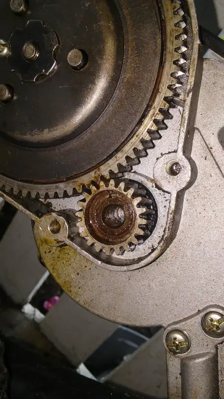

Ok so I'm very new to motorized bike ownership. I recently purchased a nel luso beach cruiser used from fb marketplace (paid 150$, then purchased a used motorized american blades mountain bike for 135$). The bike first shredded the back tire while my hubby was riding it to work, so I quickly learned how to change that out and adjust it to not scrub the frame or the chain (which is what shredded it to begin with), hubby was riding the bike 23 miles a day back an forth to work, after a few weeks or so the back tire seized up while he was riding it. So he pedaled the rest of the way to work. After getting it back home, he now rides the mountain bike. After reading many forum posts and looking at many youtube how to vids, AND today FINALLY being able to compare the two bikes with the clutch gears cover plate off, finally figured out why tje back tire seized up, ABSOLUTELY NO GREASE whatsoever on the gears inside, which I'm pretty sure seized up the smaller gear which i will post a pic of, that will not turn AT ALL. When the clutch is engaged the bike moves smoothly. Disengaged, no movement. The large gear moves less than a 1/8 of an inch, the small gear moves NONE. I desperately need help to get this thing unstuck. Uploaded pic of the gear I'm talking about. Not sure of the proper names of the engine parts.

Welcome to the forum, first take the spark plug out and try to role the bike, the engine should turn over, if not the piston is siezed.
The small gear is on the end of the crankshaft, the bearing is on the crank not in the small gear.
Yes i took put the screw out. It was VERY loose when i first took off the cover plate. Also, I'm pretty sure the piston isn't moving. It doesn't even try to start or turn over when the clutch is released. My hubby unintentionally ran it without oil mixxed in the gas. I'm thinking that may have stopped parts from being lubricated enough to continue necessary movement of certain inside parts???
Short of taking the engine apart, is there a way to unstick the insides? Can I spray or squirt some carb cleaner or something similar into the engine via the spark plug hole or would that be insane to do and ruin the engine???
At this point you can’t hurt it, take it apart and see how bad it is. Depending on how much clearance you have sometimes you don’t have to take the engine off the bike.
