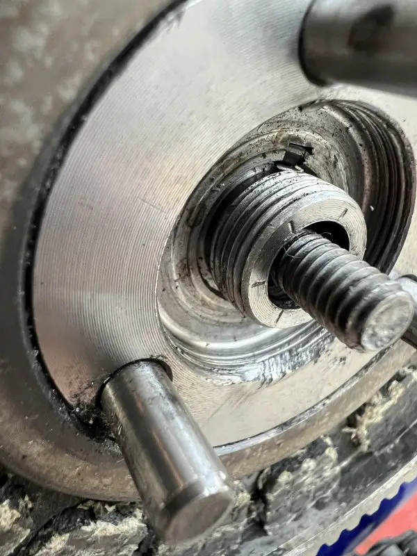

I've been unable to remove the large gear that has the clutch pads in it because part of the threads where the puller tool goes are stripped out. What can I do to get around this since I wont be able to use the puller tool to get it off? Are there other ways to do it? PLEASE HELP! I've attached a pic below.

You can try to pry it from the sides, wood wedges tapped in around the gear where possible then tap the center shaft with a hammer. Be careful not to damage the shaft threads.
