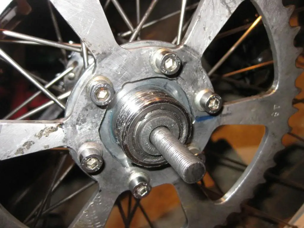

The best way I find is to adapt it yourself. I run those same hubs on my personal 99-212cc 4-stroke builds and I don't like the freewheel. So for starters, I just braze the freewheel solid and then find the sprocket size for the chain I'm using and adapt it to the big 5-hole thread-on adapter.
That usually takes cutting out a huge hole in the center of the sprocket and then drilling the 5 holes to mount it. Sometimes spacers are involved to get the chain alignment right. It takes some time figuring it out usually, but it ain't rocket science.....
Here is a pic of a sprocket I adapted to the 6 hole non-freewheel adapter for the same hub...
another I adapted....
and yet another on the brazed solid 5 hole freewheel

I've been mostly using the AGK 48T aluminum sprockets because they are reasonably priced, the right size for my application and fairly easy to adapt.
