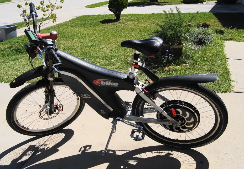

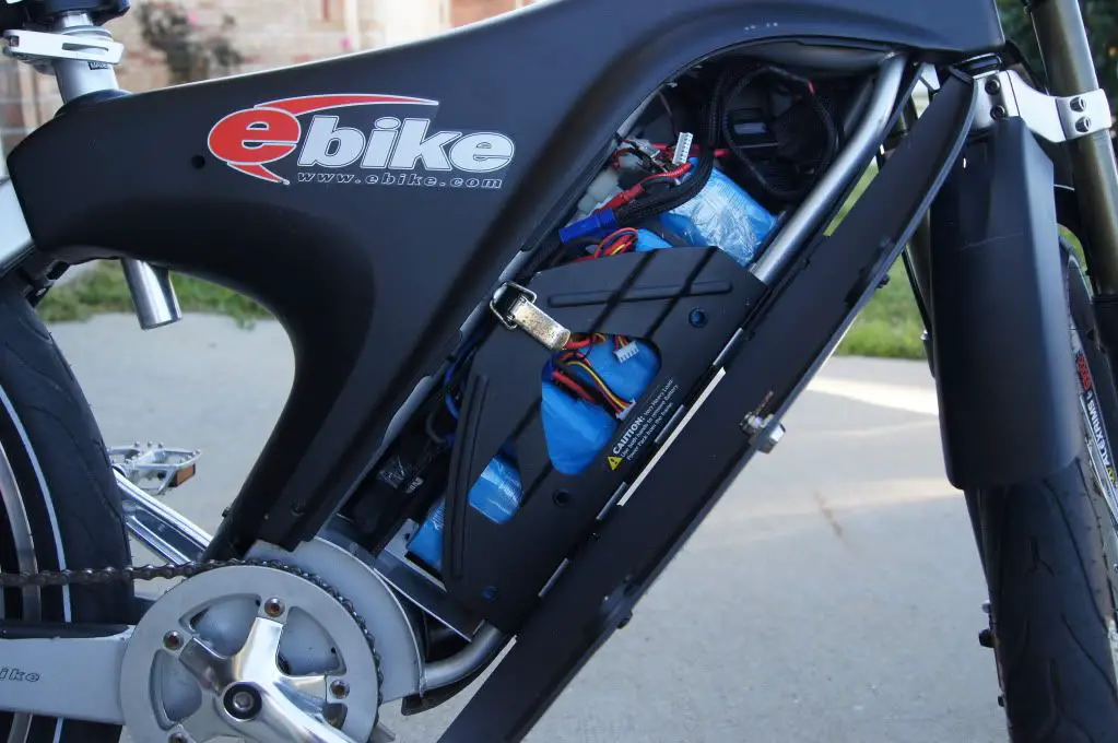

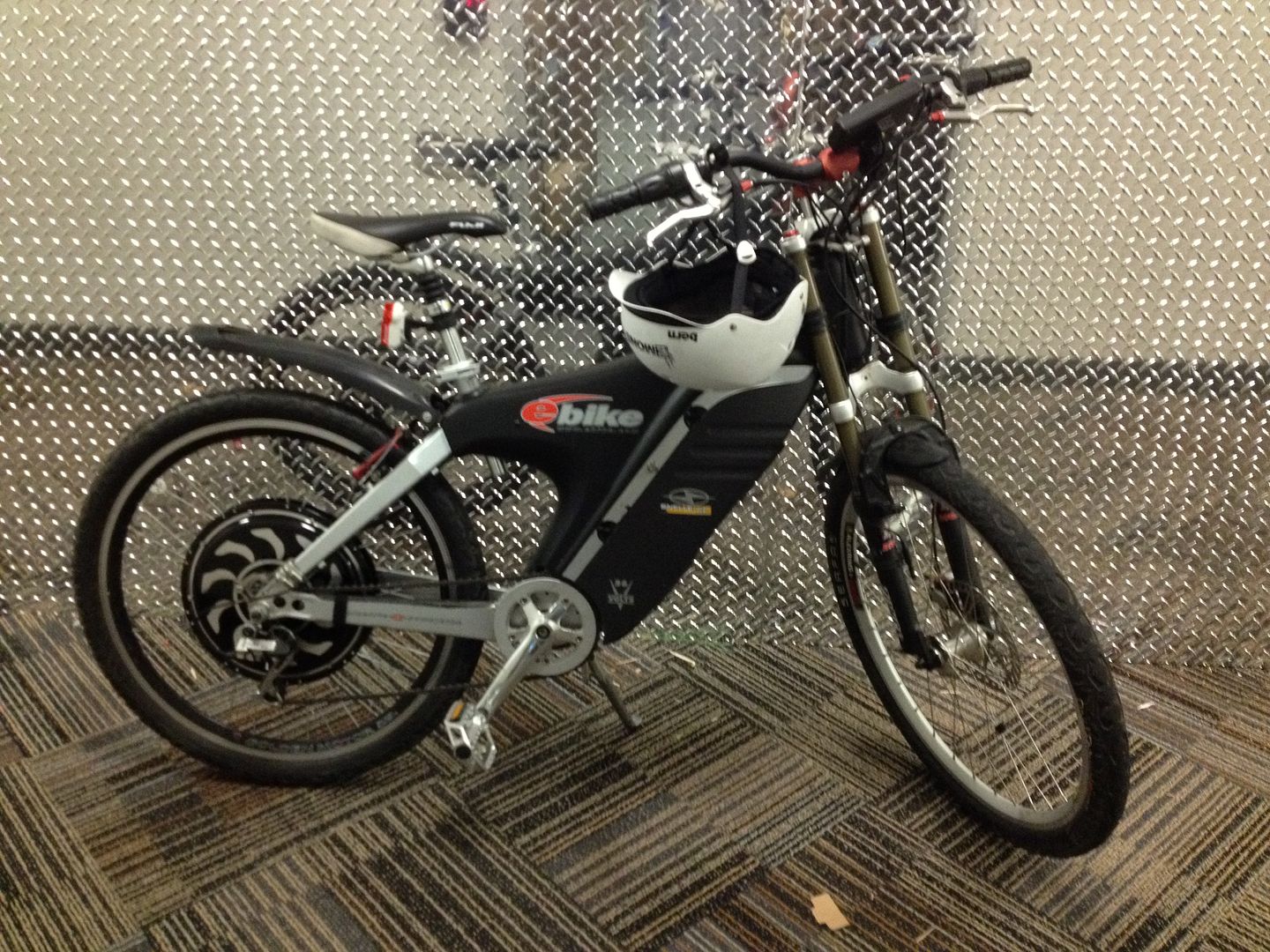

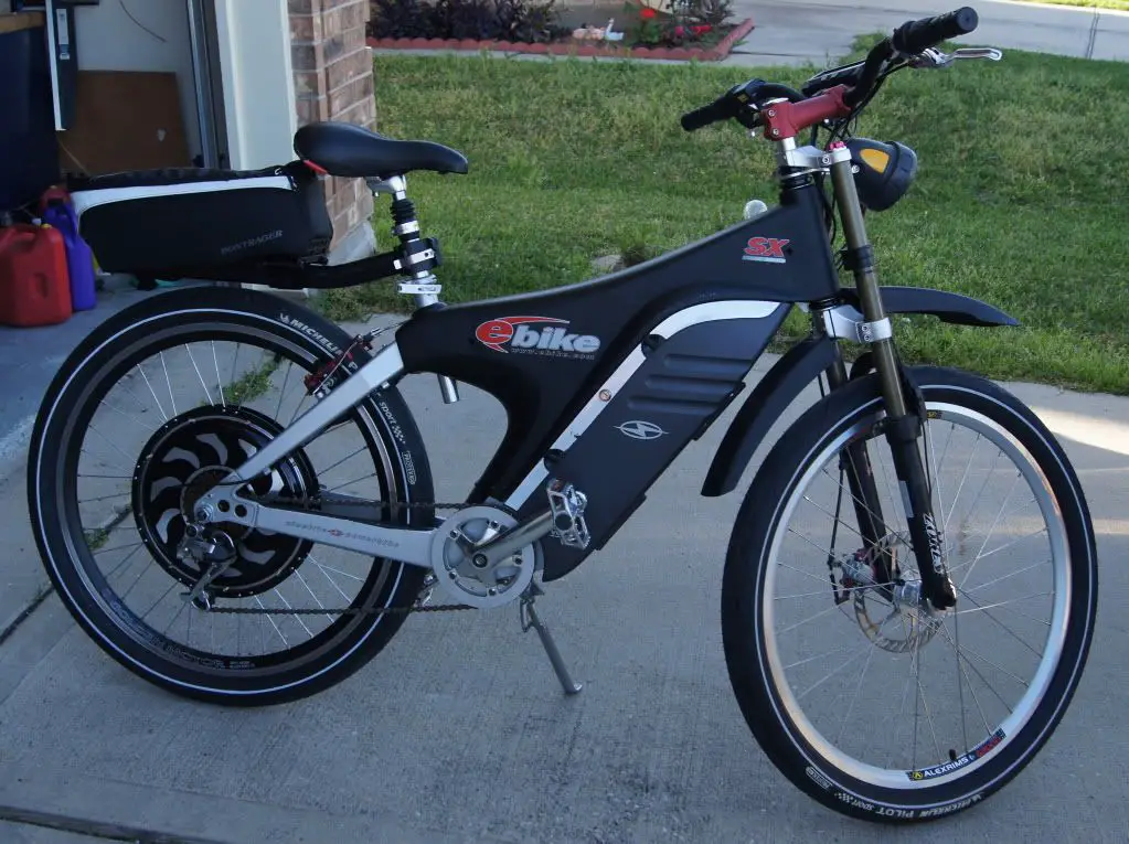

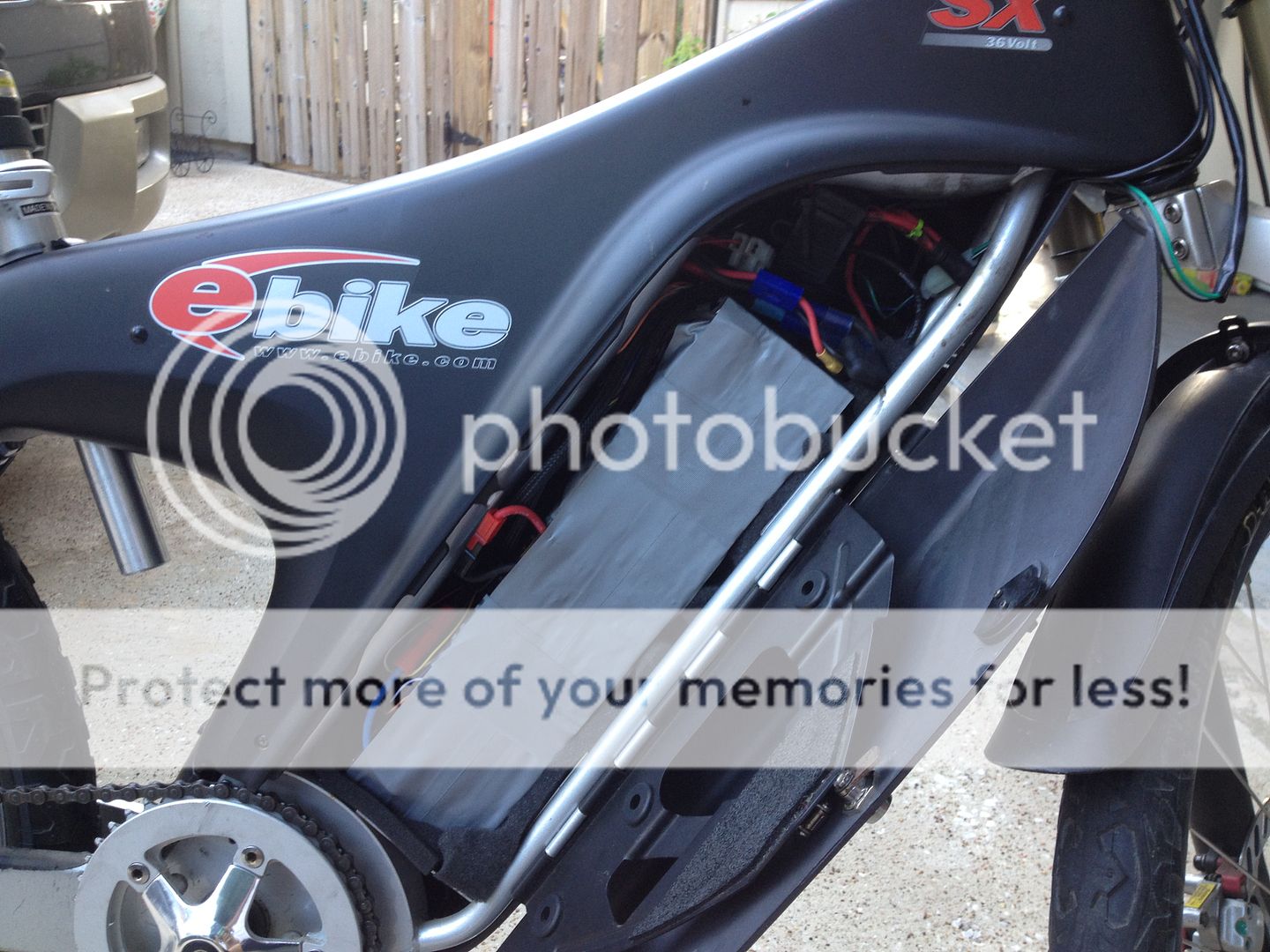

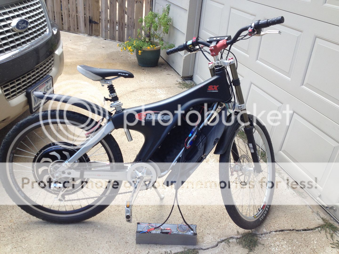

I had scored this EVG bike from craiglist a while back(early 2012). Battery was toast and swapped in A123's in it's place and used it to pull a kids trailer around.  I then swapped over my old equipment from my mountain bike to the EVG bike.  Took me about 4 hours to do the swap and make it look clean.

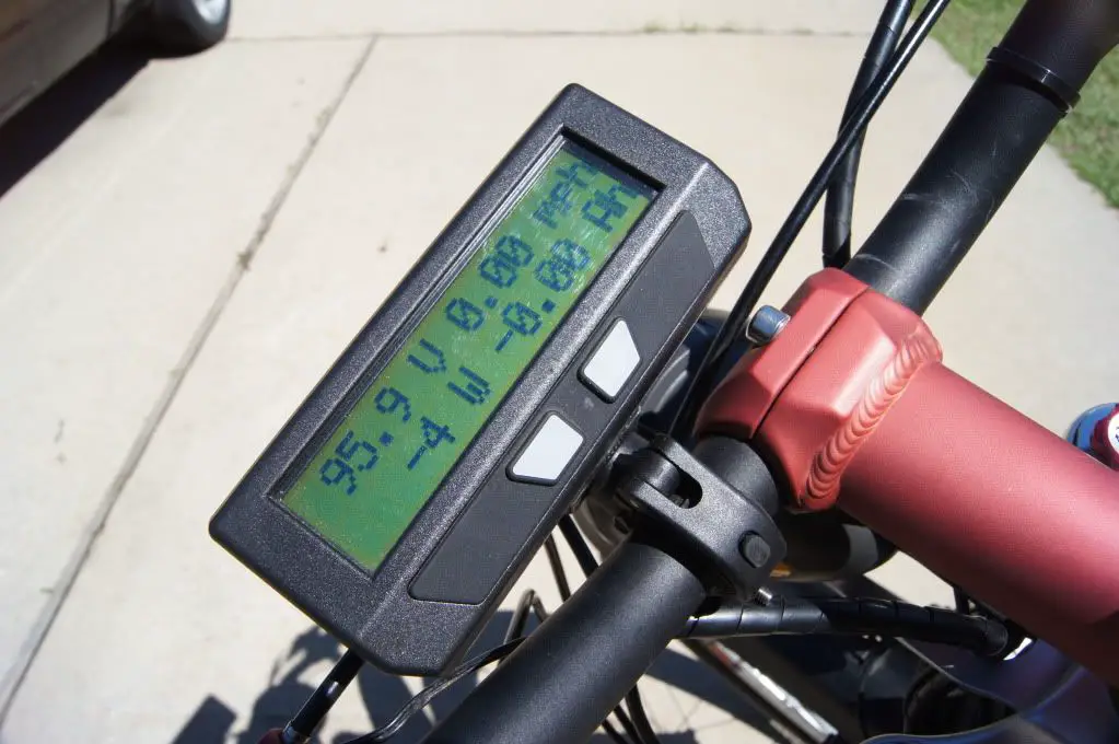

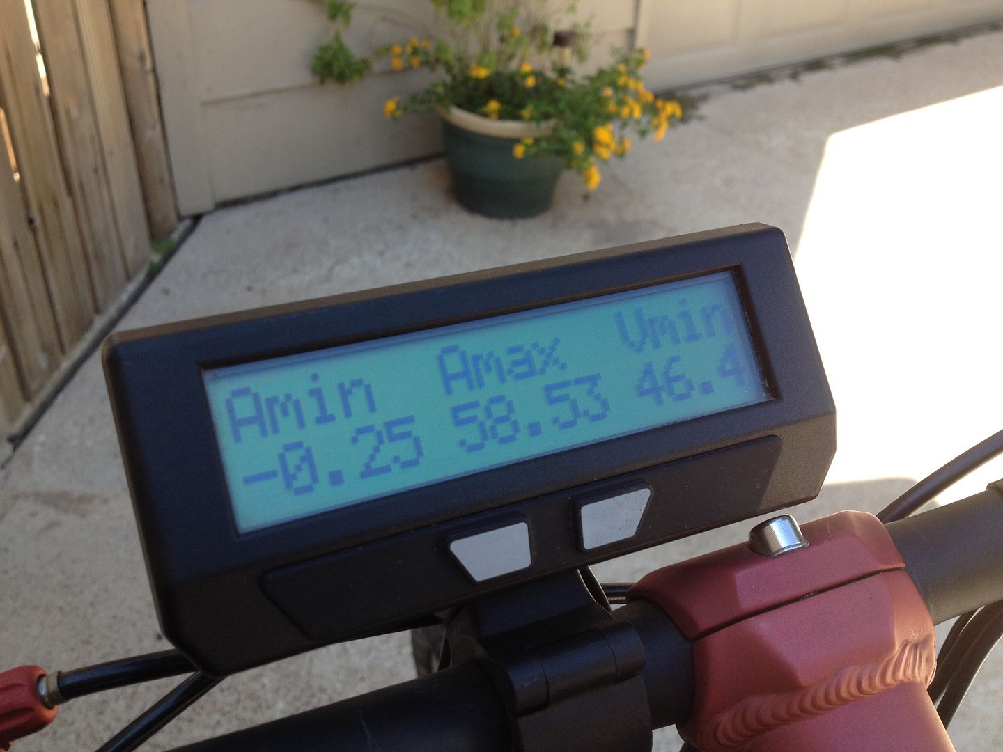

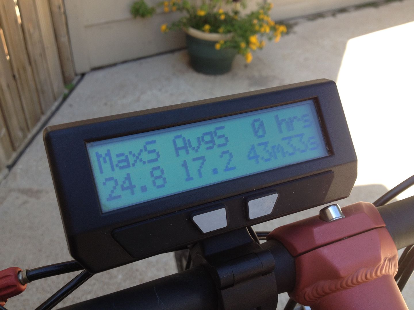

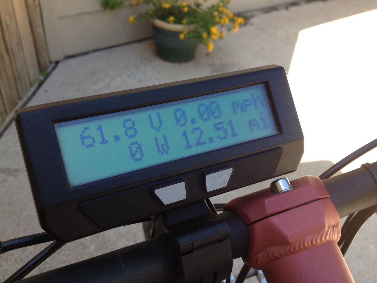

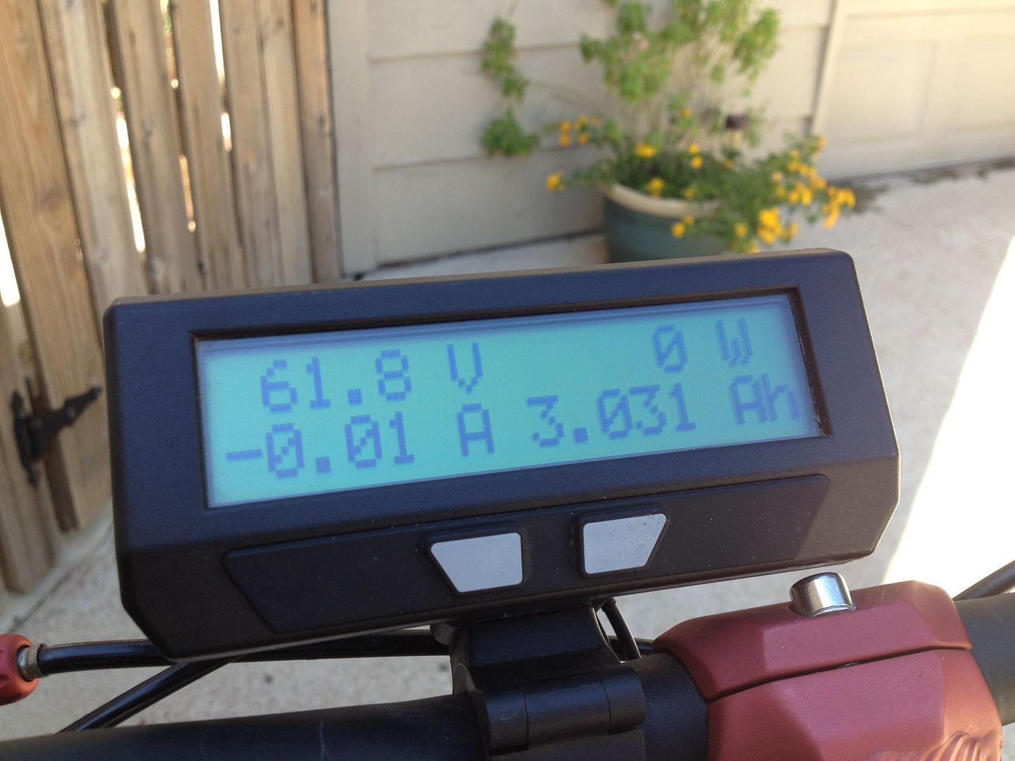

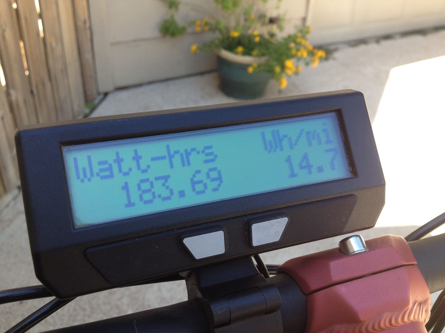

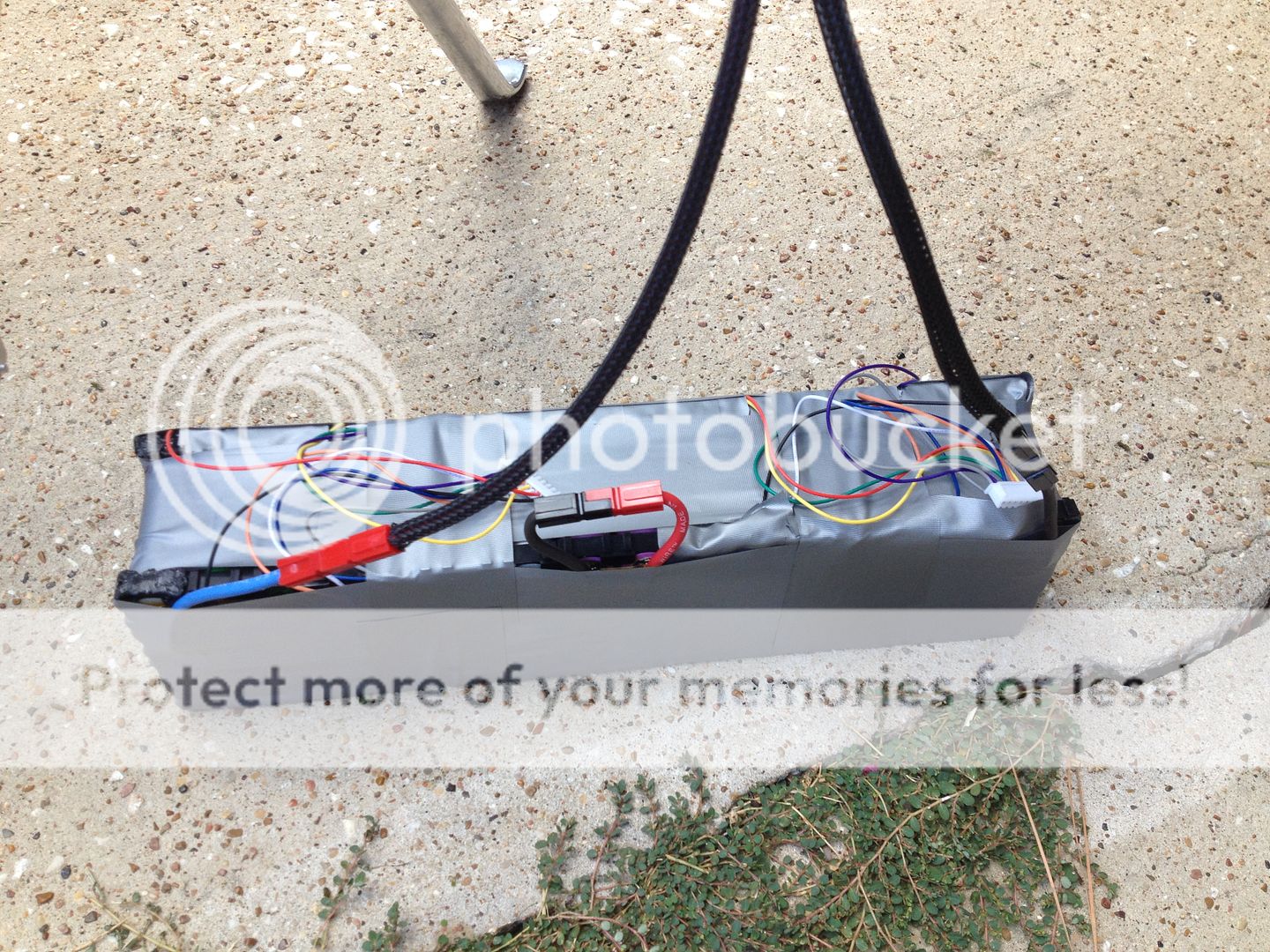

Bike is running on 18s2p 5000mah right now. I only use about 2400mah going to work at max speed. I charge at work if needed.

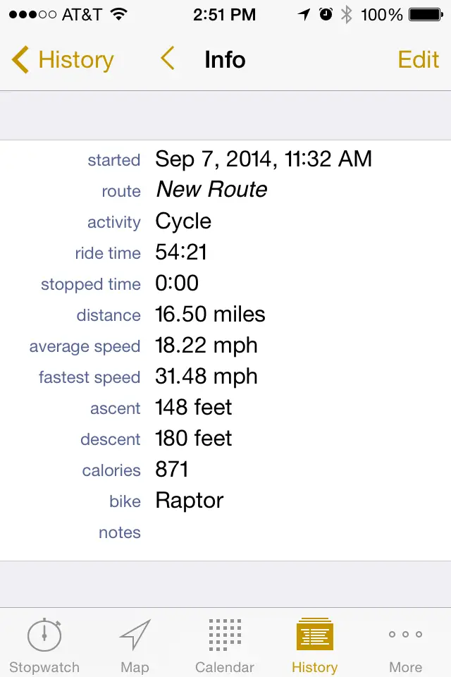

Top speed was 40mph a tailwind and 20s1p. 49.6mph on 24s2p 5000mah lipo pack. 37 MPH otherwise which is plenty fast for me.

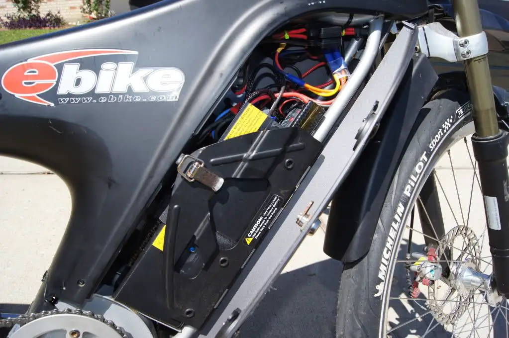

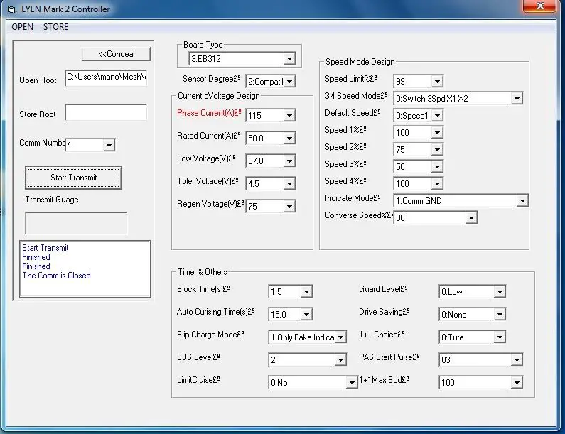

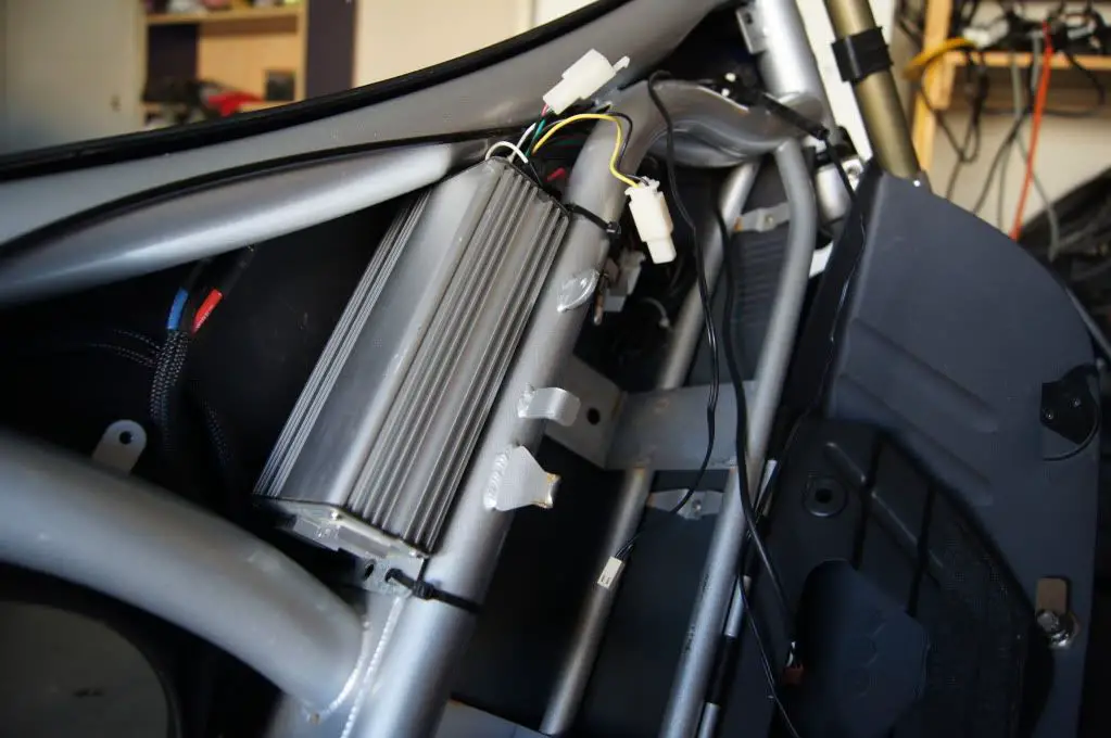

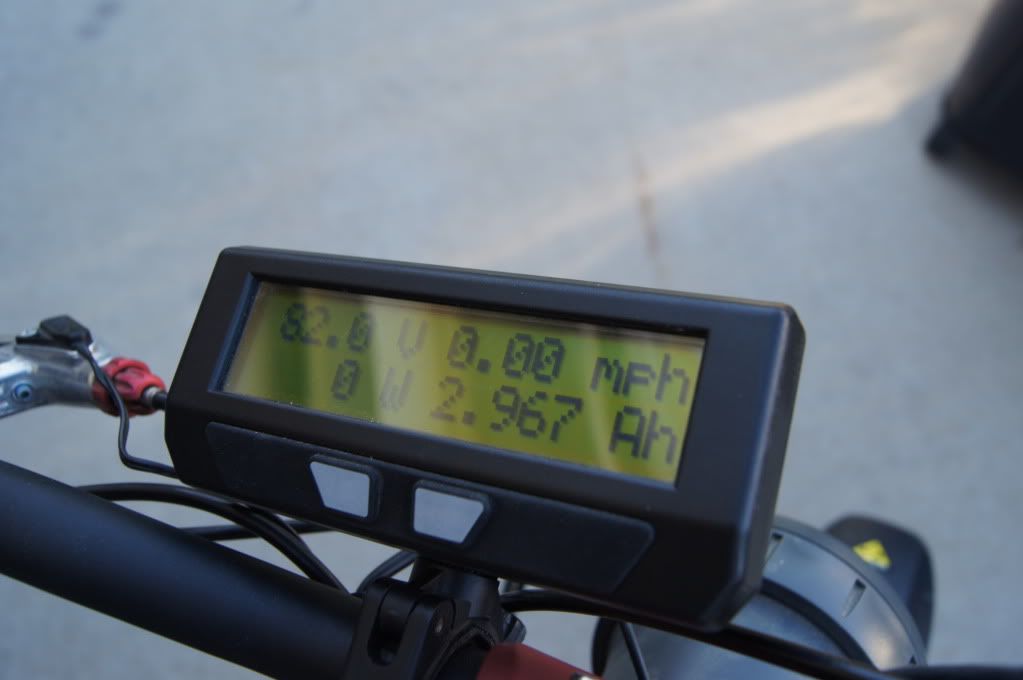

I was suprise to see how small the stock controller really was and that the horn was a 24V unit.
