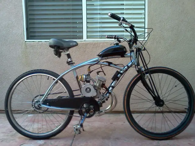

Here ya go feel free to ask questions. Just a basic Cranbrook build with a few mods including springer forks...

Thanks.. its just called a bananna pipe. It works ok.. sounds way better and gives a slight power increase when used with an SHA clone carb. Heck for $30 i just got it
Thanks! No I dont really get up to S.B. being that this bikes the only transportation I have at the moment. But if i ever do make it up there we will have to set up a ride. Its a beautiful area up there in s.b.
I must say when compared to a stock bike with no suspension, the ride is way smoother and enjoyable. Im going to replace the cheap springer with a mountain bike fork with 4-5in of travel for reliability reasons. The springer looks cool and works ok but is built really cheap, My preference would be the monarch fork but they are pricey and im unsure of how well they operate.

Did you remove the petcock from your gas tank and throw away the kit provided fuel filter? If not, I recommend that you do so. At the same time, you should flush all the Chinese gunk out of your tank and install an automotive type, clear in-line filter. An in-line lawnmower type fuel shut off is cheap, and recommended as well. You'll need a barb fitting to go into your tank if you do this.
Here's an example for both of my suggestions; http://motorbicycling.com/showthread.php?t=57089
You can easily remove that kit provided chain tensioner and replace it with- nothing! They are not needed, and it's one more thing that can break. Simply remove it and throw it away. Resize your drive chain, use a half link if you need to, and you won't have to worry about that thing rotating over into your spokes at 15mph!

Ya I was always sketched on the tensioner for that reason, i just make sure to run the bolts very tight and use red locktight on them. I did replace the cheap fueline with a rubber goodyear line and installed worm clamps on all the hose connections. I did rinse out tank when i first installed it. Running stock petcock and filter, but was planning on my next order of parts to upgrade them. I have just over 400mi on the bike and after 3 tanks of regular premix for break in purposes i switched over to full synthetic k2 premix at 35:1. Ran that stuff for years in my high performance goped engines any my kx250 @50:1 with always really good results with the internals when tearing down engine. Also running a ngk #7 heat range plug moving to an #8-#9 because its showing signs of too much heat after long rides. Also fattened up mixture by 2 sizes lastnight im going to see how it works today with the main jet size change. Thoes sha clones really like to warm up before they run best!
As far as major problems with install, really non. Seems like the cranbrook frame specs wher ment for the engine kit. But sofar had magneto go out(from a desodered ground wire on unit), had to replace toped due to forign objects(aka metal shavings) causing ring failure and cylinder/piston scarring, coaster brake arm stripped where arm meets cone nut while riding i believe due to not servicing/greasing my rear hub and a few flats, which now i run slime front/rear. But through all these issues i was able to locate and replace weak points with stronger upgraded parts making the bike pretty darn reliable with proper maintenance and attention to the areas that require it.

It'll hit 40 in perfect conditions 35 is my normal avg top I usually cruise 28-30 all day and max temp won't rise above 250f. I did put a rse high comp head on it since taking pics and leaned out the carb and added a boost bottle I made which really cleaned up the upper rpm range and improved the throttle response. Also re wired the magneto with new 16g wire from coil to cdi box which really helped the entire rpm range I was pretty amazed at that and I also shortened my plug wire to about half of what it was.
