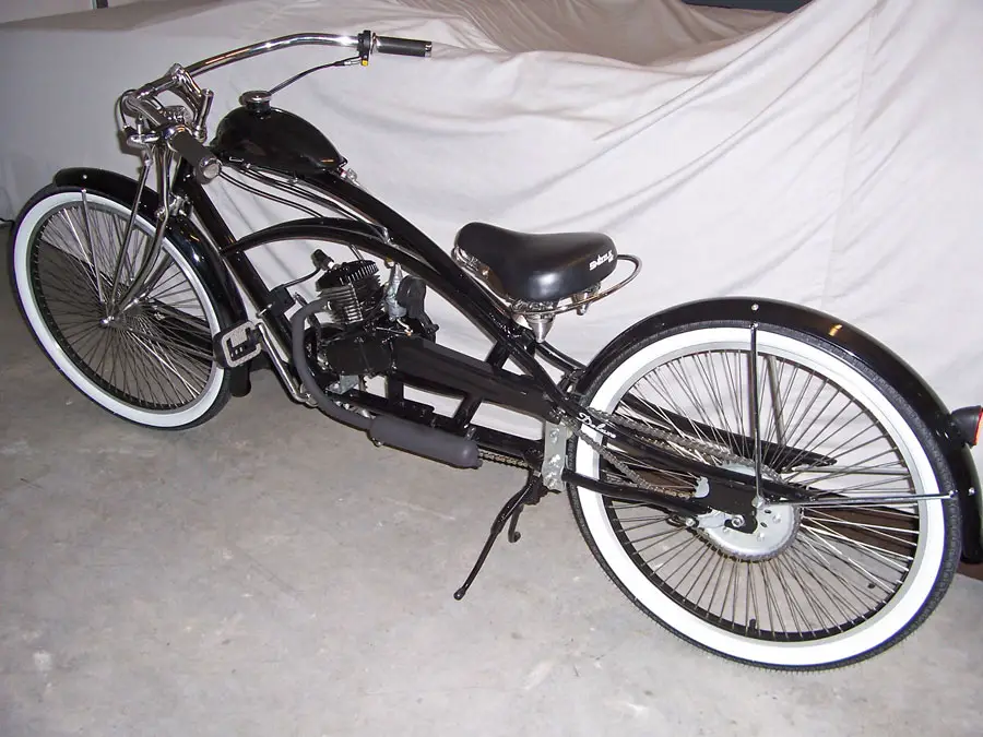

I'm finally getting close to completion on my Micargi. Here are some pics. I dicided to mount the motor in the center of the frame, which took a lot longer and required some custom modifications, but I really like the look.
http://motorbicycling.com/attachment.php?attachmentid=20203&stc=1&d=1265763909

I built mine from hangars for truses from home depot i think number 9 hangars
a little time consuming but cheap
I searched the post and 2 or 3 people did the same thing on here marcagis

After those pictures I added another chain tensioner for the top of the chain to keep it from slapping around. It's a long chain and the clearance for the frame is very tight. As for the pedal chain guard, I cut the top so that the motor could slide down lower, this left the pedal chain untouched. You will also have to cut the rear fender just about where it mounts to the frame. I have also added a turnbuckle to keep the motor from lateral torquing. I don't get to this site very often, but I will try to take some more pics of the new modifications before I sell the bike. Getting the motor in the center of the frame took a lot of engineering, but the look was worth all of the effort. This was my first build.
