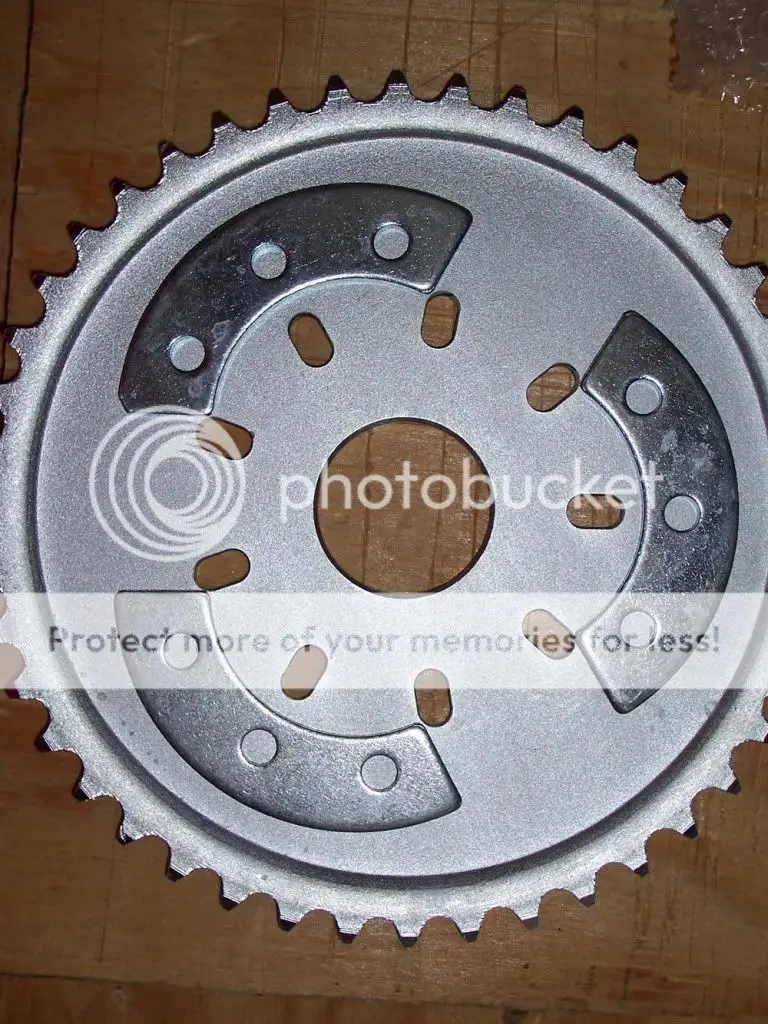

So you do have to go out that far ?
How about the rubber shims do you just cut them into 3 peices ?
Now when i put the rubber behind the sprocket it seems to space it out to far to get the
brake lever back on but i guess when moving the bolts out that would correct that problem.
