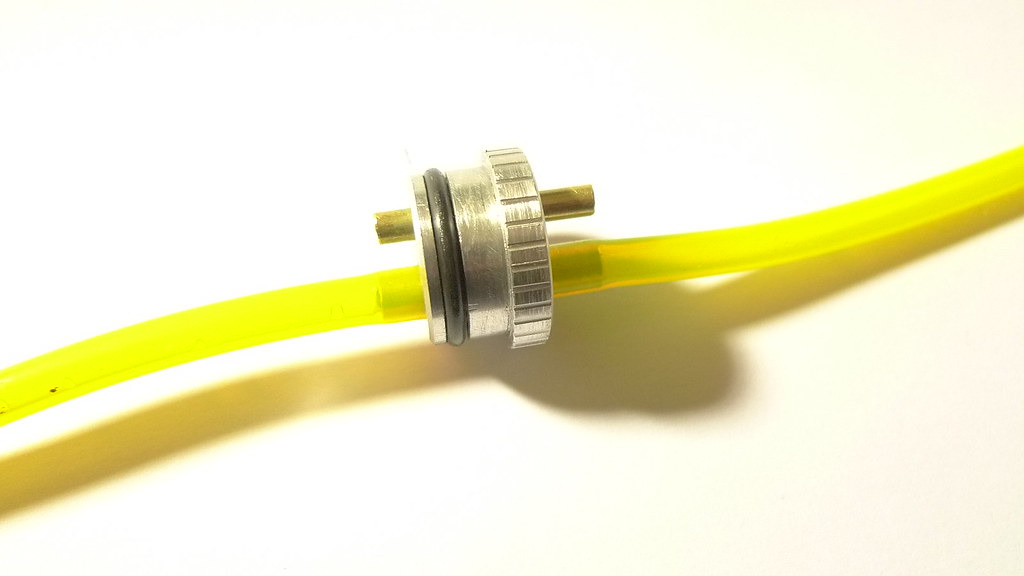

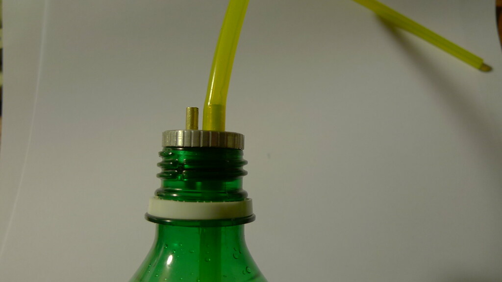

Just a pic of the adapter I made to use a soda bottle with my EH035 engine. Uses the standard POC 1881 bottle size.

Actually, the whole need for this was my tours often require shipping the bike or traveling on a bus or a train. None of those allow containers that have had fuel in them. No gas tanks allowed. So this allows me to arrive, unpack the bike, buy a bottle of soda, drink it, then just use that as my fuel tank. No hassles with shipping that way.
Every 7-11 keeps an assortment of fuel tanks in stock.

Deacon. If you PM me a shipping address, I'll send you one for free to test if you'd be willing to give feedback. (I made a few...the joys of cnc).

That would work. The problem, though, is that the seal in the cap wasn't designed for very many seal/unseal cycles. So you'd probably have to make a new one every so often. Plus the caps are thin, so getting a stout connection with the fittings is difficult.

Deacon: Side-mount should be no problem. Even upside down will work. it's an air-tight seal. If you're not using a diaphragm type carb with a return line, you'll need to run a vent hose someplace higher than the top of the fuel level. I'll include a drawing.

The nice thing about the soda bottle, is that it was designed to be pressurized. A soda bottle is an amazingly strong thing. A water bottle or an oil bottle is not designed to hold pressure, which can occur when your tank heats up in the sun.

It the 1/4 inch line yes and I can figure a vent out no problem. I just needed a minute to think about it. I have plenty of the really small tubing I'll just plug one and put a pin hole in the line near the end the run it along the bottle. So that when it flips it will be above the gas level.
