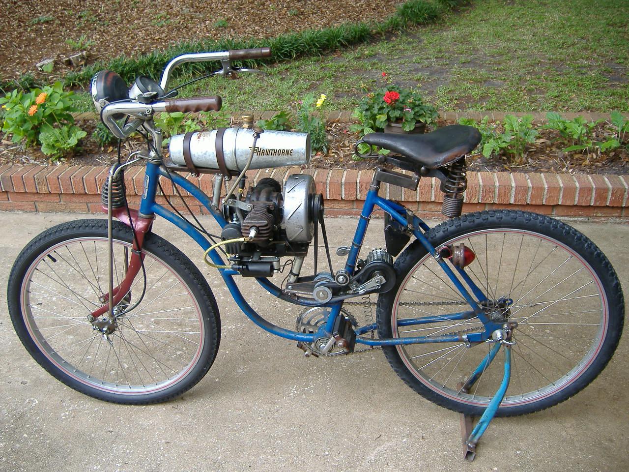

Do you have any close ups of seat modification? I was considering potentially of doing something similar to the seat of new build I'm having done that will be ready soon? Where did you get that large seat saddle?
Hey CB, I might have to use the type spring you used. The bracket to support the rear springs might look out of sorts with the rest of the bike.
