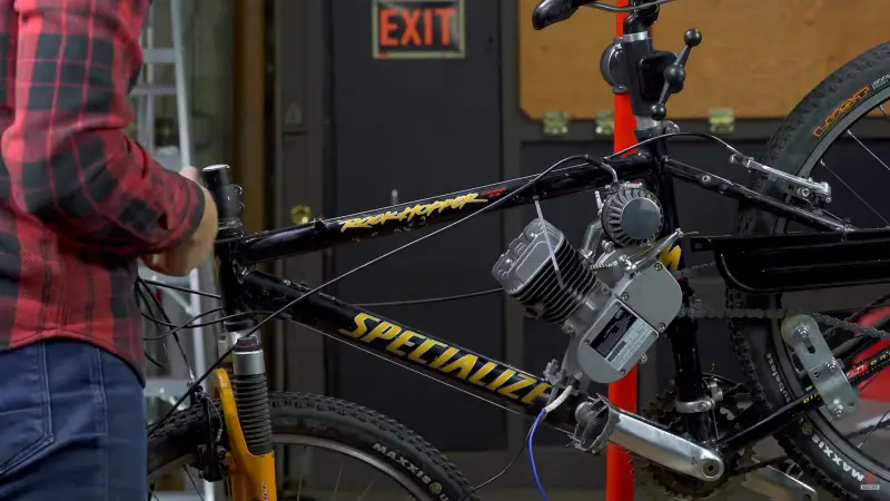

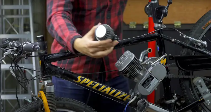

Hi all, I'm wondering if anyone has mounted their carburetor like this in these pictures? The pics are from the Fortnine video where they make a hill climbing motorized bicycle.My bicycle is the same exact setup as this guy's, just want to know if anyone else has done this or knows where I can find something to mount the carburetor like this?

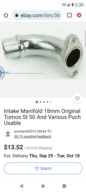

A lot of people make their own, there are some offset intakes available from the vendors that sponsor this forum or from eBay etc. a friend of mine used a piece of hose to clear the seat post, keeping the float bowl level makes the engine run a lot better throughout the rpm range.
42mm stud spacing but there's plenty of meat to modify and make it fit... For a stock piston port...
