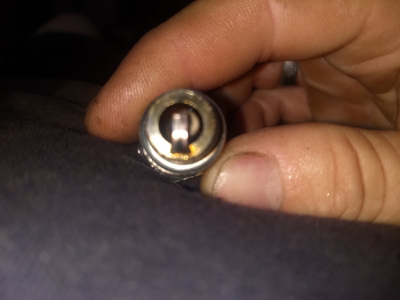

See my problem is it starts bogging from 35 mph or the last 1/8 of my throttle.
I can get to 40 mph but its not running smoothly but surprisingly my sparkplug stay very clean and only has detonation scorch on one small spot at the front of the electrode. See photo.
Should I be happy with what I have and leave well enough alone or maybe go with the offset key to get full power band.
It only bogs on flat road but runs right when going up a slight incline.
I just noticed the electrode inside the sparkplug is not centered in the sparkpug itself. This could be part of my problem. I am going to get a new one and see what difference if any it will make.

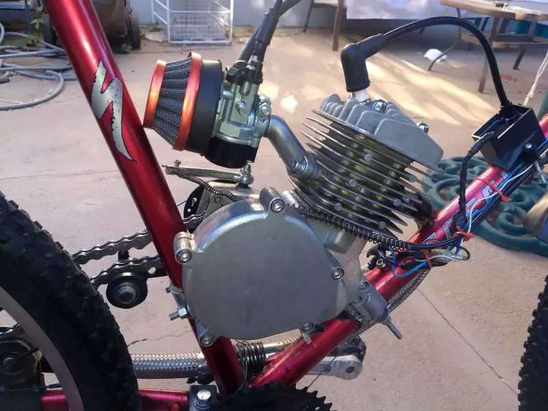

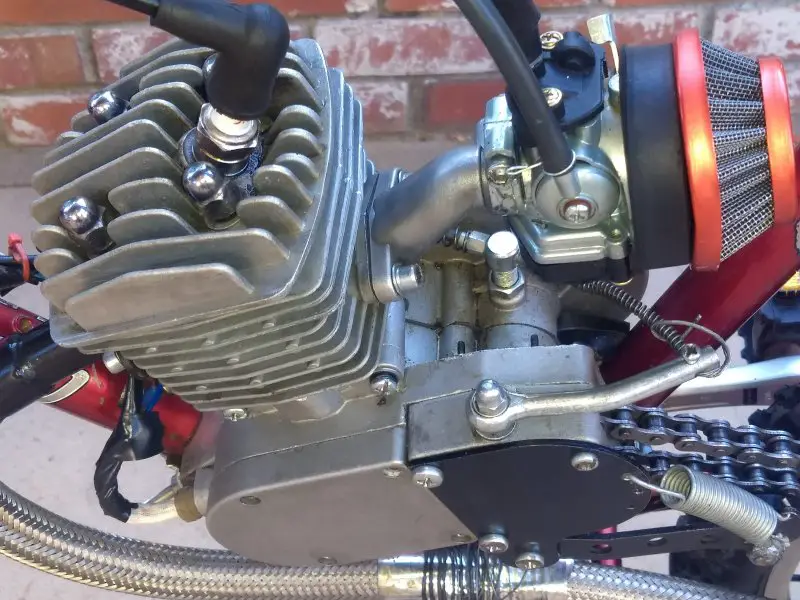

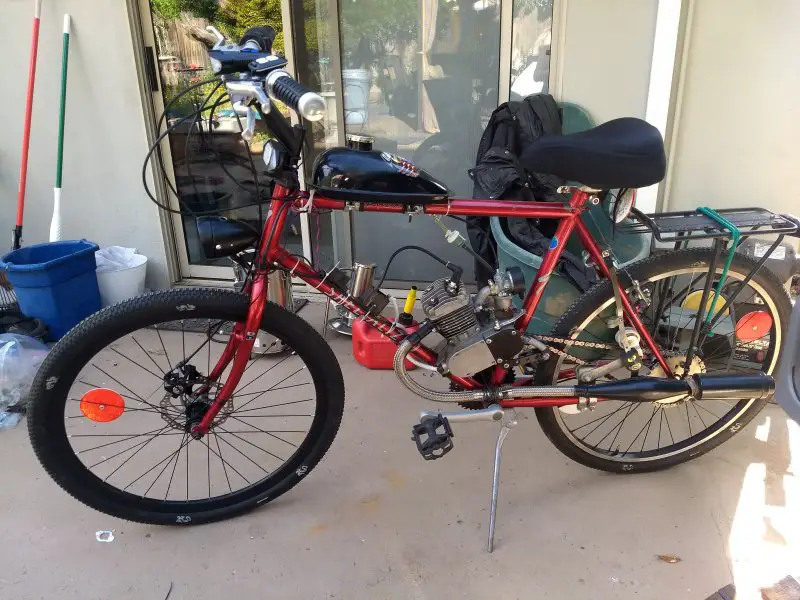

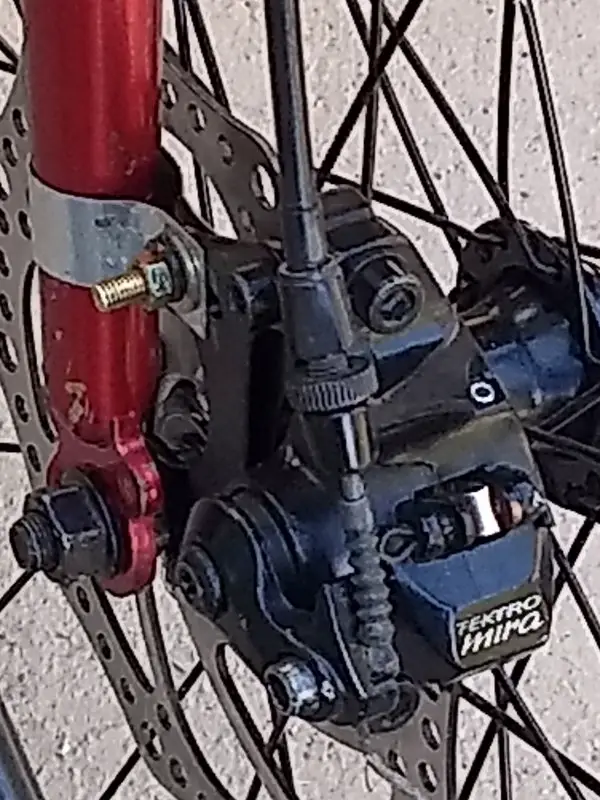

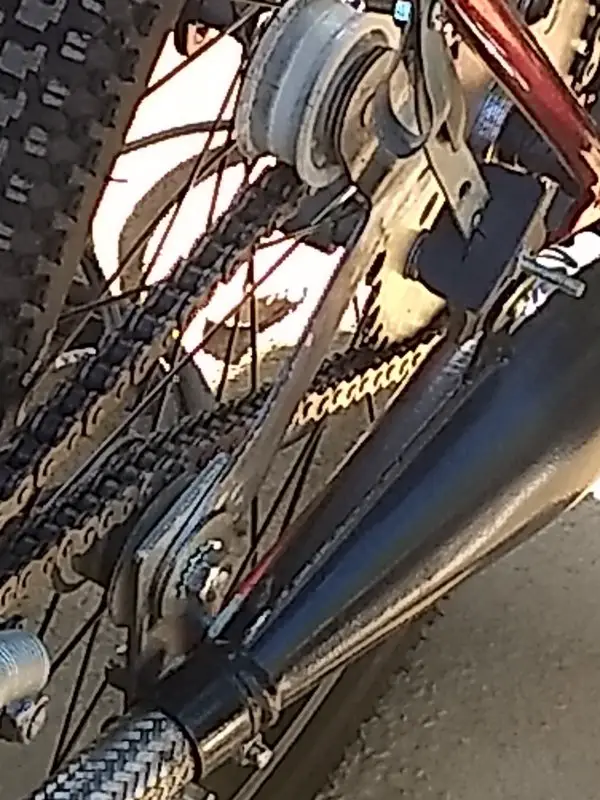

Its a hardrock with a heavy duty double wall front rim with 16 in front mira ceramic disc brake .. . Anbull 80 cc no mods. Niome flex exaust pipe, generic "high performance" carb.

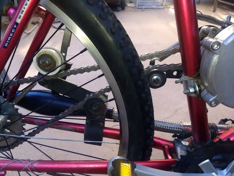

A case mounted spring arm and stock tensioner with a tensioner from a clothes dryer motor mounted over the top loop of the chain to help keep back lash in the chain down With an after market shim that goes above the front sprocket to mitigate chain jam. I run problem free.
I have a 6 volt add on magneto powering my 12 volt cree head lamp. Yeah it flickers but when I rev high it wont blow my lamp out and at 10 mph its fully lit .
It anit no work of art like yours but im happy with my first build.
The next one will be the one I will be making trick.
