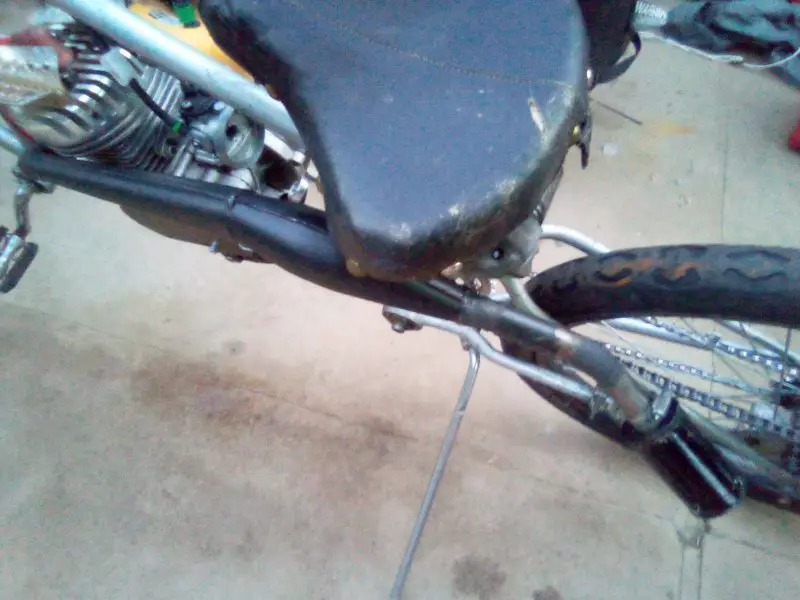

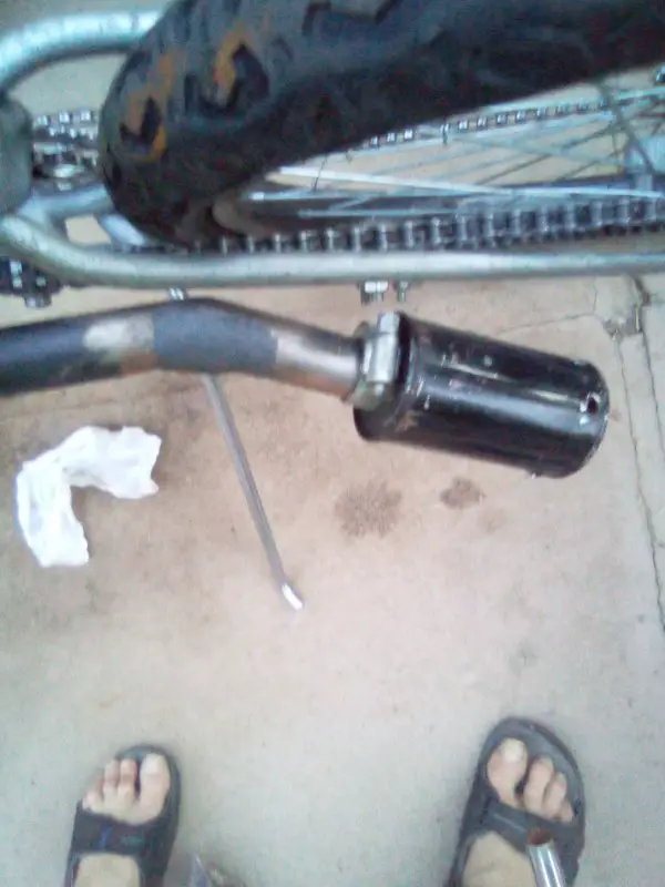

Your local dollar store has small refillable tiki torches. Bamboo holder with the refillable metal can with the wick on top. Take top off flatten the threads where the lid screws on, drill enough hole to allow the exhaust out slide it on the end of the pipe and hose clamp on. I went from 102 DB to 92. Just enough to keep my neighbors from complaining about my exhaust pipe.
Pipe is an f2 thrust I cut re angled and welded. I used metal putty to clean it up and seal any possible leaks that may be there.
