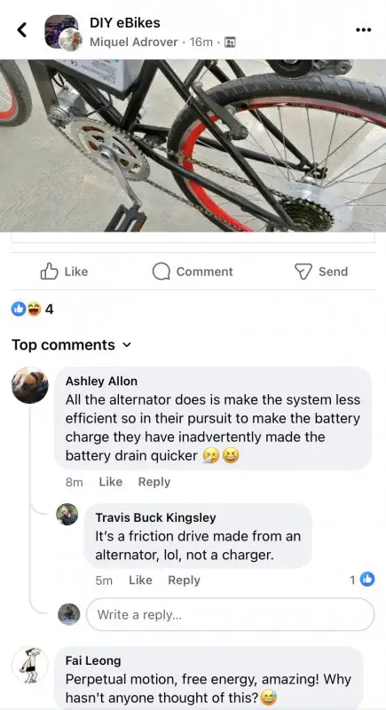

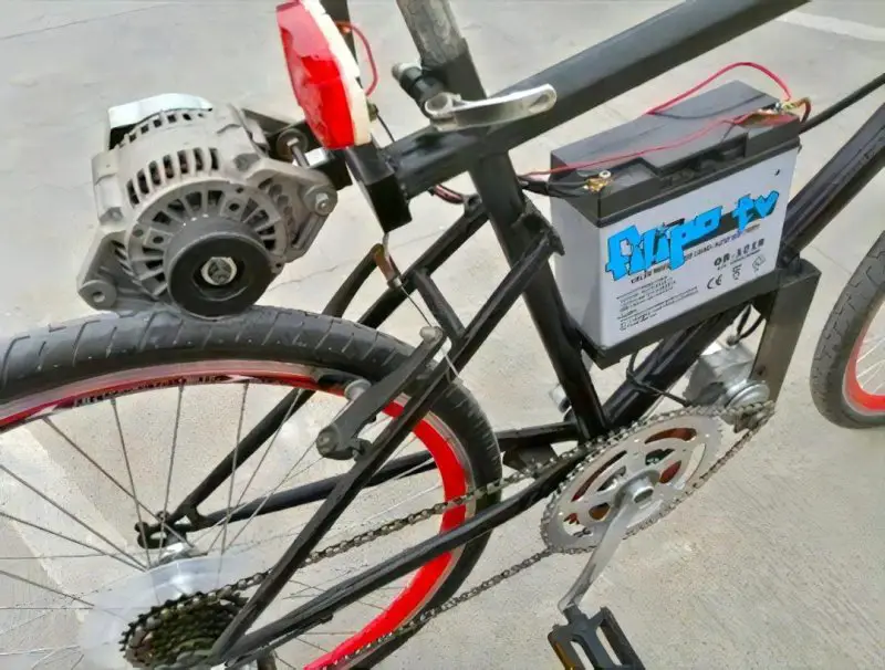

I found this picture on FB & thought it looked interesting, (& I'd share it with you).
I'm not sure if it's actually a good working design... It looks like a self charging ebike.
What do you ebike guys think? Could something like this really work??
My thoughts are that the alternator probably won't spin fast enough to keep it charged & also the battery is way too small.
What would you guys (with actual knowledge of ebikes) do to it?

It looks like a setup with two electric motors for propulsion.
There is no “self charging e-bike”. That would be perpetual motion. Like plugging a power strip back into itself.

Makes no sense at all. It’s physics 101: you spend energy to get moving and continue to move, then some of the energy is returned when you stop, ie heat in your brakes. Most e-bikes have regen braking of some sort which converts the kinetic energy of a moving bike into potential energy returned to the battery, TO SLOW DOWN instead of heating your rotors. You are talking about getting “free” energy from a moving bike however, it is not free and slows a bike down.

This bike doesn't have two motors... it has an alternator over the tire (for charging) & a drive motor under the cranks.
I understand what you're saying about no such thing as perpetual motion motors... But a alternator does put out a solid 13.5 volts while running.
Yes it does, butt it also takes a lot of power to turn a alternator, especially if the battery is dead........Curt

Electric motors are not 100% efficient, maybe 90% discharge and 30% on charge. So you will lose everything to efficiency anyway. A hybrid uses gas and regen braking to charge. You can’t use a battery and charge it at the same time- you’re either spending or charging.

It doesn’t matter the type of motors… they’re both motors. My hub motor is a larger more efficient alternator. I either spend electricity or get 5% of it back. An alternator puts out energy at the cost of slowing you down.
ie go and take one and spin it. If it wouldn’t slow you down, theoretically it should continue to spin forever.
