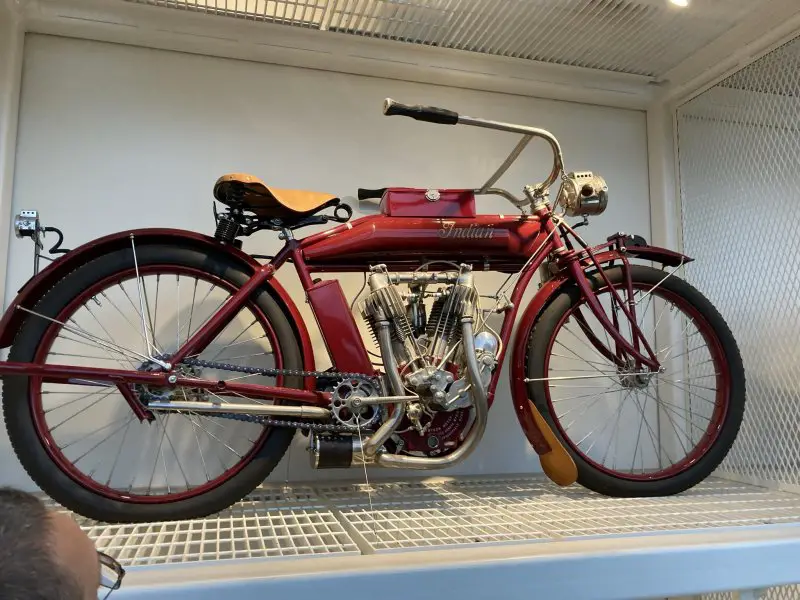

Having restored a couple of cars, I was looking for a smaller project. I like the board track racers, but had also been impressed with a dark red 1913 Indian street bike that I had seen at the Barber Museum in Birmingham, AL. I thought it would be fun to build something reminiscent of that style, as a 'tribute', since I would take some liberties here and there.

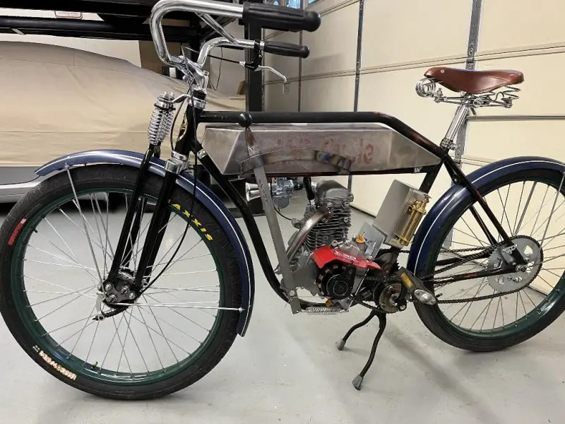

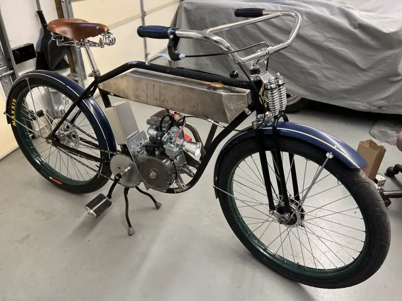

The plan was to use the frame and square-sided tank, but emulate some of the Indian details. The engine would be a that predator hemi I had sitting in the basement. The bike would be burgundy with gold Indian decals, predator engine, monarch fork, white tires, with a freewheeling gear reduction on the pedal crank shaft. I also added a 3D clutch engaged by a lever to the left of the tank, and a few 'period' details will help with the vintage look. It won't fool anyone, but that wasn't the point.
It is built, but not yet painted, and I'm working out the drive details. As people here predicted, the predator has plenty of torque to break spokes, and that is what I did.

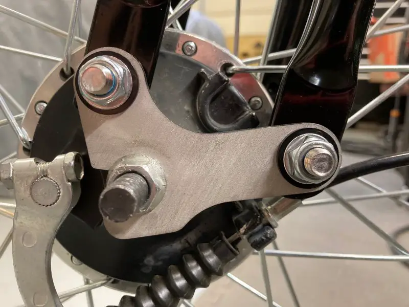

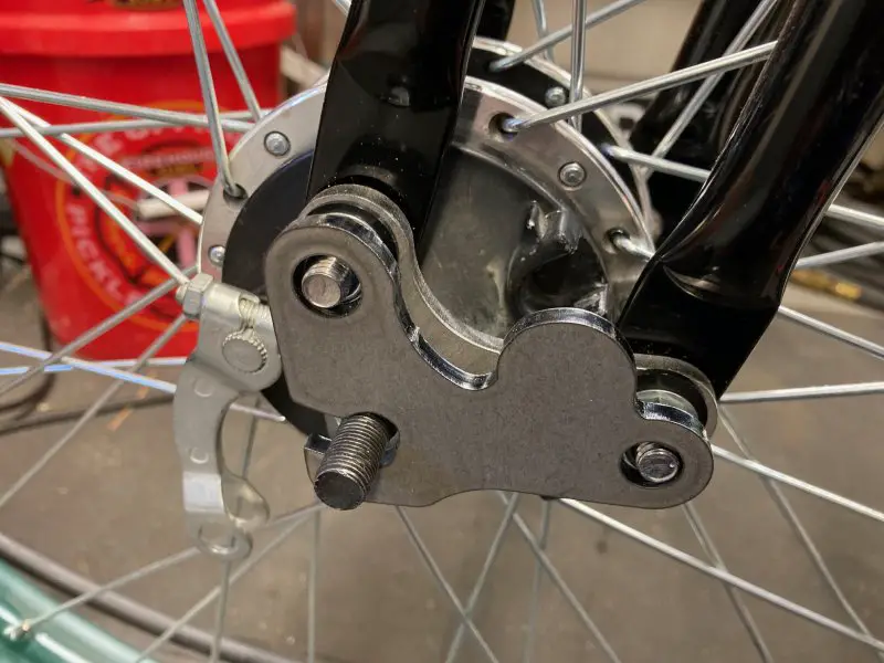

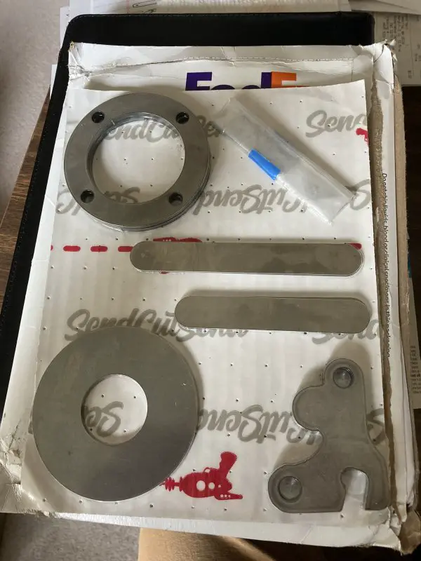

I mentioned earlier that I started with someone else's abandoned project found on ebay. One of the things that appealed to me about this bike was that it already had some stout looking wheels, spokes, and this front drum brake. Also, while it isn't anything like the Indian's leaf spring, I knew I wanted a monarch fork for a vintage look.

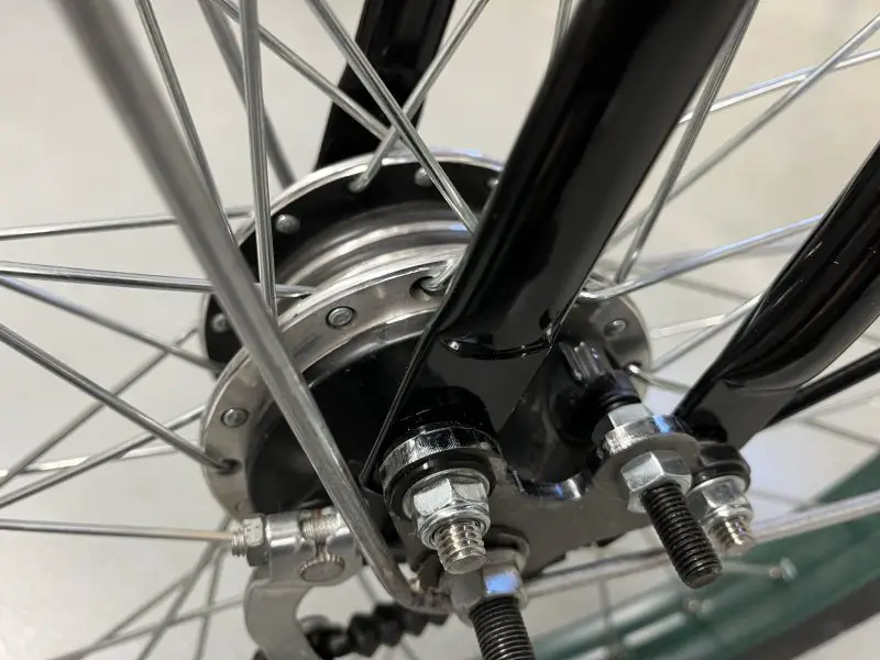

Rather than having a brake lever to attach to the frame, this particular drum brake had a u-shaped slot to prevent the center hub from rotating. It seemed ideal to add a pin to the monarch's lever. I drew up a replica of the monarch wheel mount with an added bump to locate a pin, and ordered it cut with a few other metal parts. An allen head bolt provided the pin, and the wheel can be removed and installed like a normal bike, with only the usual axle nuts.

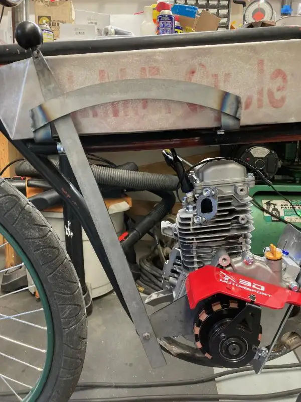

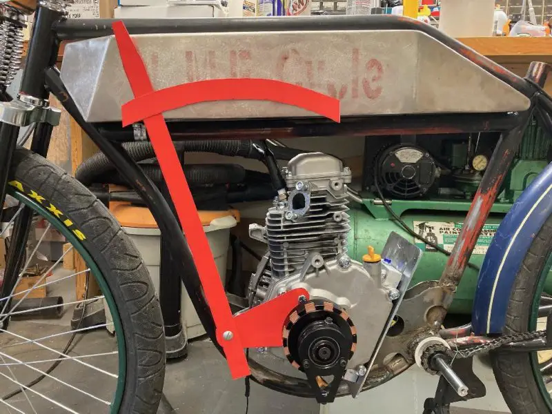

Looking at the build you acquired you will need to add a front mount and upper mount to the engine. The 200c engine has a lot of torque and will around on just a rear mount. Should be triangulated into the frame.
You mentioned a 3D manual clutch, too. They are pretty aggressive in engagement so the engine mounts become even more critical.
Sorry, not trying to pick apart your build but since you are in the early stages its easier to improve now. Lots of collective knowledge on this forum. We have all been through it before and know what works and what doesn't.

I will add a forward engine mount, if I remember correctly, there is a boss on the engine that might work for that. As for the aggressive engagement, that was *exactly* what I found when I attempted a short driveway-test, which resulted in the bent and broken spokes. I was trying for a slow/smooth engagement and it didn't work that way. I had made my left-tank-side clutch lever with a long-ish throw thinking the long throw would help with smooth engagement. I'm not sure what I will do to address that, but the abrupt engagement is why I emailed you about your hub adapter.

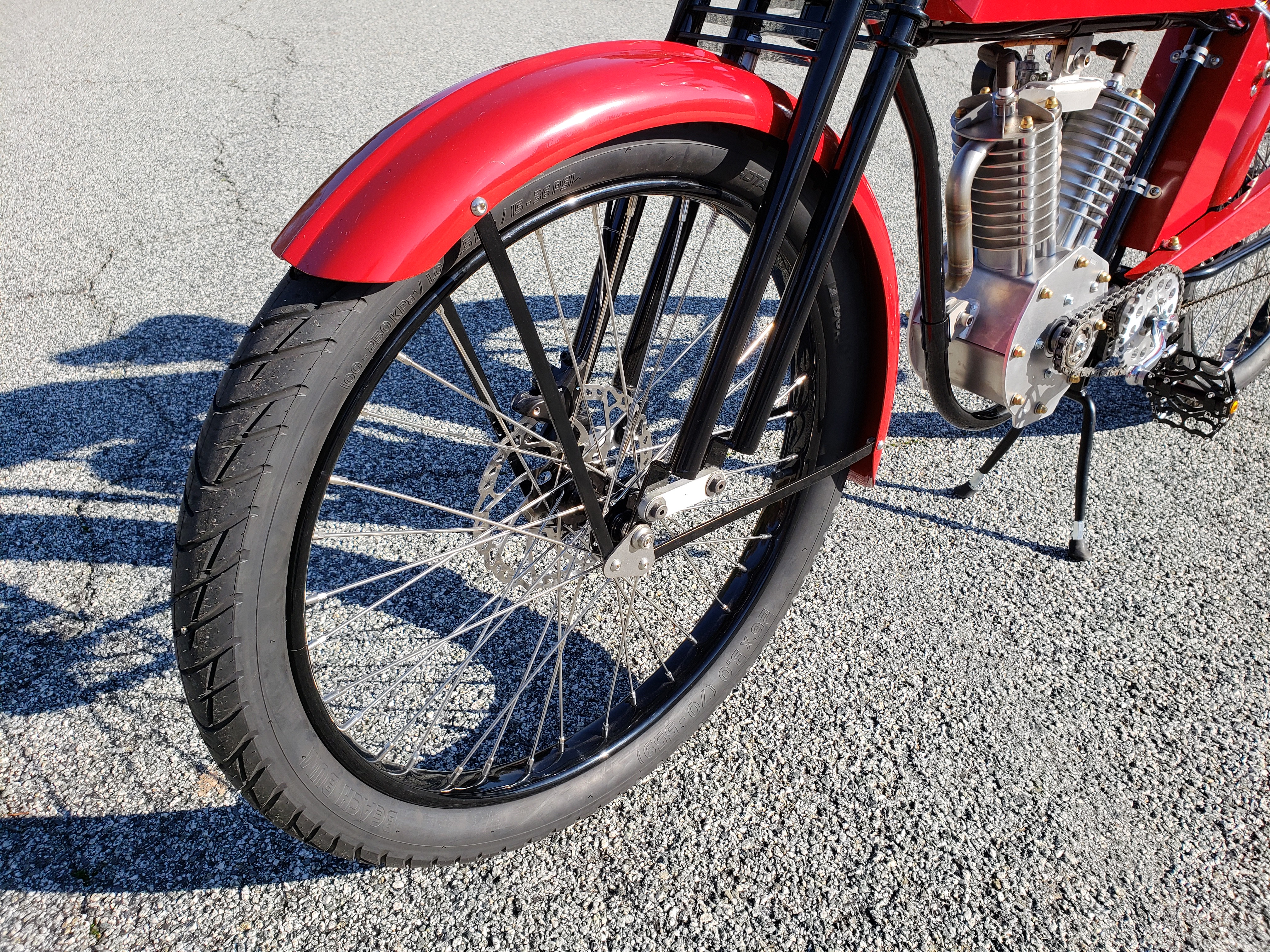

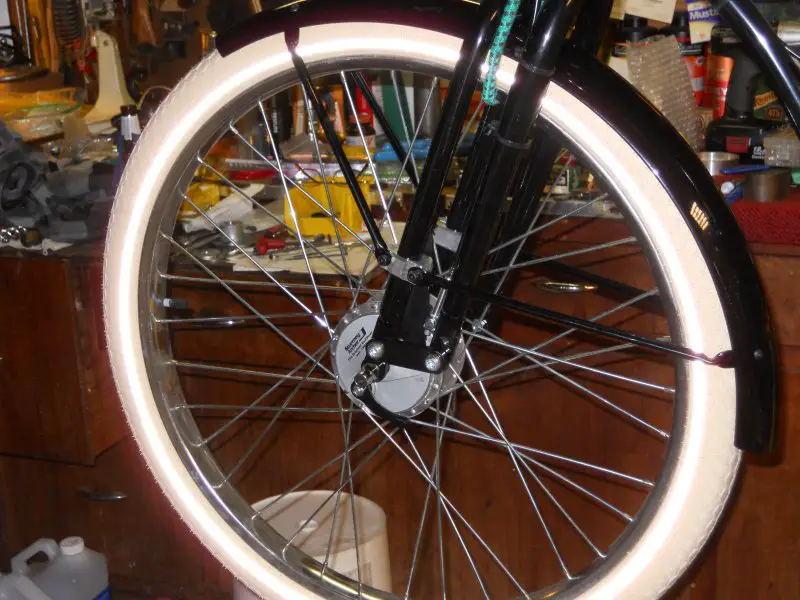

My Sunlite fork with Wald fender braces mounted to the sprung front fork (photo).
The trailing fork is arched high over the fender. Monark is just the opposite.

This is how I have been doing front fenders. Simple triangle shaped tab that bolts to front wheel. I also like to run the fender with the wheel on the front fork. This way you can mount it low and clean to the tire and not have to consider travel changes and fender clearance.
