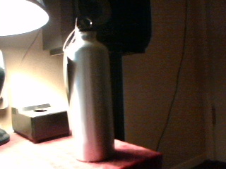

I bought a 25oz aluminum water bottle with screw on cap for $1 at a dollar store,even at other stores they are only around $5-10 and come in larger sizes, drill a hole at bottem of bottle and add a petcock and you have a tank,put that in a bottle holder. Also needs a vent hole on top of bottle.
I have not made a tank out of the bottle yet,but in the third pic is of someone else who did.
