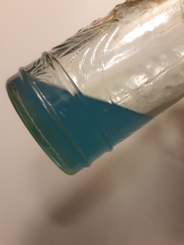

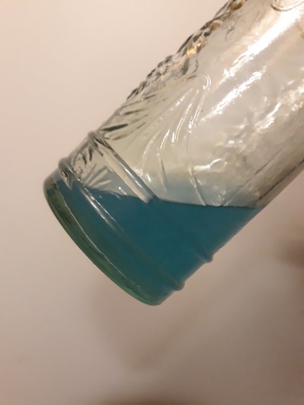

Will be running Amsoil saber, IF it mixes. I haven't actually started the process yet. I do have 2 gallons of e-85 on hand. I will first put a small amount of ethanol in an empty bottle or something and make sure the oil will mix with it, First. So that's going to take a minute. By the end of the day, it should be running on alcohol. If the Amsoil doesn't mix with it, I will have to try another ester based oil. Apparently ester bases will mix well, synthetics. I'm currently running a 58 jet, which is surprisingly rich on this engine, I think I'll end up running a 72 or so with ethanol. About a 25% increase from current, being slightly rich at the 58, should put me spot on with a 72 or 74 with ethanol.
I am determined to make this happen. Yes I'm aware of all the "dangers" of ethanol. I think some of those "dangers" were started by oil companies to dog on ethanol.
The first test came out good. Amsoil Saber 2 stroke DOES indeed mix well with e85. That's all I needed to be sure of. I feel much more comfortable with it now. It did have a little itty bit of trouble mixing at first. I think it was because it was cold this morning. Once given a real chance, the oil blended in perfectly. I actually put more oil in than a 100:1 ratio, I just wanted to make sure the oil was indeed mixable in various parts.
