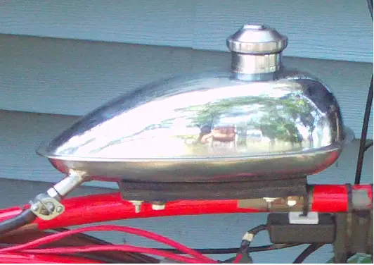

Rubber Tank Mount
waistofhumanspace
[/IMG]
I have a bunch of factory junk tanks with the mounting bolts cracked at the factory welds, and a few with cracks where I rewelded them then tried to solid and pad mount them, the mount that I pictured does not let ANY metal touch the frame of the bike,this eliminates most of the harmfull vibrations, I understand that there are people that do not have access to welders & that there are frames made of alloys that when welded crack, the Idea I posted is just one of my ideas, It worked for me and is still working, I ride alot.
Im just sick of all those leaking tanks
