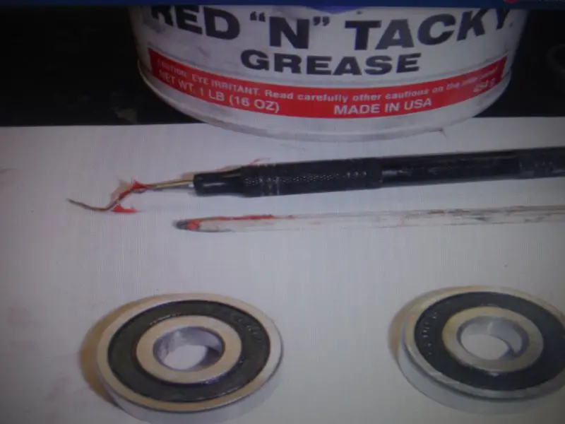

I bought sealed bearings from VXB bearing in LA Ca. and to my surprise the bearings hardly had any grease in them - probably about a bb size amount of grease
I put the bearings in a rear wheel hub and after a few rides I could hear the rear wheel squeaking,

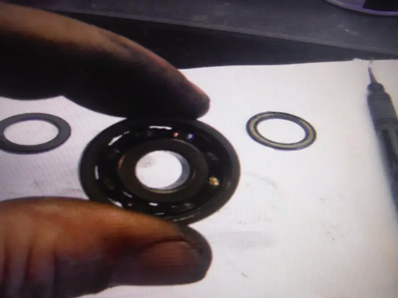

I inspected the bearings, removing the rubber seal to find what looked like no grease in the bearing,

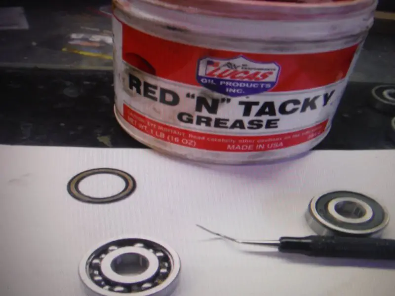

I popped the rubber seal off another new bearing and it only had a bb size of grease in it
Obviously not enough grease ,

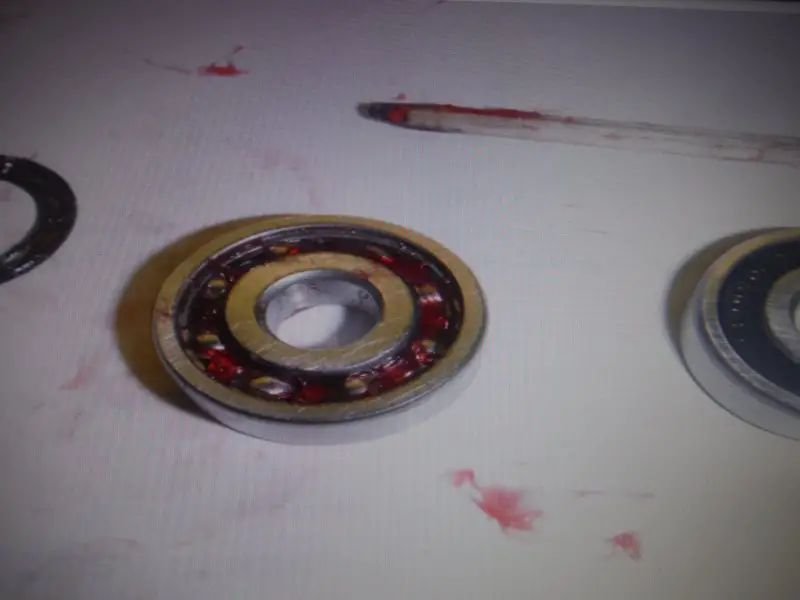

I added grease to all the bearings I bought and now I'm going to make it a common practice to check/add grease to all sealed bearings I buy no matter who the manufacturer is
Popped the seals back on and now i know the new bearings have enough grease
