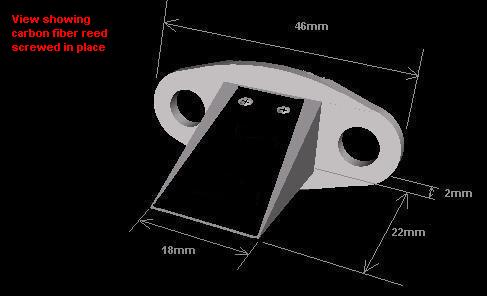

vvomit, like the guys said you may need a couple of holes in your skirt. Check out what Puch is doing:
Here's link to their site where I found that pic:
puch 70cc reed valve kit especiale check out their other kits for a better idea, along with Jaguar's awesome tips.
Even a few drilled holes in the skirt should help. It's good that your plug is not charcoal, heh heh.
gl, keep us posted :).
