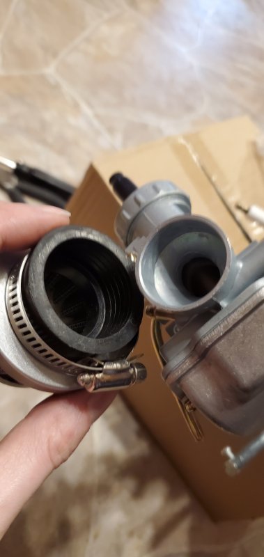

Hey guys, new around here... built a skyhawk on my Dad's bike before but decided to try a Raw Racer III this time and I'm wondering if I'm just daft or if they gave me an air filter that won't fit the carb...
I'll probably just try and find some hose that makes up the difference for the second... Other than that, excited to get a few more parts and throw together my chopper :D

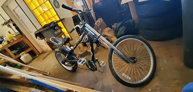

The original bike:

I built a raw racer 3 kit with the same carb and had no problem getting the air filter to fit, or so I thought. I had to tighten the clamp down so much it eventually chewed through the hose. The engine is solid though. You will definitely have rejet the carb for it

Yeah, did manage to get it to bite on with lots of turns and a steady hand, we'll see how it holds... might find some old hose to use as a spacer...
Thanks for the heads up about the jets, had thought of it but kinda underestimated my costs and will have to wait for certain things. Any advice in that department would be appreciated!

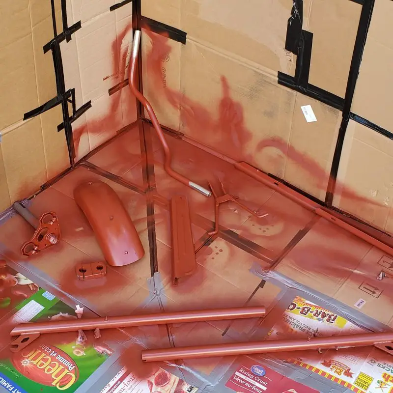

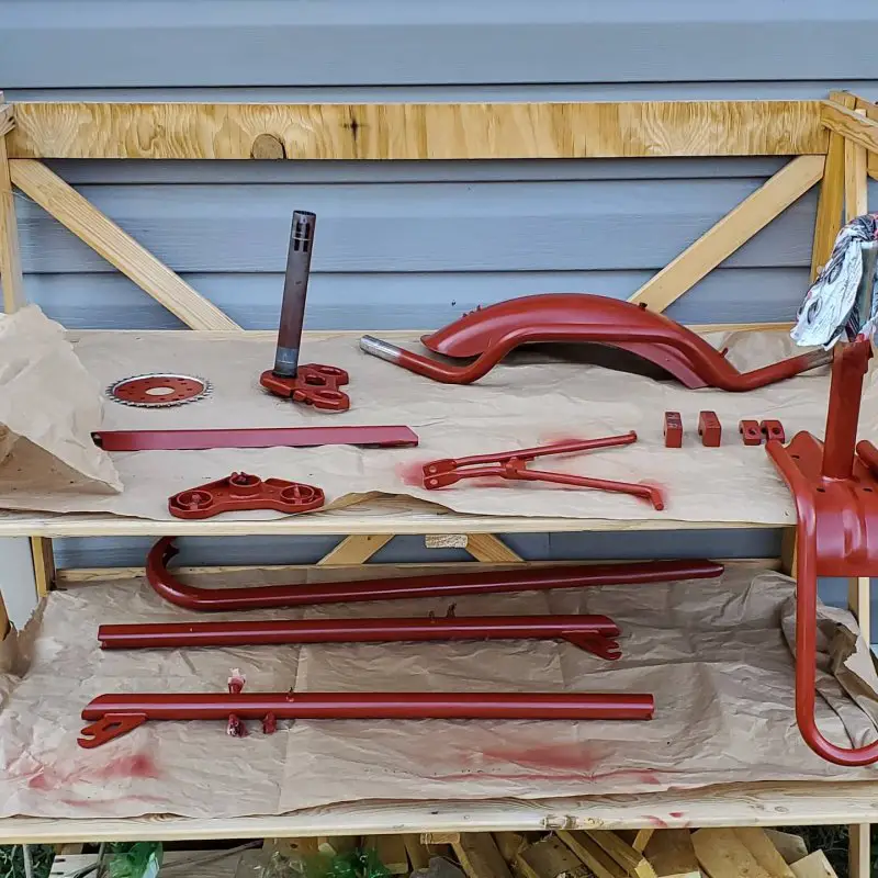

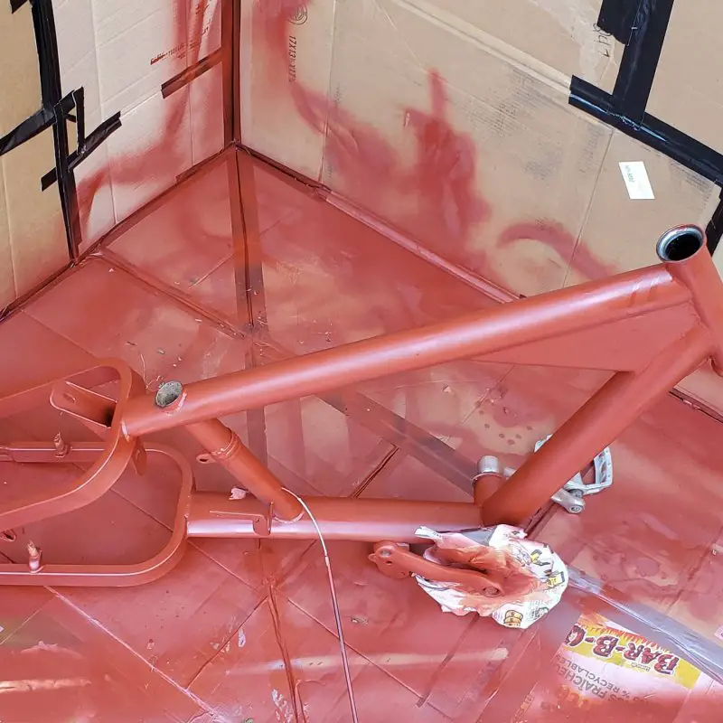

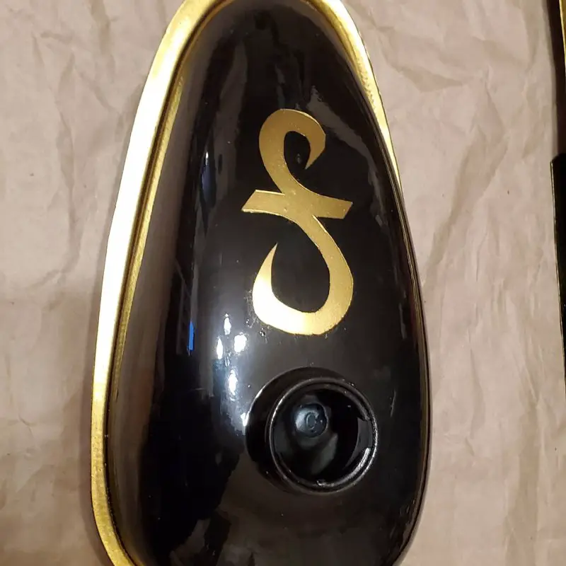

Here's some parts stripped down for rust primer:

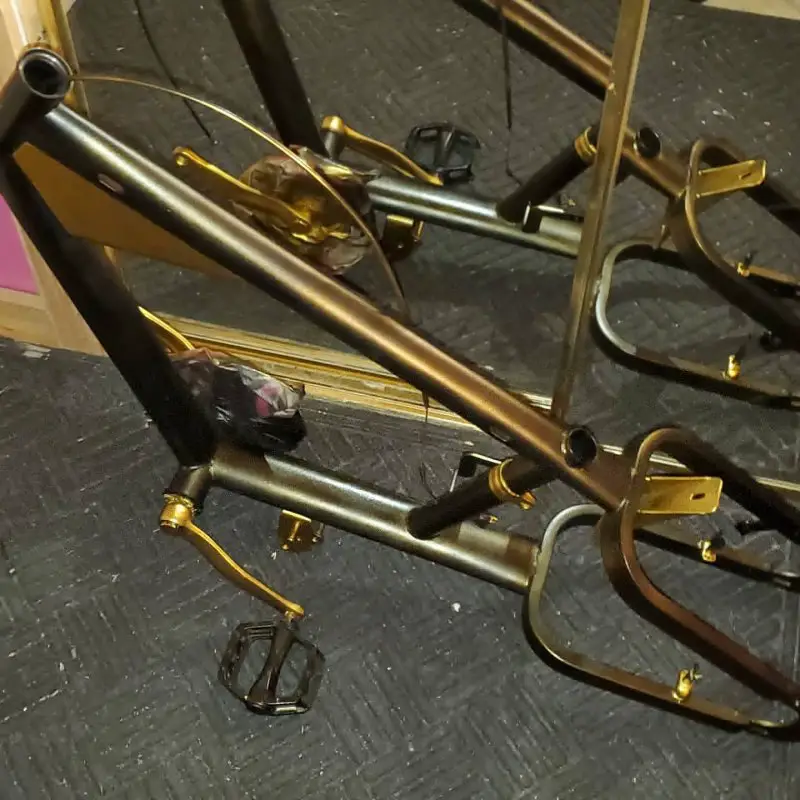

And, some newer pics... getting there...
