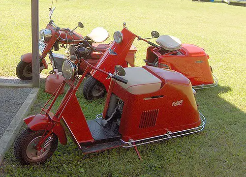

Well, here's what I say: You could cure the brake chatter, uncertain cornering, accelerated headset wear, speed wobble, frame cracking, and all other ill effects of excessive front end flex just by using normal length forks that are supported lower over the wheel.
Cushman did not use long unsupported legs on their forks! That's not an arbitrary design decision on their part; it's the safe and correct way to do it.
