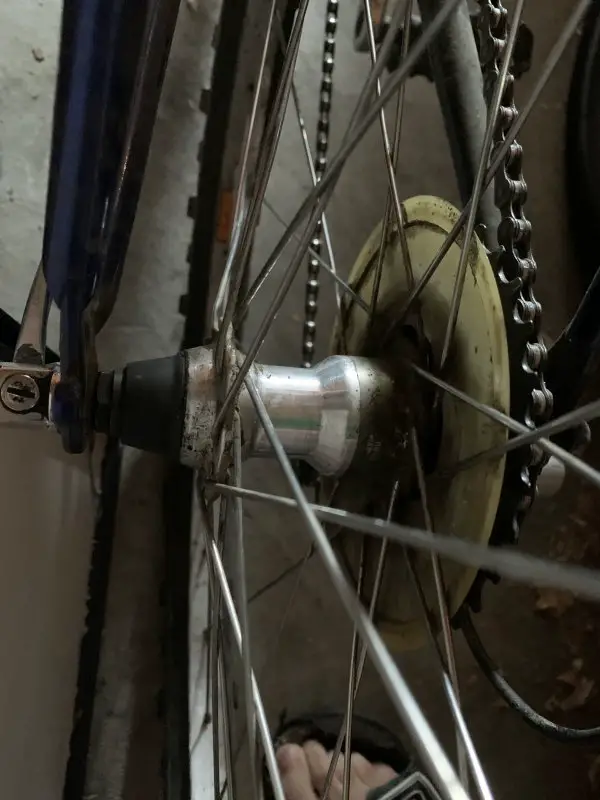

Yeah I noticed lol. Been having a **** of a time getting my sprocket centered. The ninth bolt always hits a spoke.
if your using the rag joint what i do is wrap the hub or the dust cover with electrical tape until the sprocket center fits tight..... kelly
Yeah I want to get the cnc sprocket but I have a tapered hub don’t know if it would fit.
