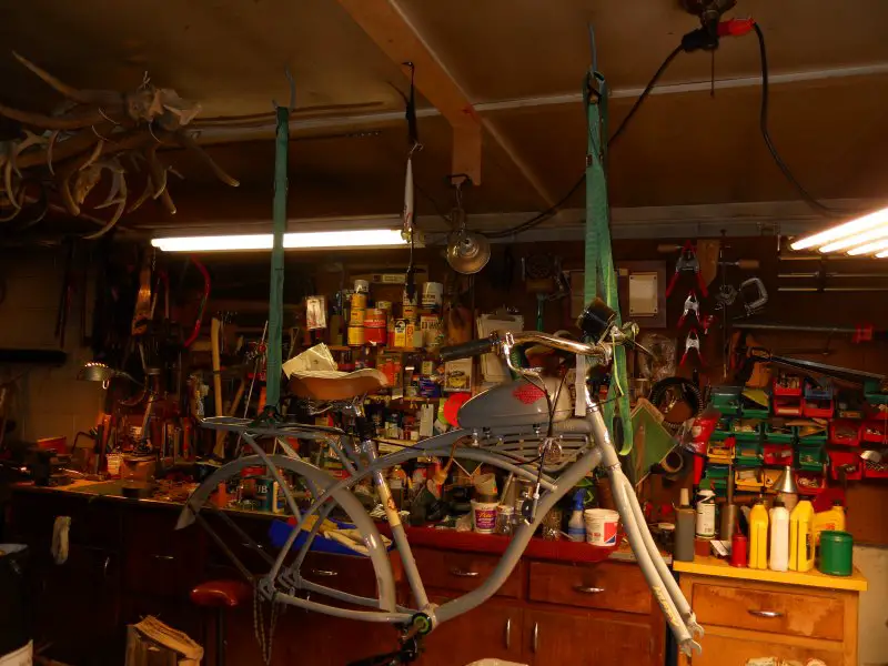

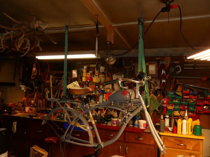

Not exactly the same except in application. I use motorcycle hold down straps with hard points screwed into ceiling joists. Takes two, one on the head and one on the seat post tube. Attach the cam strap to the hard point and bike member. Lift one end and draw up the slack. Repeat. I can post a photo Thursday.

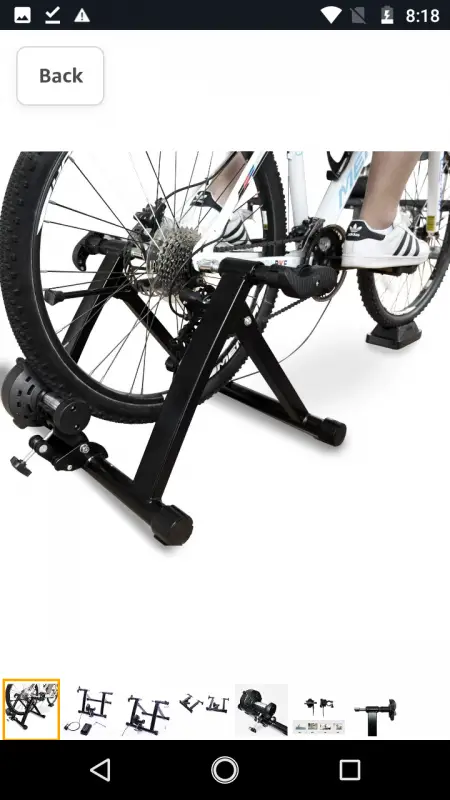

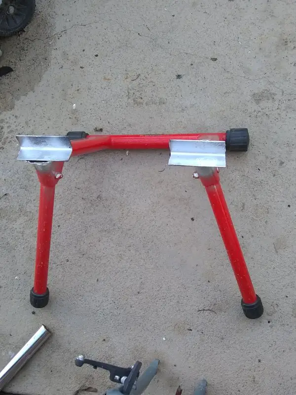

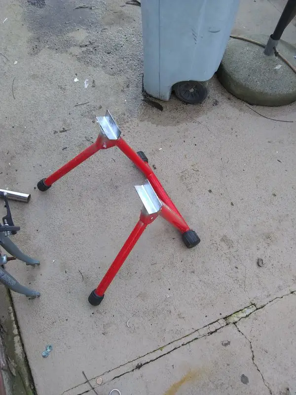

If you're talking about one of those tripod stand up fold-out clamps for bikes they are not meant for motorized bicycles and you might find it to be a little bit cumbersome.
The best way to get a bicycle to stand is to get one of the ones like the stationary bike A-frame thing that the back axle rods rest in that way you can start your motor with it still standing on the stand and run it under load.
You can find them on Craigslist for like 20 bucks.

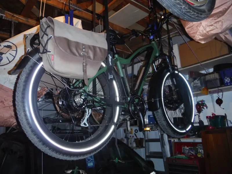

Ratchet straps from the rafters in the garage work to lift a bike
Or you can go buy a bike hoist from Harbor Freight for under $20
I use one to hang my E bike in the garage

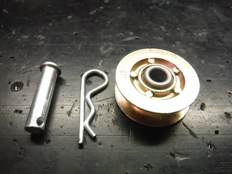

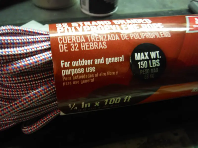

Of course I beefed it up with stronger pulley wheels and rope to hold more weight
HF bike hoist is rated for 50 lbs and it's got plastic pulley wheels and a cheep rope
and the hanging hooks are riveted on
I changed the pulley wheels to metal and use a stronger rope rated for 150 lbs
I also replaced the rivets with nut's and bolts
My E bike weighs 70 lbs without the battery
But the hoist will suspend your motorbike as is long enough to get it on your bike stand
Pic of my bike hoist
THe 2 extra straps you see in the pic, 1 in the front and 1 in the rear is just for extra safety and piece of mind, This E bike is hanging over a car
Yeah, I got 10' high rafters in the garage

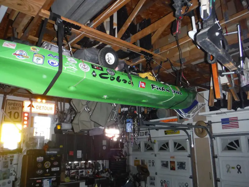

I also use a HF bike hoist to lift a 60 lb kayak up to the rafters
Yeah I put a couple extra straps on the kayak too, It's also hanging over a car
Loaded with all that gear it even weighs more

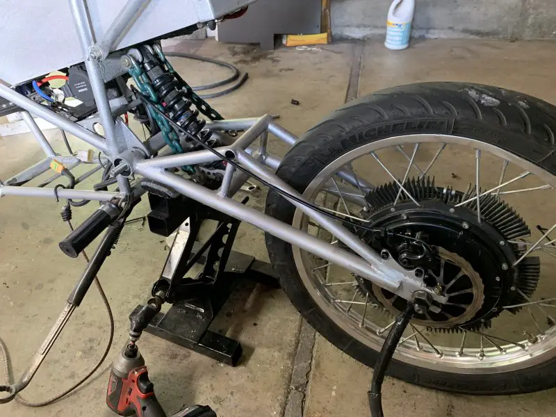

I modded a scissor jack to work as a bike stand to lift at the swingarm or belly which are about an inch different widths. Welded a socket and UJoint to it so I could ramp it up and down fast.
