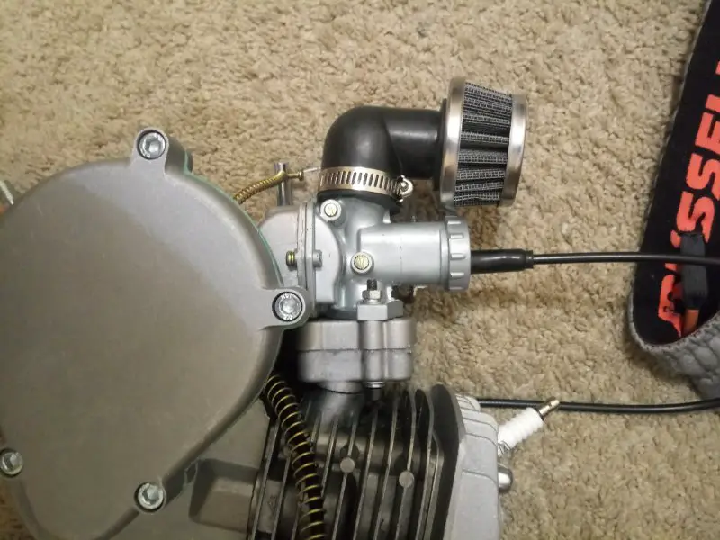

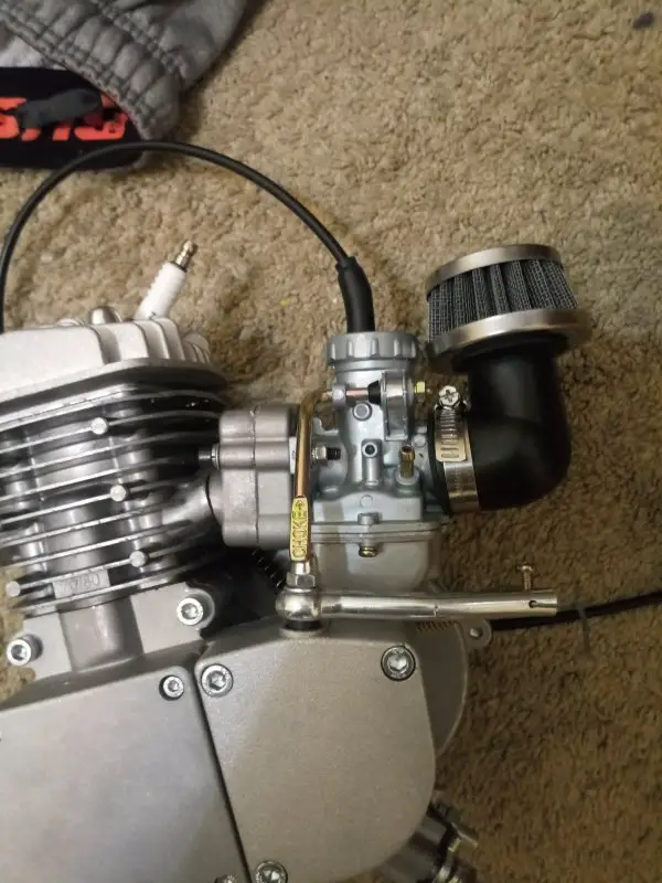

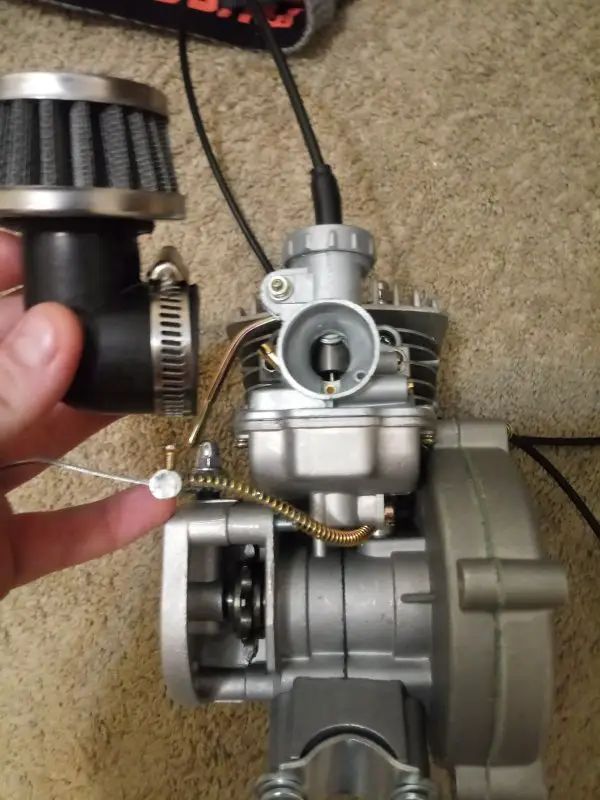

So my 2 stroke 80cc motor for my bicycle came with a PZ20 carburetor if I'm not mistaking? I need to know if this is a good carburetor that it came with it should I get something else?? All help is needed on this situation as this is my first build. Also the nipple at the bottom of the carburetor a hose goes on it where does the other end of the hose connect to???

PZ-20 is a good carb your carb is a China knockoff of a Japanese Kei Hin
The nipple on the bottom of the float bowl with a hose is a drain. There is a screw on the side right above the nipple.
So if ya want to make sure your carb is getting fuel you can open the drain and check.
Or if ya want to take your carb off, just drain off the gas before ya do
