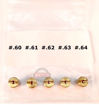

I believe the jets are 5mm jets, the stock jet for most of these carbs is #70 even if it's not marked. Usually, a jet between #60-#70 will be the correct one.

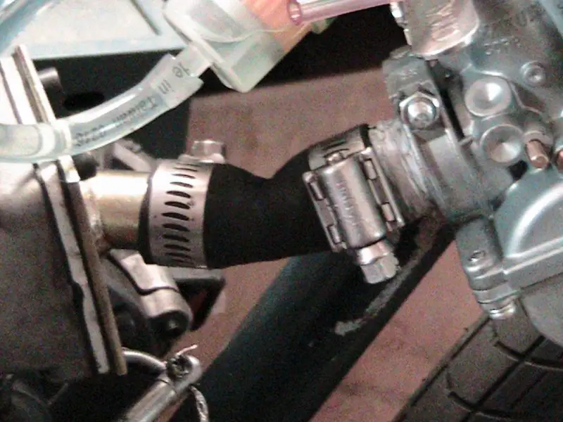

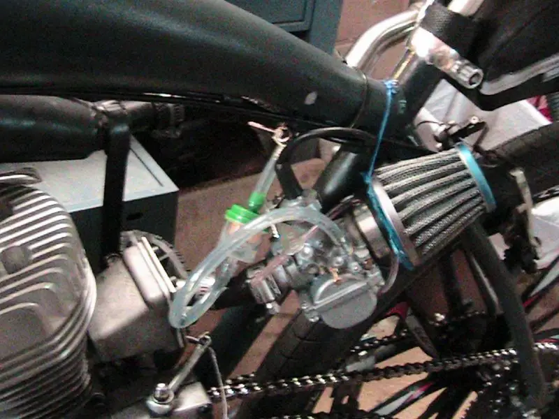

I have the same set up on one of my bikes, I put the Makuni 18mm on and used a vacuum hose and claps to connect it. Here are pics:
It ran awesome, then I saw that part and I got one, hooked it up and the bike won't start. I haven't spent the time needed to figure out what is wrong yet, it might just be leaking or something. Then I ran across this (see link) and ordered one, it arrived but I haven't put it on yet. I'm sure I can get it going without the vacuum hose, just got to spend some time on it.
Also, if you get it make sure you get the 23mm one, which looks like they are out of stock on.
