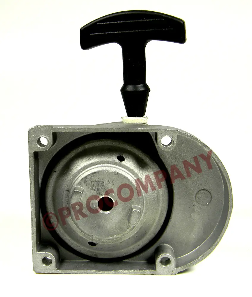

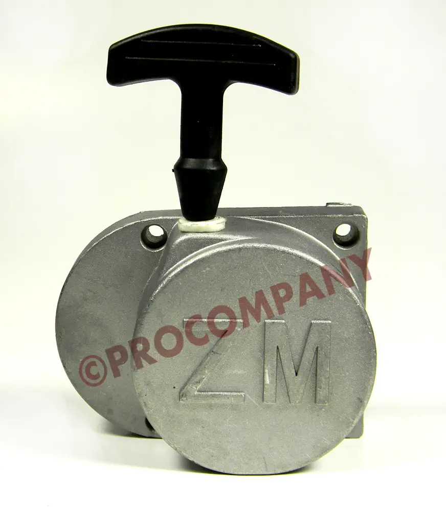

Well this is it BUT it does not show the cable. The cable is stranded wire just
like a throttle cable though. When you pull up this amazon site Bikeberry has on
listed at to cheaper & with prime. It looks the same, but maybe the plastic one
Map was talking about. But the $26 I bought came from China, & if its the same,
I recommend it. http://www.amazon.com/Alloy-Start-Engine-Motorized-PU11/dp/B007VEYKB8 Hope I helped, Fly
