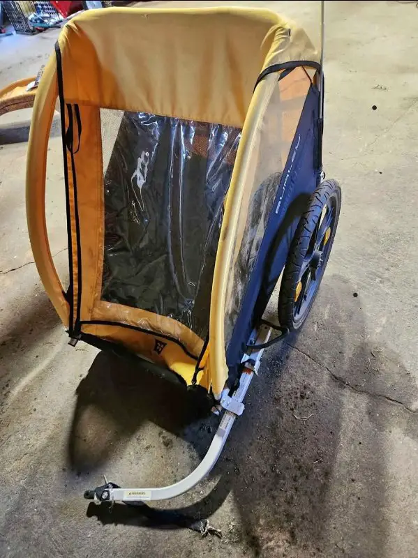

In a nutshell: is pulling bicycle trailer which was designed to haul kids 15 mph behind a bicycle but instead, hauling arse at 30 to 35 mph a good idea?
No kids being hauled are involved, merely camping gear, groceries and whatnot.
FB seller tells me he's hauled bicycle trailer at 15 mph, which is about what you would expect, but going twice as fast? HHHhhhuuummm...idk?
Repost from trip planned:
I've been checking out pull behind bicycle trailer as means hauling camping gear on trip.
Found one reasonably priced on Facebook Marketplace, seeming usable for purpose.
Seller describes bicycle trailer folding down for easy storage, which would be helpful in limited space apartment.

Couple things I'm concerned about bicycle trailer found on facebook: how compactly folds down for storage (there's scant space in apartment), & is trailer sturdy enough to survive 20+ hours on motorized biking trip, while carrying camping load-out?

Facebook Marketplace trailer being investigated was made to haul kids, so dubious this one can carry 200 lbs :). Those would be some pretty heavy kids! lol.

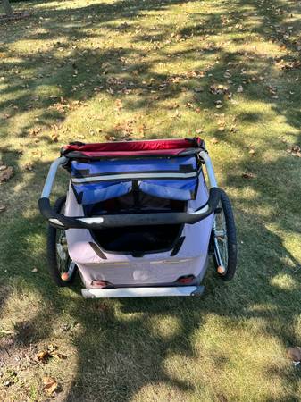

Purchased 30 plus year old Burgey bicycle trailer needing repairs, and fixed for towing behind motorized bicycle.
Appreciate trailer folding flat for easy storage in closet.

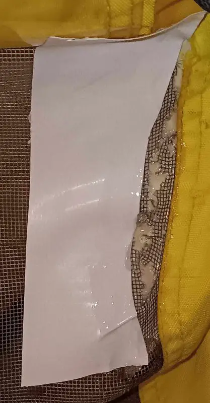

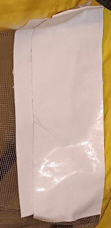

Tears in fiberglass screen were repaired using clear silicone to merge torn screen sections back together, making for clean repair & good appearance. Duct tape was used in masking damaged screen section, soap being used on duct tape as mold release, with clear silicon applied over tear in screen. Repair finished with a final piece of duct tape over top of silicon repair, making for flat surface & neat appearance.
Hard to describe, but easy seeing from pictures, way in which screen tear repair progressed, repair having acceptable end results.

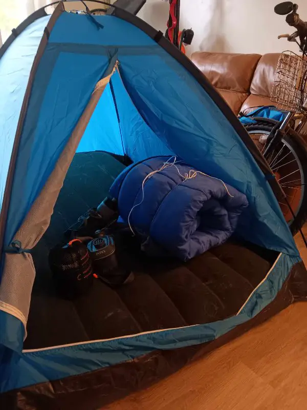

Wanting to make sure camping gear was in good condition/ready for planned trip, tent-air mattress-cooking gear-sleeping bag & etc was set up and checked out.
When bug man entered apartment to spray, he had a very strange look on his face, seeing campground set up in my living room lol :) .
Camping gear easily fits into bicycle trailer for planned motorized bicycle camping trip, having plenty of room for additional supplies, etc.

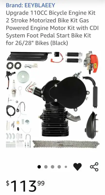

Definitely dealing with layers of problems, including loss of compression. Biggest "deal kill" is finding out why no spark. Using process of elimination, replaced magneto, CDI, & spark plug, still producing no spark. Suspect bad connection, because that's entire ignition system replaced?
Further troubleshooting ahoy. Maybe best fix replace entire engine kit for $113? idk that would definitely leave me with lots of spares in case of breakdown.
Likely motor presently installed, is going to have to be removed/torn down, in determining why there was compression loss? It would be quicker just to replace entire engine and keep for spares? idk

Camping gear checks out okay.
No leaks in air mattress, battery powered inflator works okay.
Tent barely fits air mattress. Were I to be any taller, tent/mattress would be too small; it's barely adequate, but OK.
