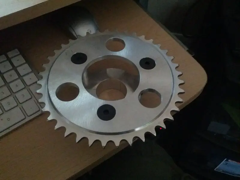

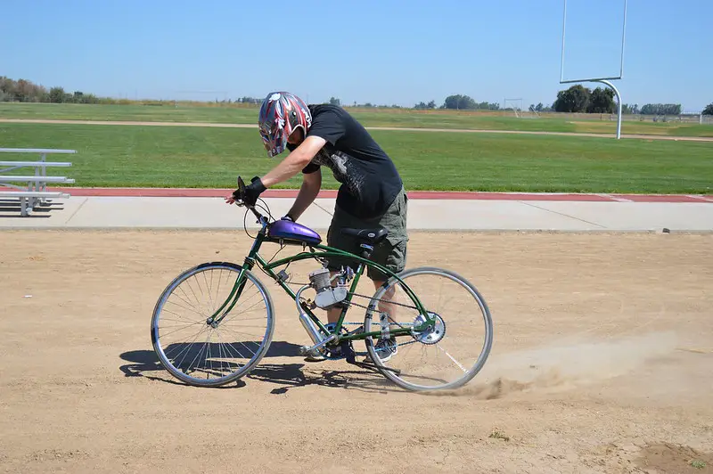

Got my sportsman flyer adapter in yesterday. Got it all mounted up on the new wheel and got it all back together on the bike. Had a great ride, the bike felt more stable and I could feel that the bike had more power since the power is going directly to the wheel instead of the spokes. Had a good time putting around until the bicycle chain broke. I believe it was original to the bike. Good thing was the bike was running when the chain snapped so I was still able to ride home just didn't have a brake. So now I need to take care of that lol, if it isn't one thing it's another.

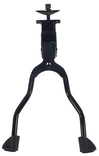

Also ordered a new kick stand since the one on the bike doesn't work that well plus with a dual stand like this it'll be easier to work on the rear end and possibly start up? Not sure.

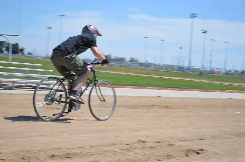

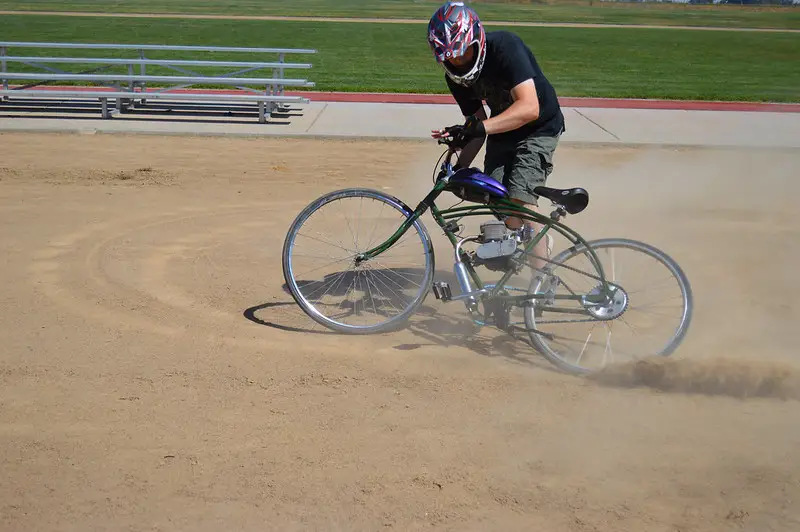

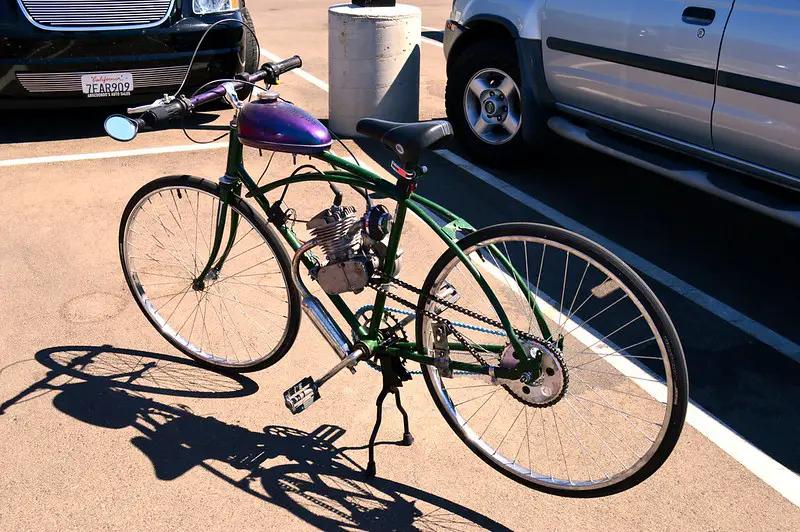

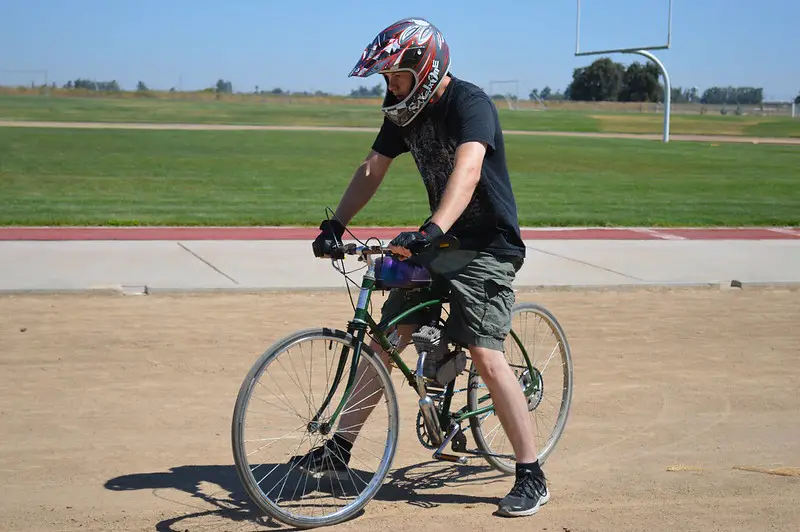

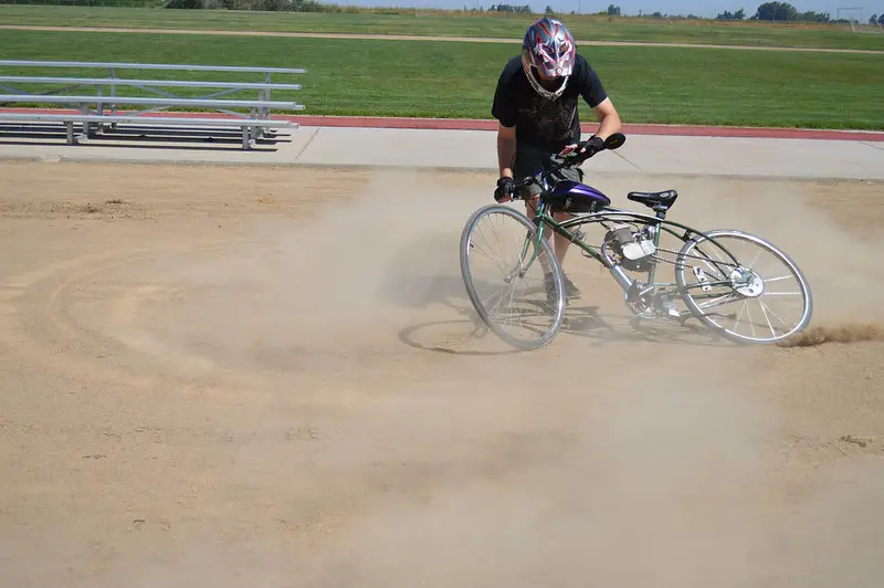

My brother came over and took some pics of the bike. This sprocket adapter feels really great. I feel like the power is more direct to the wheel. Anyways enjoy the pics!

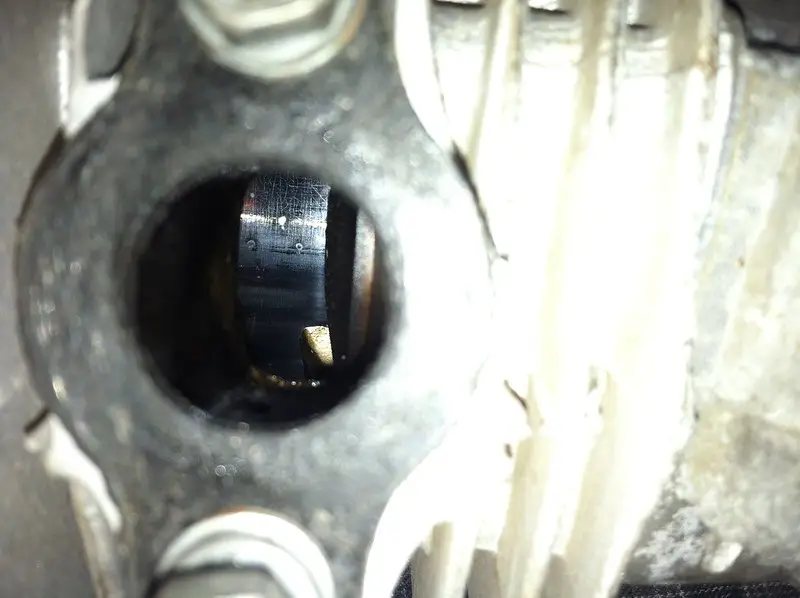

Engine Tear Down:

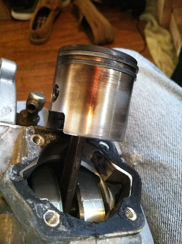

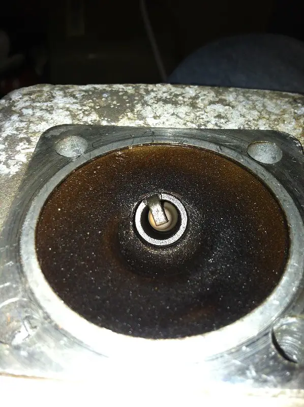

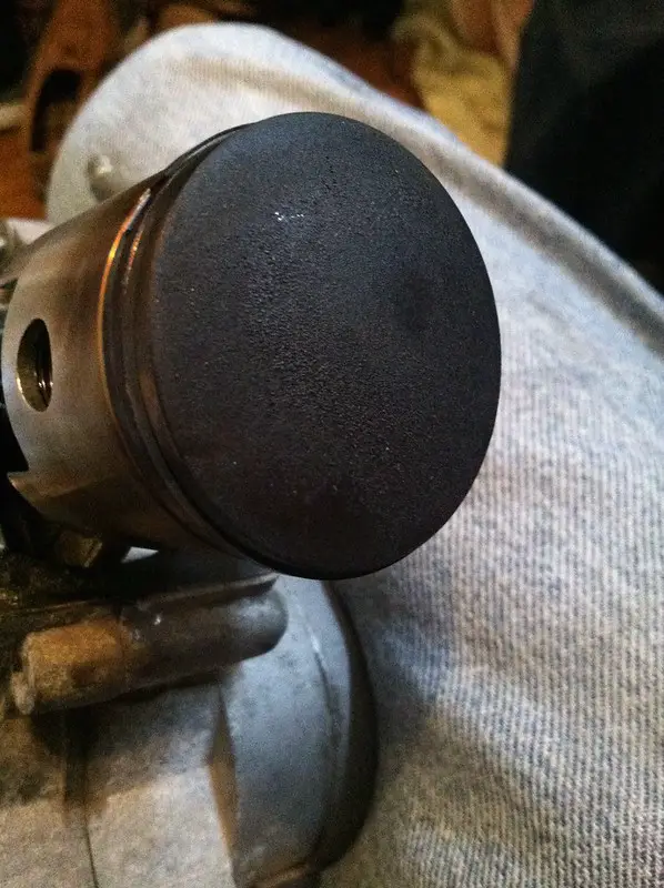

Here are some of the pics of the tear down that I've done so far. A question for those out there, how is the condition of my top end? Since most of these pics are of the top end, I'm curious to know if it will be usable still on a different bottom end. So, on to the pics.
Head:
Piston:

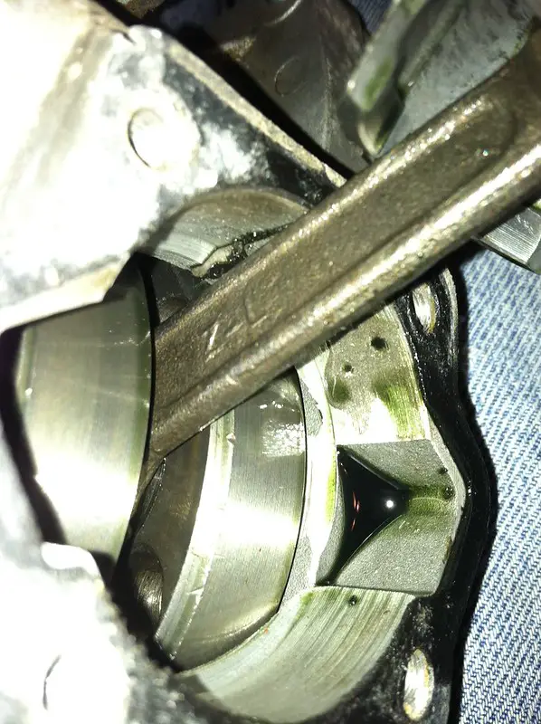

Tear Down Continued...
Connecting Rod:

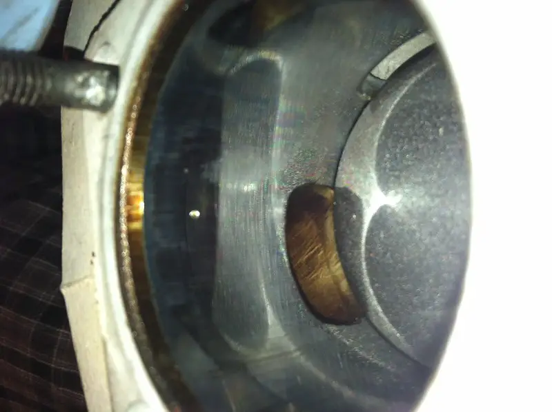

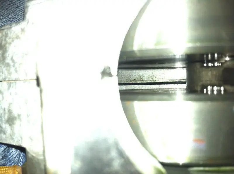

Cylinder Jug:
This is what I have done so far.

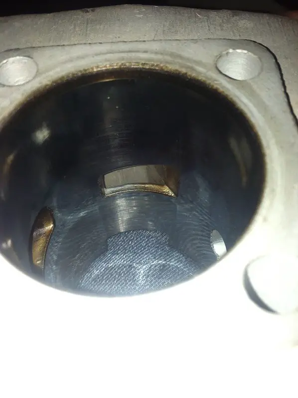

By the marking on the connecting rod and the wrist pin location on the piston, according to Fred's video on engine geometry's this is a PK80 motor. Fred also mentions that DAX's lowers are Pk80's so I'm going to be contacting Dax to confirm this, and possibly make a purchase. At first look at Dax's website, the lower he has pictured looks to have the same connecting rod I have.
As far as the condition on the cylinder, it feels fine (smooth all the around) to the touch other than the small chip pictured above. I am a little concerned about the last picture, do most cylinders look like that?
As far as the lower looks, the bottom of the case is spotless, and I see no metal shavings anywhere. This motor ran fine before I opened it up, so I'm glad I didn't find anything major.

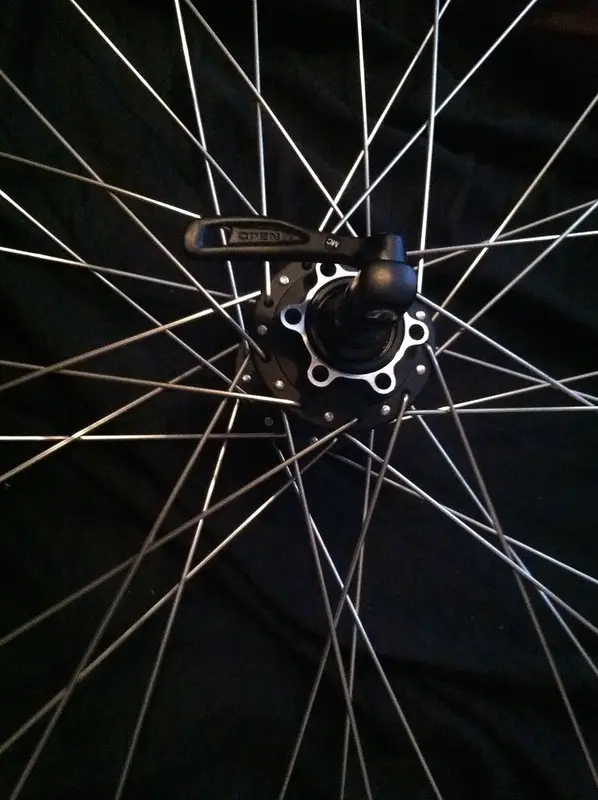

Alright so I've been working on getting the front brake conversion together. So far I have the disk brake hub and rim. I took them down to the bike shop today to get it laced up. Really wish I knew how to figure out spoke length and how to lace. This alone is pretty pricey.
A buck a spoke and $60 for labor, ouch. But it's the price you pay for safety.
The Hub I got is a Shimano.
So once I get the rim back I need to figure out how to make it fit the front fork. Here is a picture of the clearance issue I'm having.
Not sure if I can make the drop outs larger to make it fit or not. I'm also contemplating of going with a springer fork. What do you guys think?

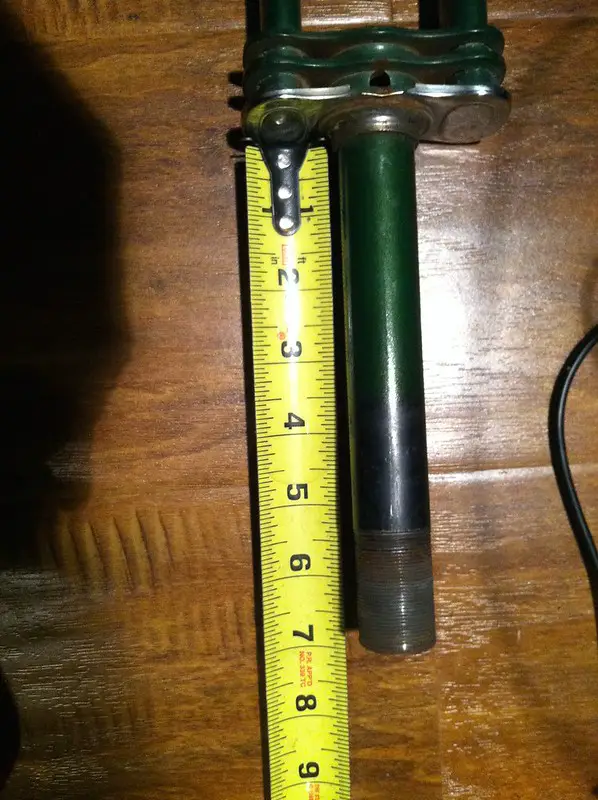

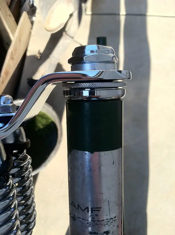

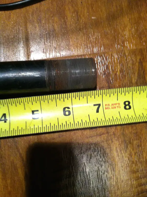

Took measurements of the fork today before ordering the monark forks. Not sure if I'm measuring correctly or not.
Diameter is 1 inch.
Threads: 1.5 inches
Steerer tube: 6 3/4 inches
This is how I measured the steerer tube:
The Monark fork specs are 1 inch diameter, 7 inches in length, and 13/4 inches of threads. Do you guys think it'll fit or will it be too long?
Also picked out the color for the bike. Electron Blue Pearl, it's found on 2000 Civic SI's. Here's an idea of what it will look like.
knightscape
Jul 29, 2013
340
16
Maine
Too long isn't often a problem as you can always use spacers borrowed from other old headsets to take up the gap, or just cut down the tube. Too short is where you don't have any options.

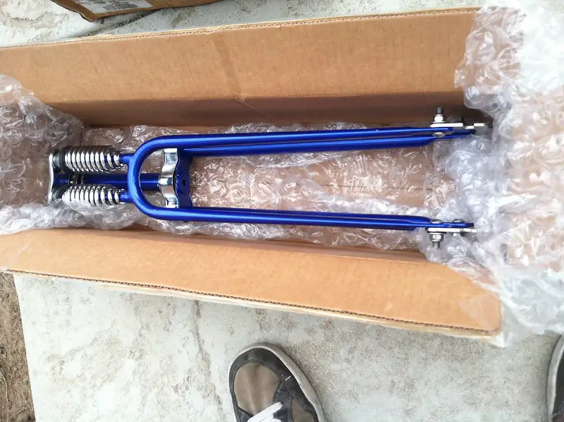

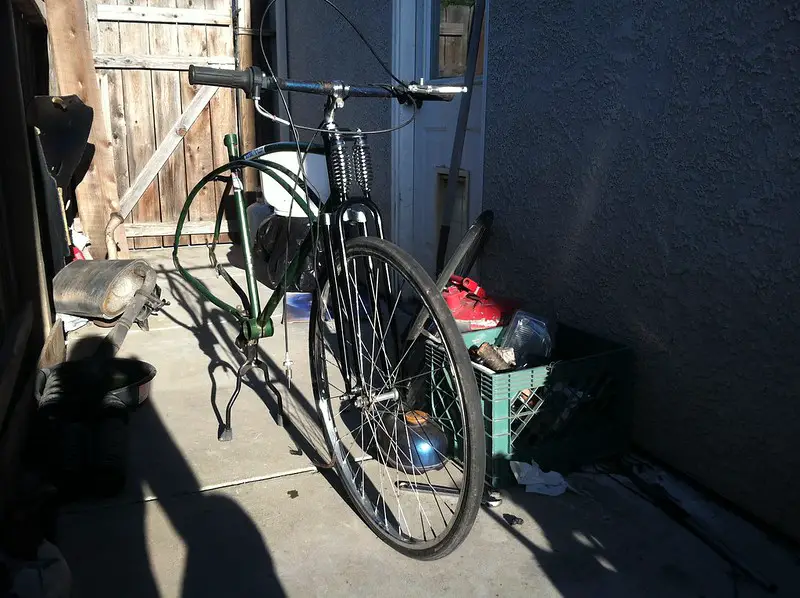

Time to update!
Front rim was supposed to be done of the 10th, bike shop finished it today.
Also got the springer fork. VMB if you see this, Thanks again man! It's just a tad long, an extra washer will do the trick.

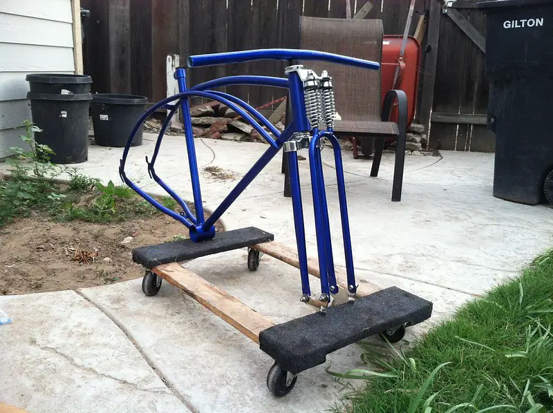

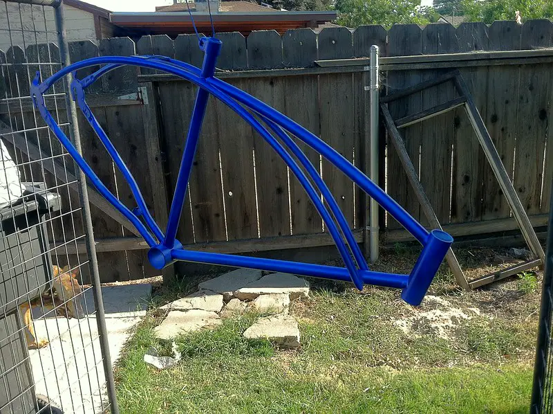

So I got the bike painted and ready to be put back together. I really like this color, it really pops out in the sun. Got home and started putting the front end together and ran into nothing but problems.
But first here are some pictures of the bike all painted.
