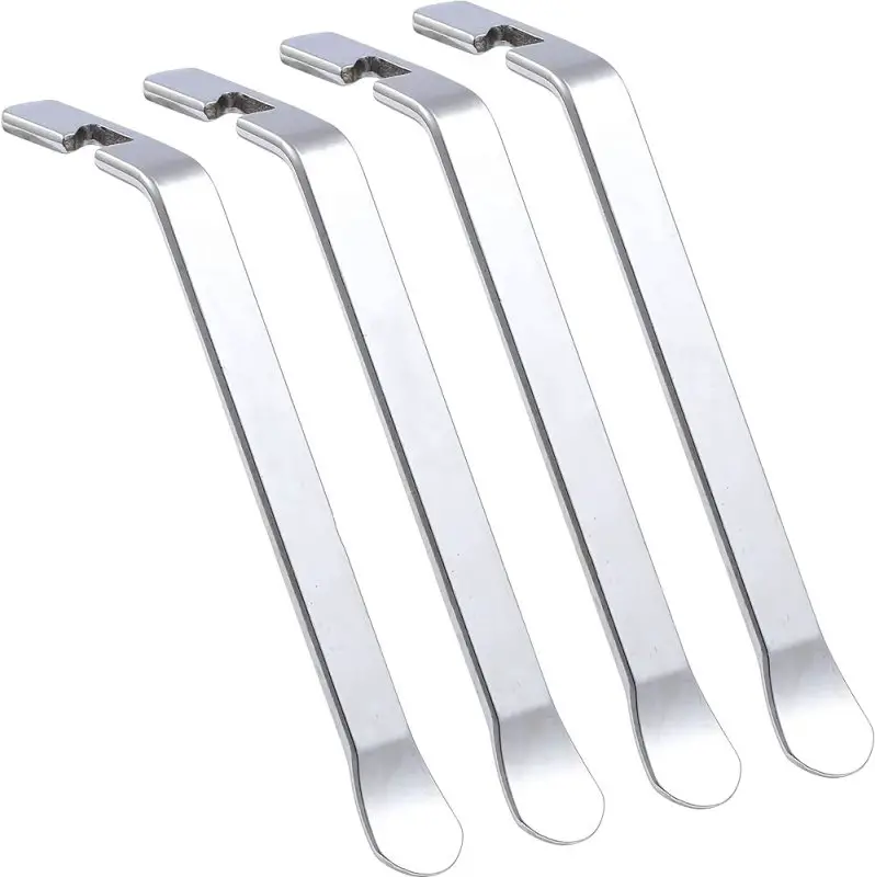

Tire spoons with spoke lock notches are the way to go.

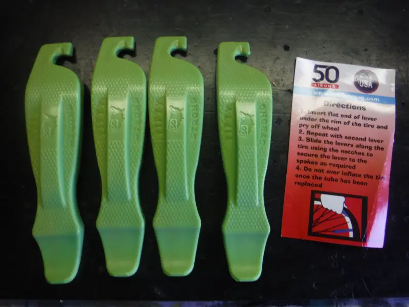

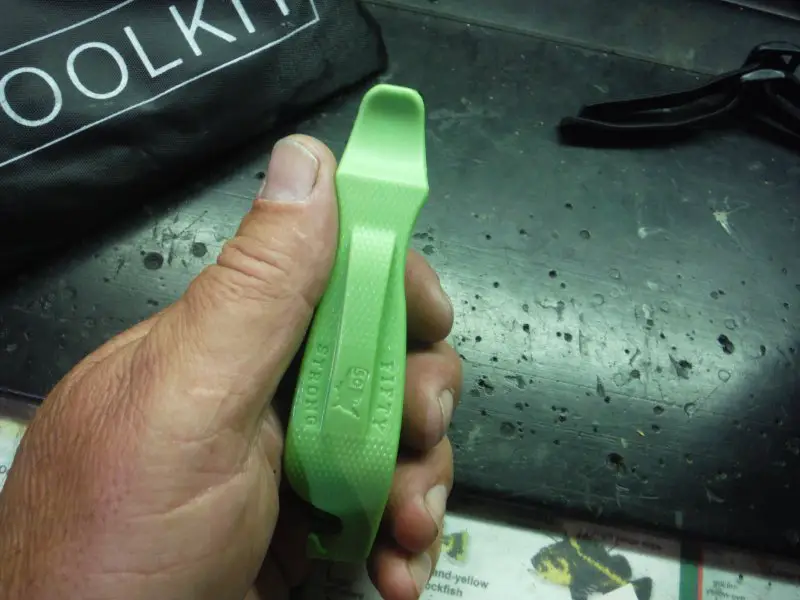

Sold at Walmart, 2 for $5 Made in USA "Fifty Strong"
Nice big wide levers, These won't bend like other cheep plastic tire levers

I never knew that and I always wondered what the hook end was for. Thanks a lot
