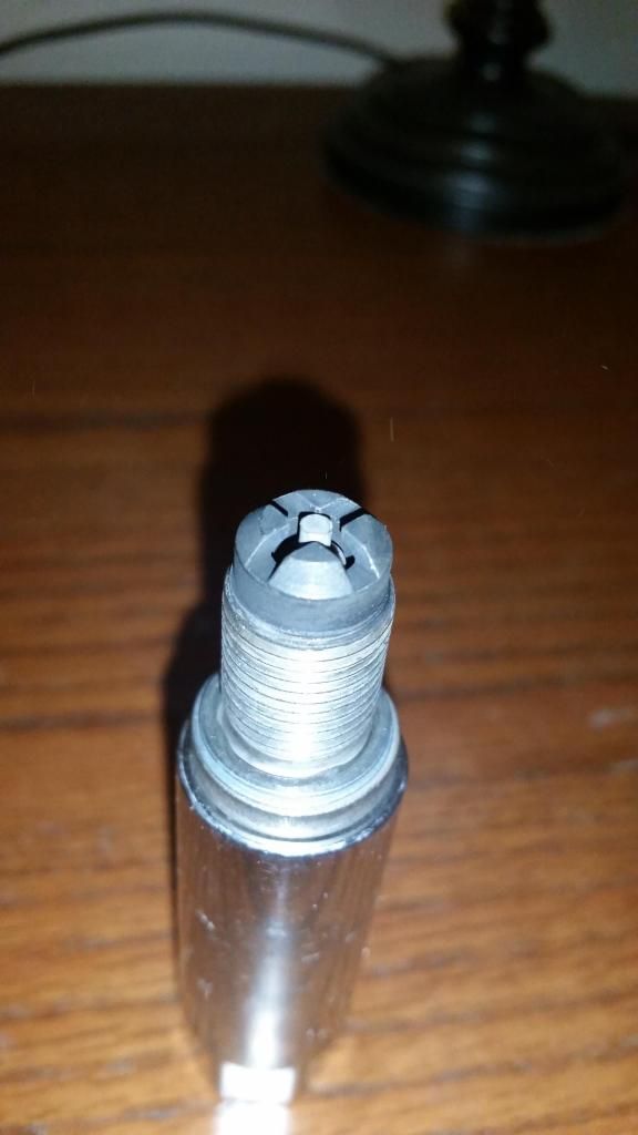

I'm tuning the pred 212 with a gx390 carb. Currently it has a .043 #109 jet on there. It idles fine at 2000rpm, but has a slight hesistation at first throttle. But if it's idle at 3000rpm, the hesitation is reduced a lot.
I tried .039 about two weeks ago but it would only run half choke.
Picts of sparkplug below, it looks slightly rich. I think I'm close, I'll see if I have a .041 to tried
What do you guys think I should do?
