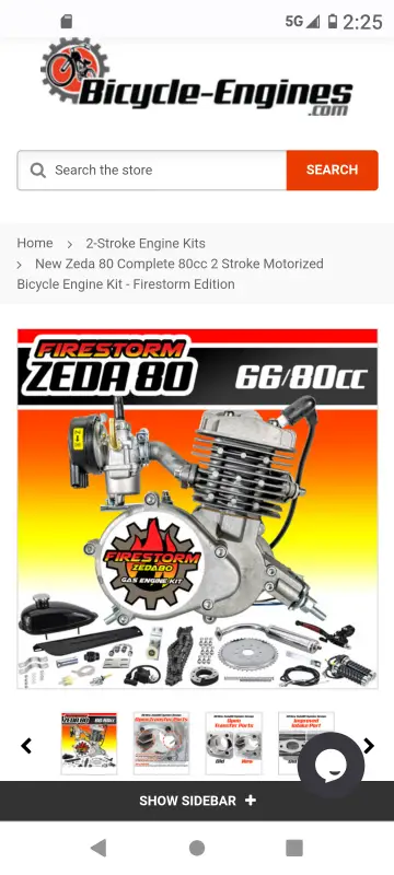

For torque some have used the pk 80 short rod wildcat cylinder with the long rod zeda crank... Puts the exaust port lower... It's not a simple swap and needs some work to get the squish right... Some gasket stacking or a spacer... ;)
