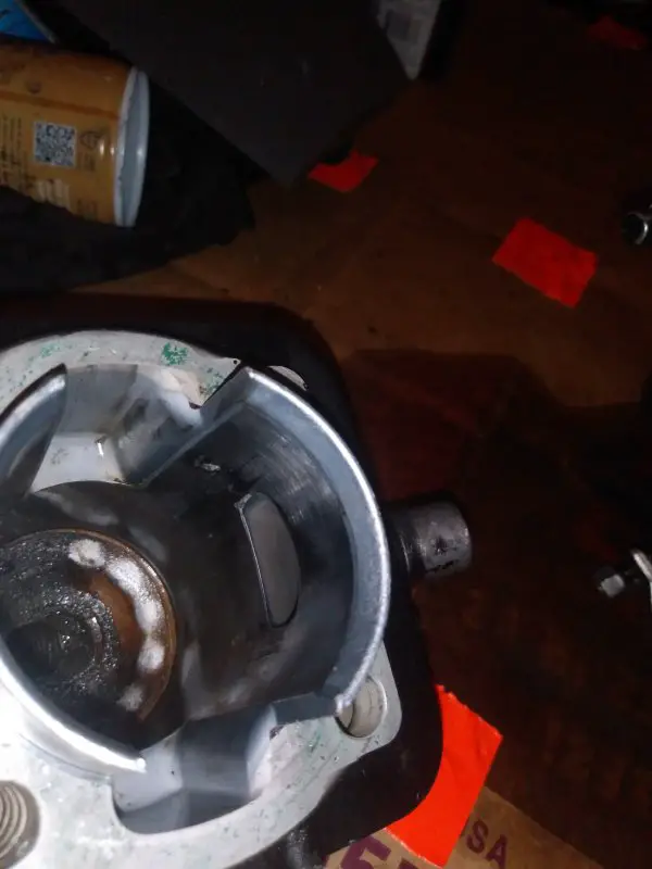

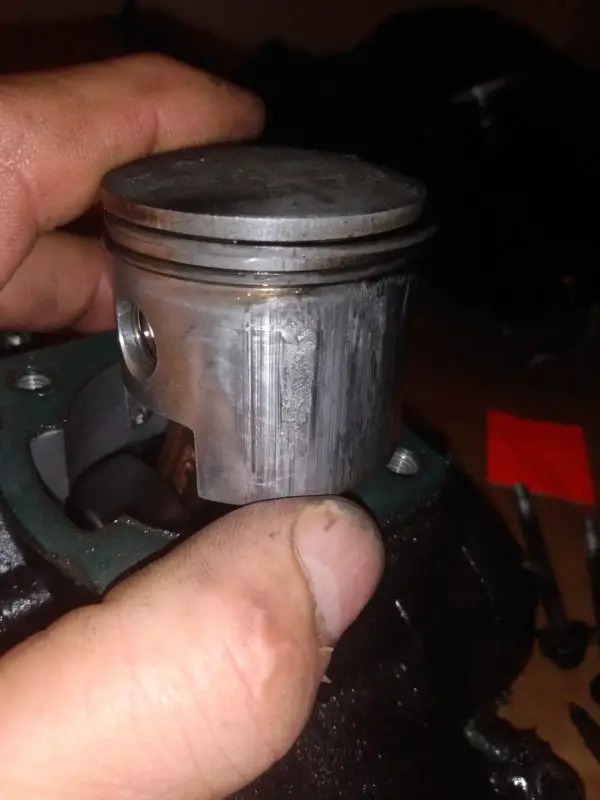

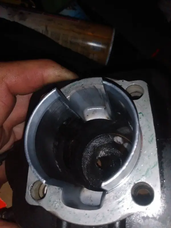

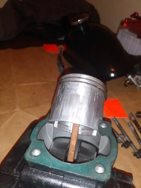

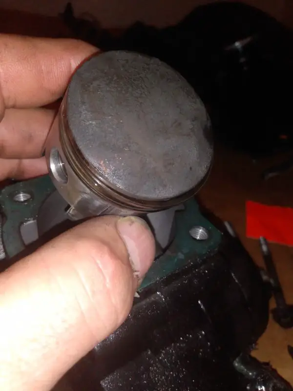

I took the jug off and all I found was a few scratches and the bottom ring was a bit stuck but not real bad. Although I am not very skilled with this stuff . I would appreciate all the advice I can get. I feel like I can possibly sand this stuff down and it might be ok. ???
Here are my thoughts on this... Running too lean can cause this problem.
Running too much oil (16:1 mix) makes the mixture lean... (more oil makes less room for gas).
I would break it in at 32:1 (& ride it like you stole it)! , because riding at moderate throttle 'can' also cause a lean condition.
Also... riding it fast means that there's lots of air flowing fast over the engine to cool it!!!
Last thing... Don't break it in using synthetic oil!!! It works too well & the rings will never break in properly.
What did the seller say about the Vid pics you sent him?
The spark plugs looks good like caramel is how I described it to my friend. I haven't heard back from the seller about how to get the videos to them yet. The email will only let me send up to 25 megabytes I cut the videos and compressed them and still can't get under 25. I offered to post them on my Facebook where they could easily watch them but haven't heard back yet.
