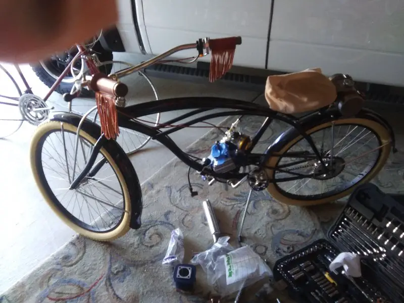

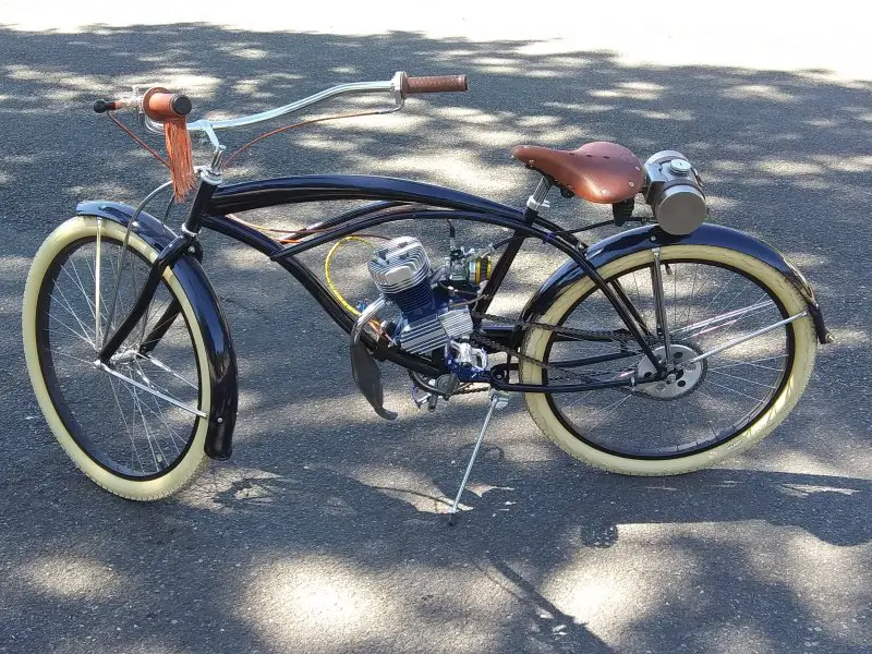

After 10 yrs I pulled this guy out of the corner ( NEVER STARTED) and gave him some modern high performance up grades, This guy has alot of Power!! Pulls a hill like nothing there.
Fred Head 6.5 compression head
ramped and skirted piston
Custom made mini expansion chamber
New Throttle
Runtong 15.15 Sha carb with 75 jet
OZ magneto
New Vantage Plug Wire
NGK B7HS plug with Raja Nut
Diamond 415 chain

Kinda small expansion chamber, does it add anything?

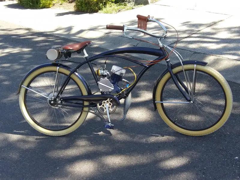

Ha! a badge of honor :) I like the wheels, nice tires too, you should get good traction, it's really a great looking bike! What you are using to stop that thing?
It's another badge of honor seems like I have a shoe box full since about 6 yrs. old .
It has Kick Back Brakes so a planned stop is required but then everything is planned when you ride a motorized bicycle with the way drivers are these days. Bubble wrap is a + too LOL!
