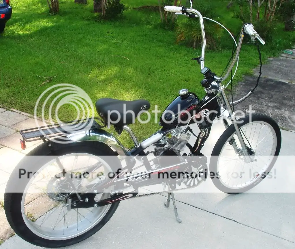

OCC Stingray "SPORTSTER" Black & Chrome
Almost finsished...! Final tweeks and motor side chainguard.
Hit 32.5mph - should do 35+ after a little break and someone smaller than me on it!
Sweeet!
.shft.

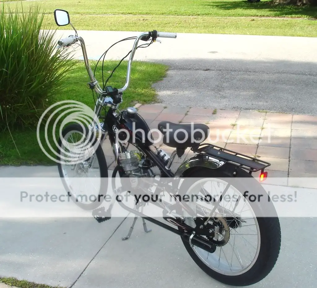

NOTE: My 24 inch rear upgrade kit - makes OCC much larger in conjunction with seat post assembly and apes / forks, etc.
It gave me my share of problems but a little more tweeking and on to the next build!
Lovin it!.trk
it looks pretty cool!
but in my opinion, you should make a bracket to move the rear fender back so it's tighter to the rear tire so the radius of the tire and the radius of the fender match up better. again, that's just my opinion.
what size sprocket do you have on that?
it looks like a 36, and with the 24" rear wheel (what's the tire diameter? 26"?)
I would think that the top speed would be higher.
My bone stock 66 cc, with a 41 tooth rear sprocket, stock 20" rear wheel (24" tall tire) can hit 30 mph.
