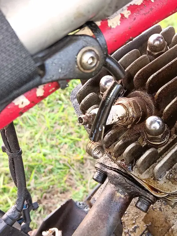

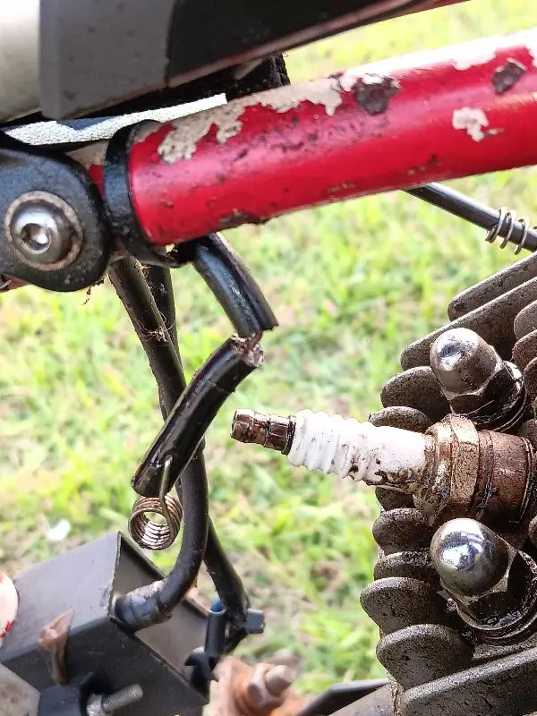

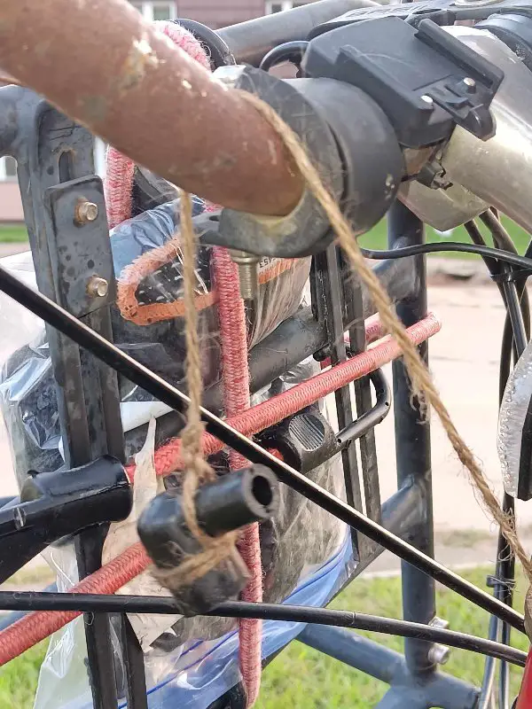

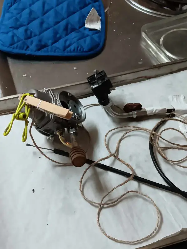

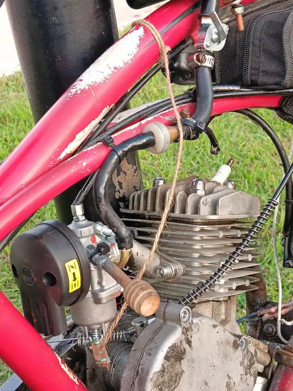

I decided to add a special accoutrement to my motorized bicycle, that I wanted to let everyone know about, just in case they find themselves on a runaway bike with no way to stop.
I tied some twine around spark plug boot and looped the other end up, tying onto frame of bike, so that in worst case scenario (when everything else has failed) can grab cordage and yank spark plug wire completely off spark plug.

If dieseling, my "emergency stop" yank cord's removing spark plug lead from spark plug wouldn't stop dieseling motor, but fuel starvation definitely would stall motor.
My NT carburetor has flip valve on bottom of carburetor bowl, instead of typical screw stop to drain fuel from carburetor bowl.
If needs be, could turn fuel petcock off, and install another emergency stop yank cord, this time to the "flip valve" on bottom of carburetor fuel bowl.
In this scenario, would be having two "yank cords" in hand like horse's reins, yelling "Whoa Nelly"! ;->

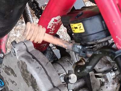

Raising the choke lever on the carb is a simple way of shutting off the engine
lol Why didn't I think of that? Once everything's sorted/repaired, will try "choke" method during WOT test drive. I've already got a long extension on the choke lever for ease of operation during riding.

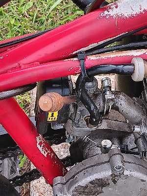

lol :) it's a wooden "honey spoon" from thrift store, sanded/contoured fitting choke lever & JB Welded/tie wrapped into position.

c) Pull/yank cord to remove spark plug lead and boot from spark plug works (with caveats).
While pull/yank cord will stop engine, bugs remain to eliminate:
1) System works, but takes hard pull on cord to remove plug wire.
2) boot wants to separate from plug wire.
3) my spark plug wire is decrepit and needs to be replaced (but it still works).

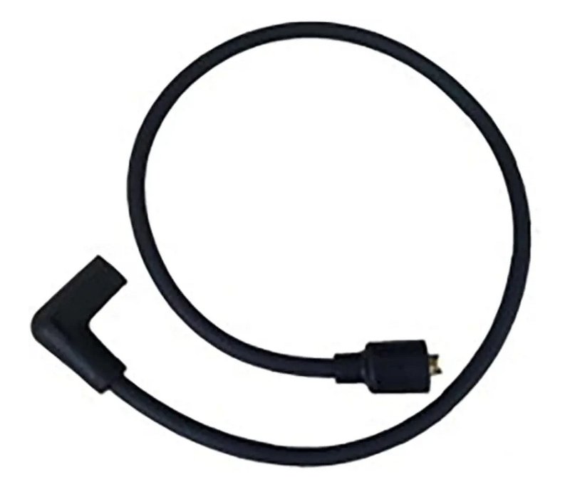

Would be nice, if link to purchase on Amazon/eBay at reasonable price, but that's not what I'm finding through searches.
Persons making up their own spark plug wires have to buy length of wire, special crimping tool, end pieces, boots.
Further annoyance results from hassling with super glue adhearing spark plug wire inside CDI, before new wire can be inserted onto screw.
One poster claimed using heat gun or hair dryer where wire goes into CDI will soften glue, making easier to twist wire off CDI's "screw" type connection.
Read up on methods dissolving super glue and bought nail polish remover (100% acetone) as one possibility, but searched lots of crazy things including: butter, apple cider vinegar, coconut oil and enough other ingredients you could probably cook dinner with.
Motorized bicycle sitting out over night, will straighten metal core wire, reinstall spark plug boot, and use high temperature silicone make-a-gasket to fill gaps in missing insulation on spark plug wire.
Should provide usable provisional repair, allowing use of bike, while sorting morass of opposing opinions on where to buy decent spark plug wire for replacement on motorized bicycle.
I've only found one decently priced link on Amazon, which might be for what is needed? Can't determine from description whether or not is solid metal/copper core, non-resistor wire/non-resistor boot?
I heard back from Amazon seller is non-resistor, copper core wire. Went ahead and ordered and will post how spark plug wire works out: if it's any good, and only time will tell, if insulation is any better than spark plug wires/boots shipping with kits.
