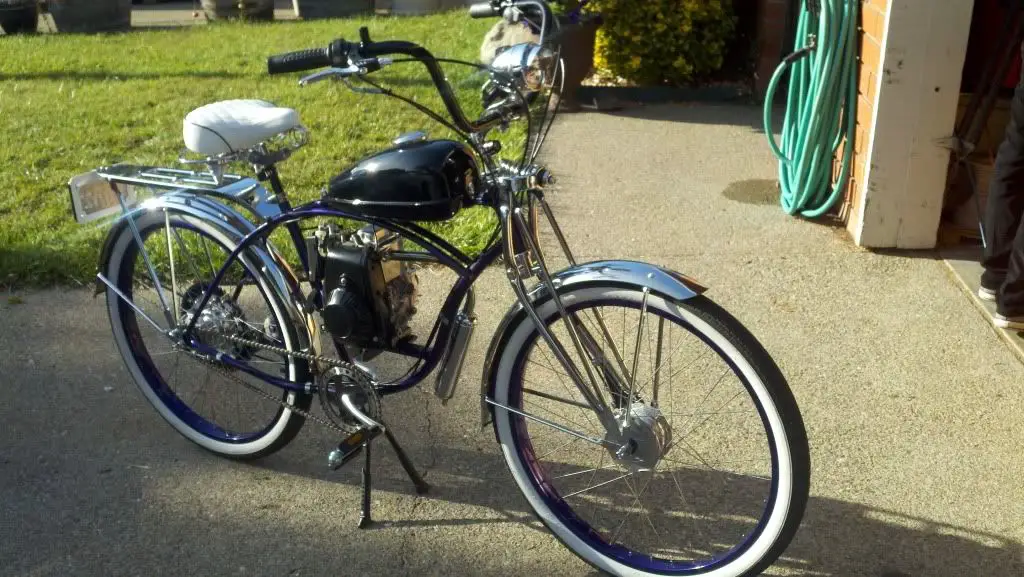

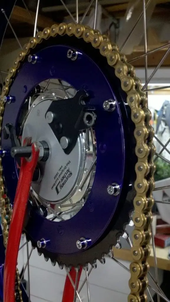

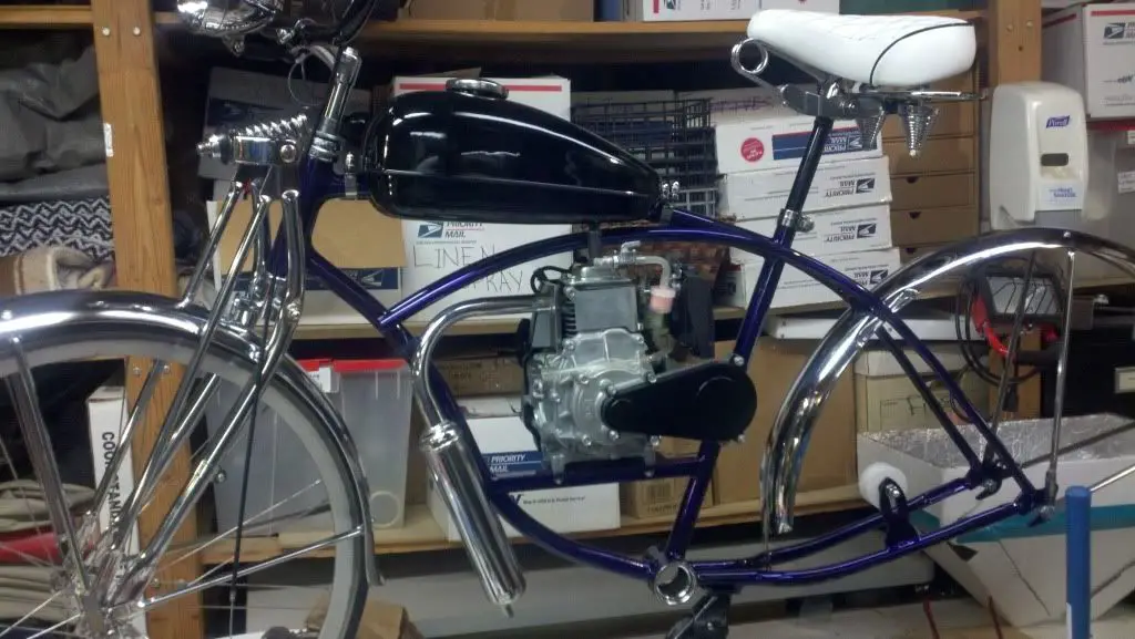

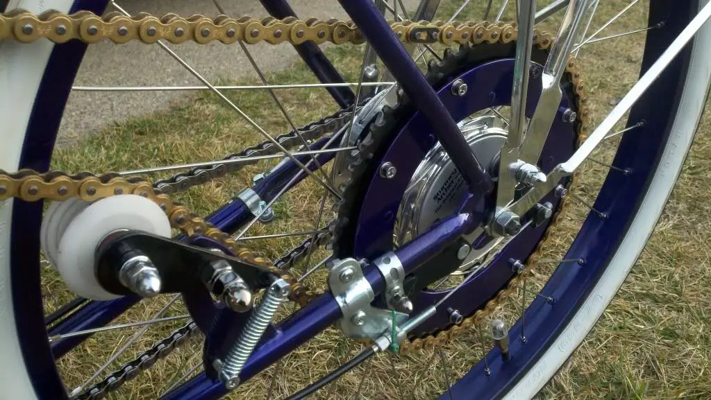

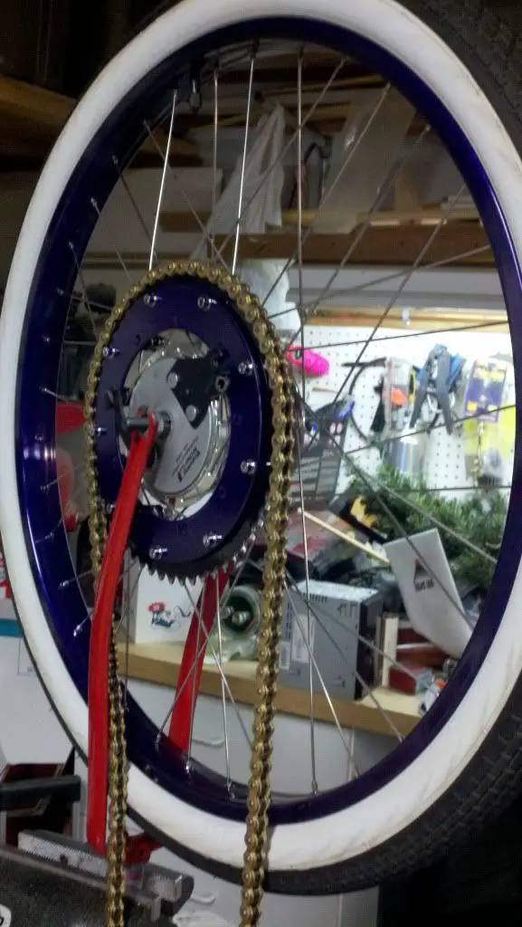

here are a few pics if my sproket setup.....any feedback.....will post more pics of bike soon.
looks cool so far :)
I am digging the rear brake/sprocket set-up !!!
now, I need to see more ;)
thats one nice looking sprocket and bike man good job
Thanks man....it was my summer project and loads of fun to do with the kids...the guys at work called me the old man on a purple bike....then I let them ride it...theyy all thought it was cool and now want one...

The rear sprocket was a challenge as I had to put the bike together first then designed the rear sprocket setup and finally had a friend laser cut it for me.....its a beast......

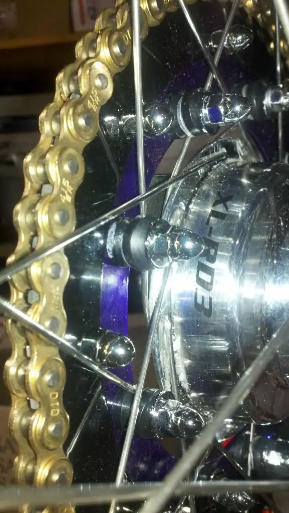

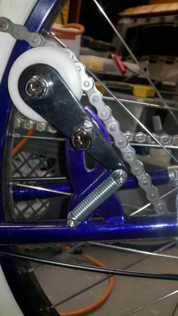

Agreed, nice looking sprocket, and tensioner too. I'm curious how you attached it to your spokes. Can we get a pic of the back?
I've recently had to hog out a 60t by cnc to clear an old '60's drum(pics here). It doesn't look anywhere near as sweet as yours though :)
The rear sprocket is attached to spoked via 8/32 studs, 3/8L hard rubber washers, bent retainer washer and finished with chrome nuts. Here's a pic....this is the heart of the build...
