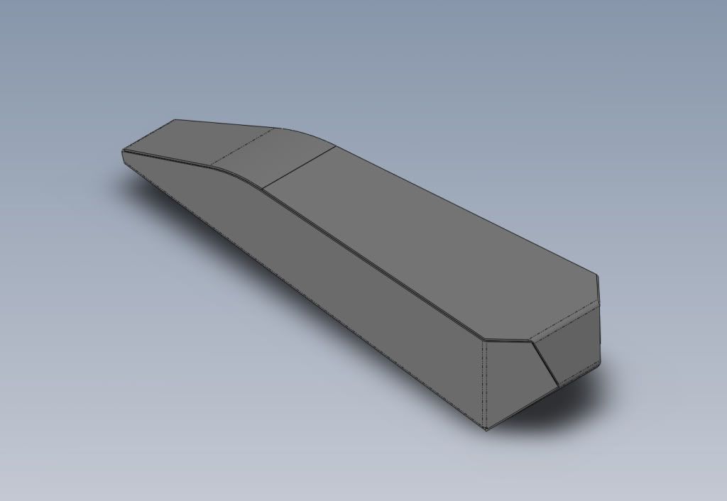

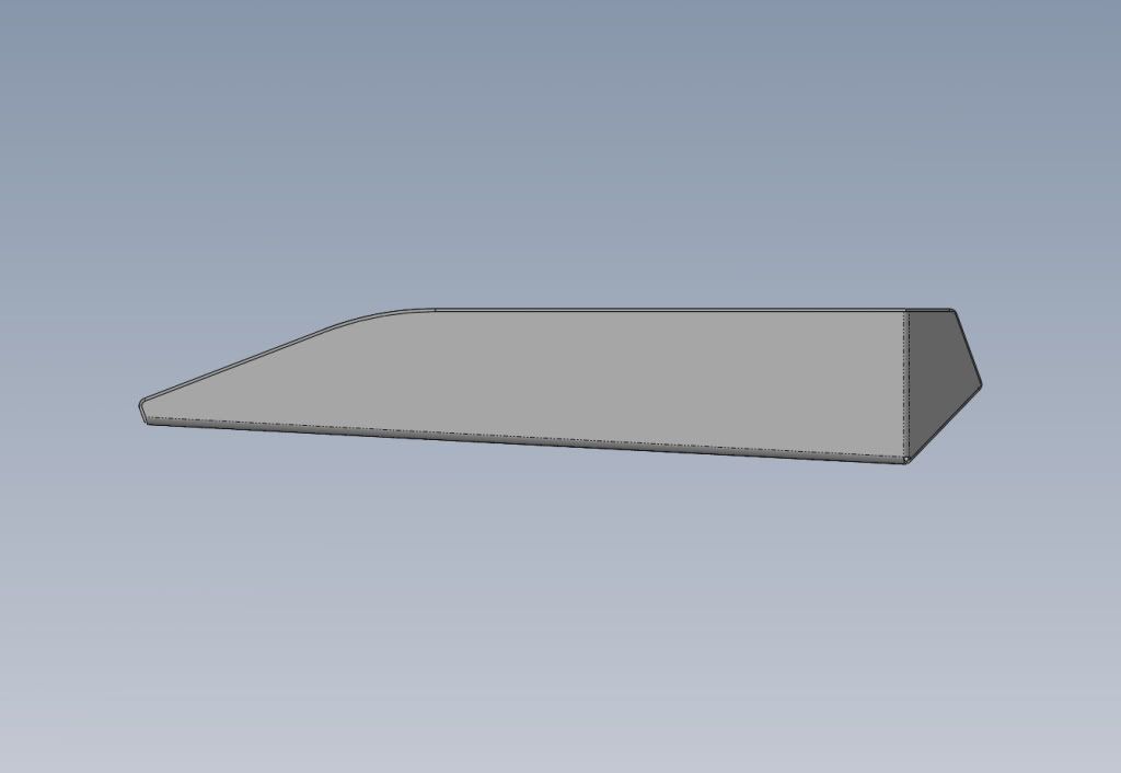

Did someone say Mongoose or GT? I still have my Mongoose Kos Kruiser from 1981 and a 24" GT cruiser. I did my first 3D mock-up on a tank last night then immediately changed it. I had left the sides flat with a tapered nose. It didn't look right being full width in the rear so I pulled in the width of the tail. The tank now tapers continuously from the widest point where the gas cap will sit. It tapers forward from the cap and then back from the cap. It still follows the side view of the Reading Standard boardtrack racer. I had figured that most people would paint these tanks but it seems most everyome is just leaving them in a raw finish. Flybytaco, your build is looking great and the chrome fork, bars and wheels will tie in nicely with a raw stainless tank. I will start a thread and show the tank mock-up once I get my home computer back on line. Look for some spy photos early next week. I hope to get through the design phase this weekend and then get a couple prototype tanks cut next week.
Here are a couple views of the current CAD file. I will start a separate thread as this develops further.

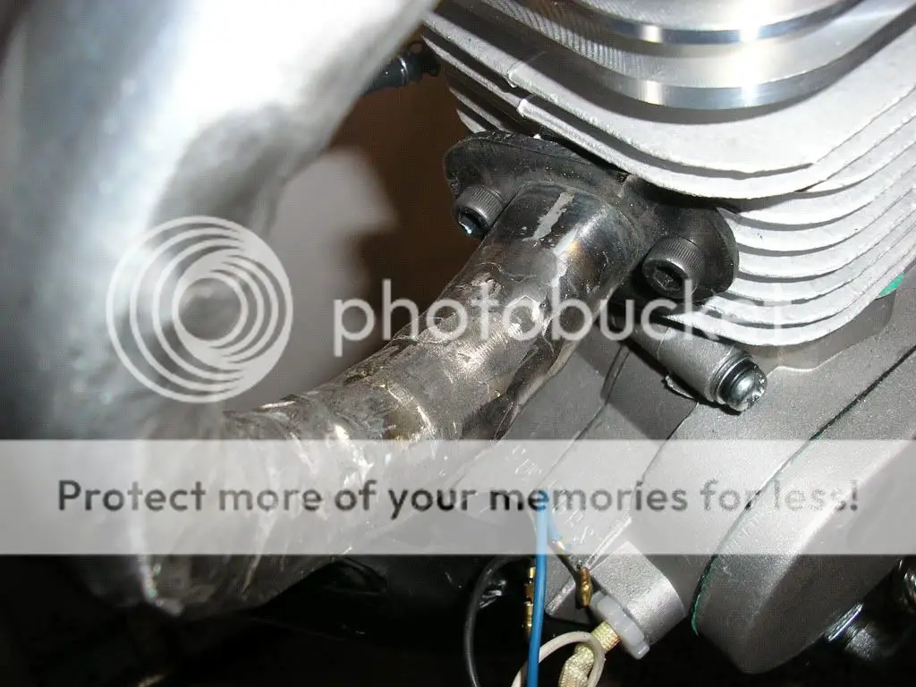

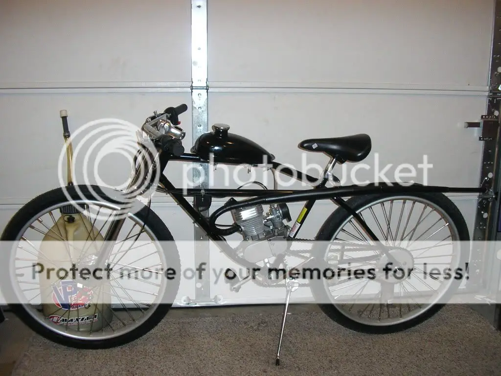

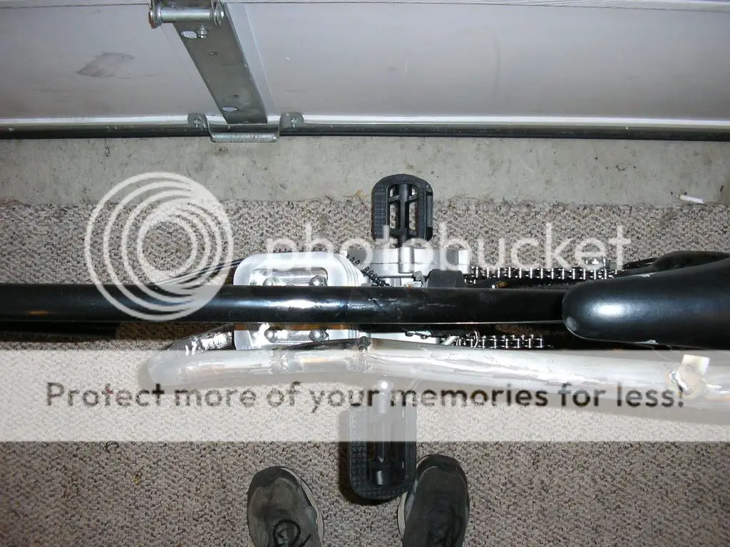

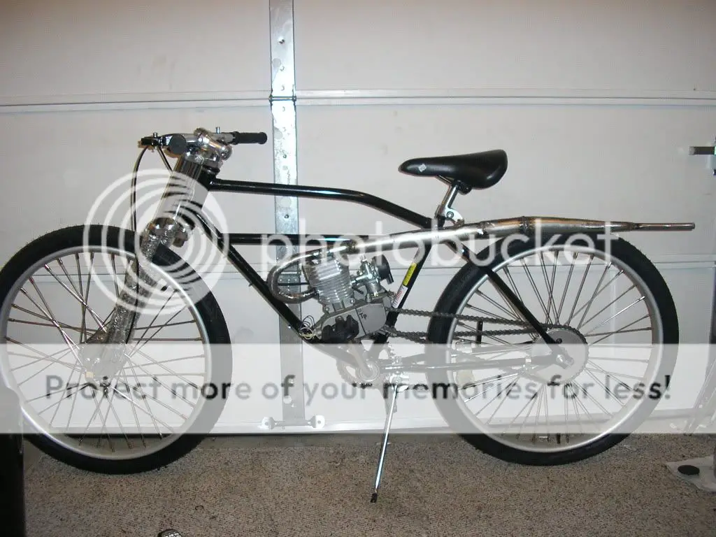

ok so this is a test protype pipe welded with a mig looks likw crap dont worry it will get a ss one once i figure out the perfect pipe I also matched the header to the port
Looks like that pipe may limit the width of your gas tank...

im not putting that tank on for a while and like i said prototype test pipe i will arc it dwn a bit to compensate for tank its inly in the way like half inch pictures dont do it justrice
the tank is not permanent waiting for the custom one. pipe is also going to be remade to fit the tank in and make it shorter

You should post a pic of your latest autocad design of the worksman tank, although the changes are subtle, I think your newest rendering is right on the money and very well in-line with the black motor bike that you pictured in your earlier posts.
The Worksman's builders are going to be impressed, that's for sure! Don't forget the rough-cut flame job on my next tank...brnot
