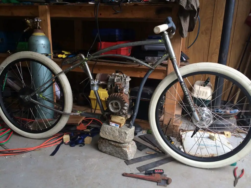

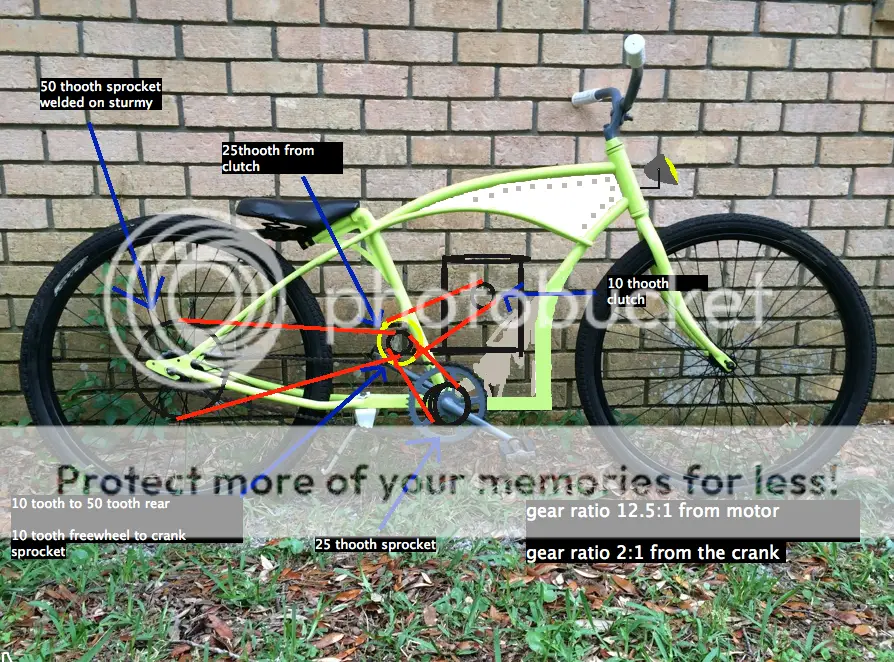

ok this is what i have came up with. haha hope someone can understand what I'm trying to do and tell me if its going to work. first off I'm cutting and bending the down tube back to make room for my motor to fit the way i want it to which is straight up and down. it will fit now but only at a angle so this is what i have to do. already have chopped it up once and i can do it agin. second problem i ran into was finding any 50 tooth to put on the SA hub so I'm planning on taking the 22 tooth thats on it and welding the 50 to it to make what i need. and yes i know i didn't catch the grammar errors in my picture i just threw it together but you know what I'm talking about. never was good at spelling or grammar. the reason i chose the tooth count like it is was to try and avoid a big gear right in the middle of my art work of a bike. rather have just one big gear on the wheel instead of in the middle. tell me what ya think

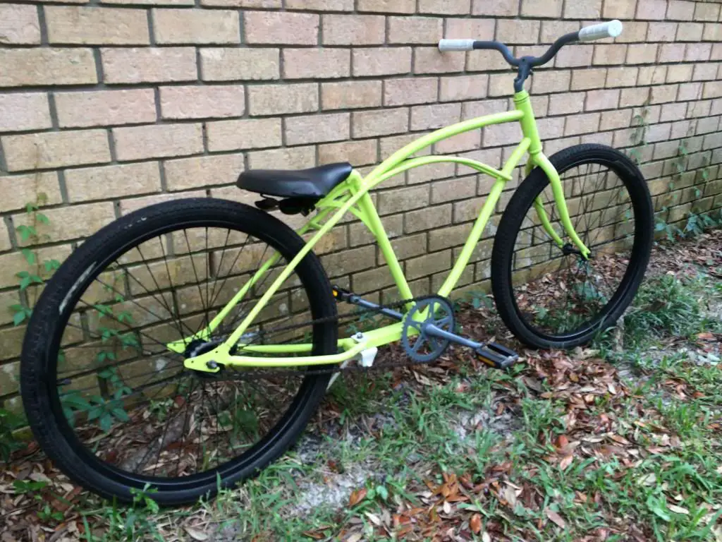

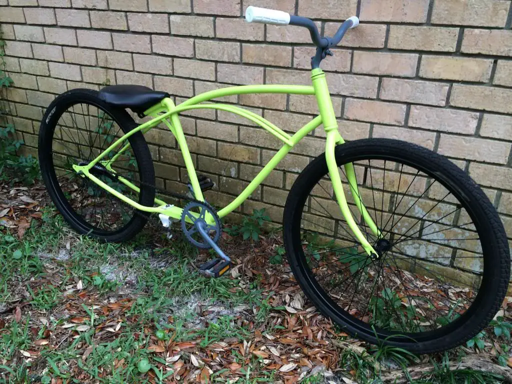

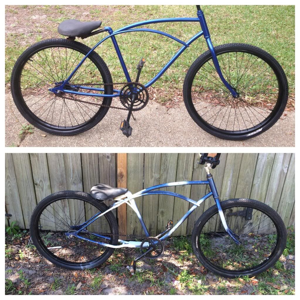

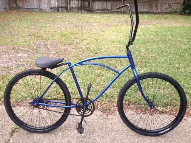

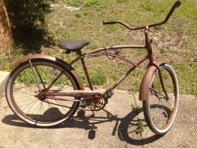

it is a murray beach cruiser. i bought it off of craigslist for 30 bucks. just needed new tire tubes. this is what i looked like when i bought it. then fixed it up and now its green.. but its about to all come off who doesn't love pictures haha its stretched 5 inches. lowered 2 inches and i cut out half inch out of my forks. you can see how close i have that tire to rubbing and this last picture is to give you an idea of what it was before to after the chop. so much more style
This is an update. I ended up going with a 40tooth in the rear. Took an old 3 prong sprocket and ground off the teeth tell it fit in the new one and welded it up
