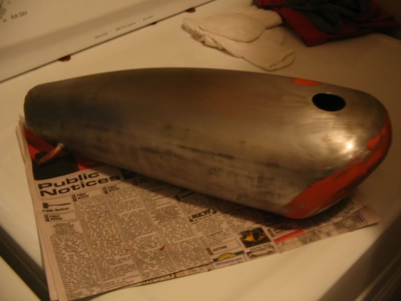

here's how these tanks look in their stock form.
here it is with the weld ground down and filled with bondo.
Also notice the fuel outlets that I put in the tank (made out of copper tubing and silver soldered in place)
here's the hole that I cut in the top for a gas cap. I used a dremel with a cutoff wheel on it to cut this hole, and then i used a small drum sander attached to a drill to make it perfectly round.

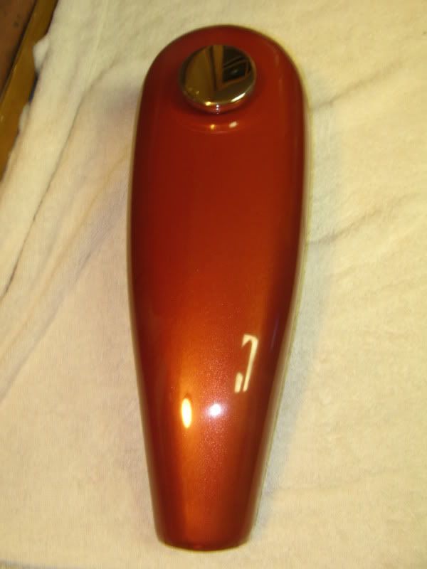

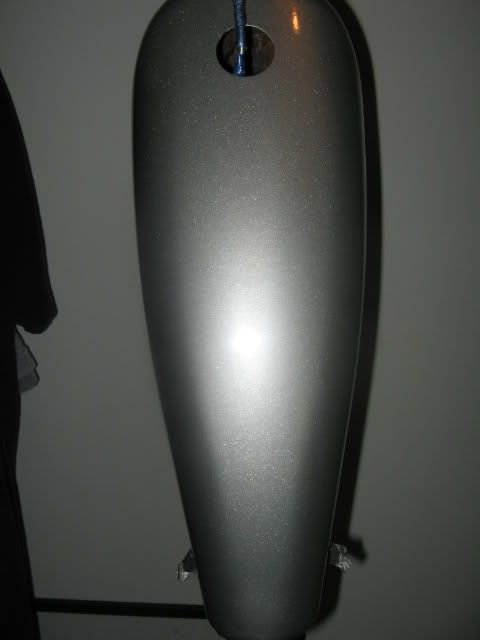

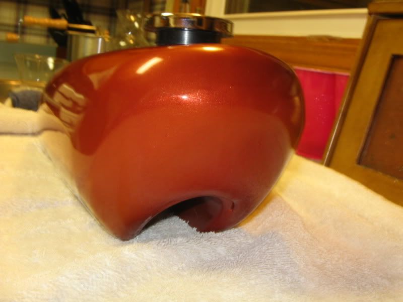

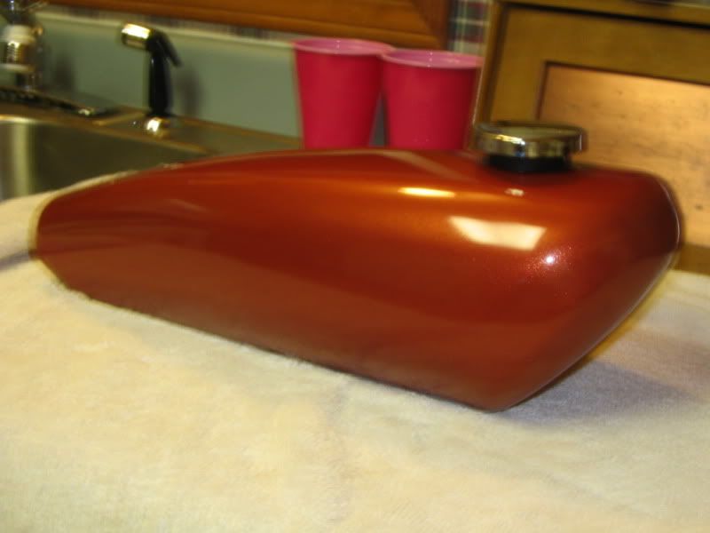

here it is all finished and painted. I used grey sealer primer on it, and then 5 coats of metallic black laquer, and 5 coats of clear laquer. wetsanded with 1200 grit paper, and then buffed.
