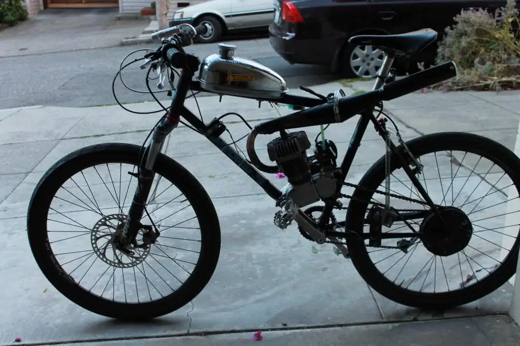

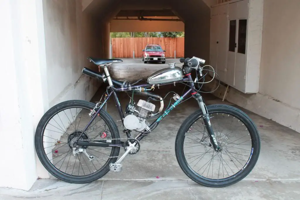

Just got this built a few days ago - not very pretty right now but with some cable management it should be getter. Faster and more comfortable than the cruiser it replaced. Ported 66cc china, high rpm pipe, 15mm dellorto carb but I have a 21mm on the way - 39t sprocket - i havent gone faster than 40mph but its got more to give. I need to build a new pipe because it has very little low end at the moment.
