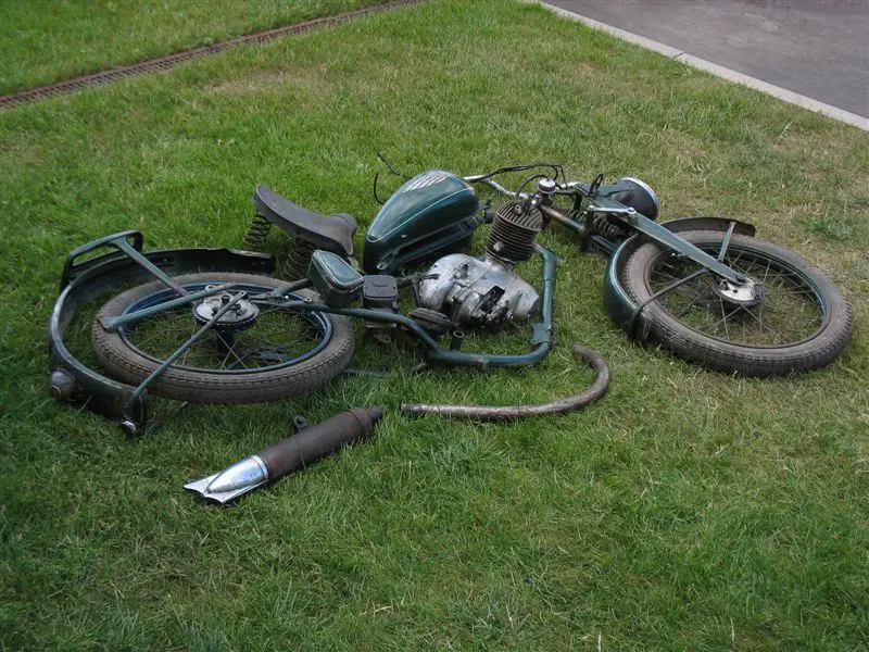

Maybe I could suggest:
1) round shapes of cylinder cap, so it will look more "veteran", like here:
2) Prolong muffler tube, so muffler not just hangs in front, but smooth hidden under frame. Maybe even take muffler from motorcycle, with a smooth ending, like this:
Original Chinese muffler is so far from optimal resonator, so every motorcycle muffler will not be much worse for engine, but could be better for lookout.
Beautiful bicycle and what more - nice pictures!
As for one, I probably won't go that far at least or now.
As for two, definitely, I hate the current muffler and a long one is in the works but will probably be combined with one of those Sick bike type muffler/resonator to improve performance so this suggestion is very well taken.
I also want to add a bottom plate/plates to give the illusion of a larger vintage style engine and a leather tool box to go in the rear gap of the loop. Thanks for the suggestions.
