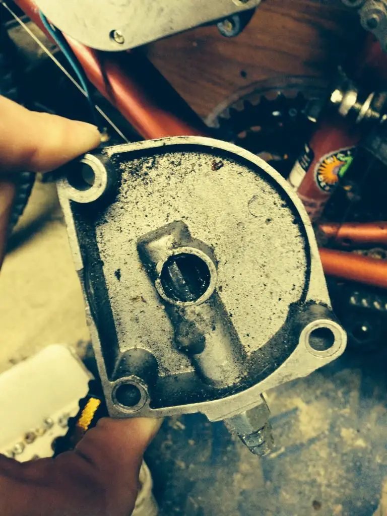

S shmatko00 New Member Sep 13, 2014 #1 Hi I have a motorized bike and the cap dosent lock on what could be wrong with it? Is there a part missing? Thanks for any help!
Greg58 Well-Known Member Sep 13, 2014 #2 Welcome to the forum, I don't quite know what you are talking about. The cover you are holding should have the clutch actuator arm on it that the clutch cable connects to. If you can give more details of your problem I'm sure someone will help out.
crassius Well-Known Member Sep 13, 2014 #3 I see in the pic that you have the small spring on the loose cable end - you should get rid of that since it is not used for builds these days. That cover goes on with the longest bolt at the upper right hole and lever pointing about straight towards the rear.
