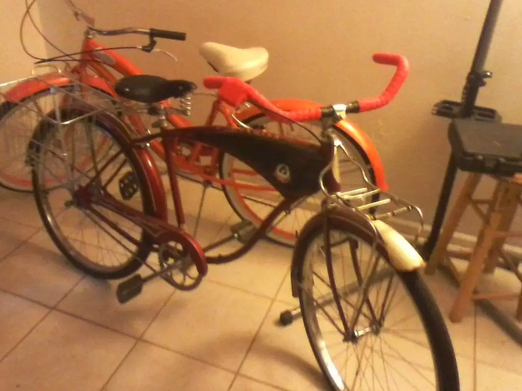

will this fit Is it difficult to install the transmission? What are some good wider crank replacements. Any advice or experience would be appreciated so thanks in advance. http://www.gasbike.net/products/79cc-monster-80-bike-engine-kit-4-stroke on this bike
I have the 79cc HF engine and I really like its power. Bought it straight from Harbor Freight Tools on sale. I bought the trans and engine mount from gb. Not impressed at all with the quality of the gears. And the engine mount works, but you have to take it completely apart to move the motor. I recommend steel mounting plate and steel gears. All of the other stuff can be bought through ebay. gb customer service is close to non-existent.

Yeah that's probably my best bet. Plus, I already know how to install and adjust one. Plus, They have a lot more upgrades since the last time I had one 5 or 6 years ago.
