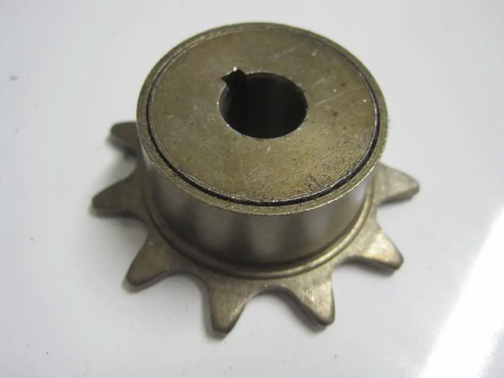

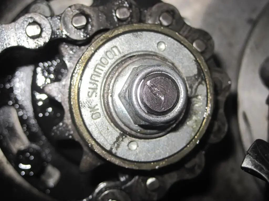

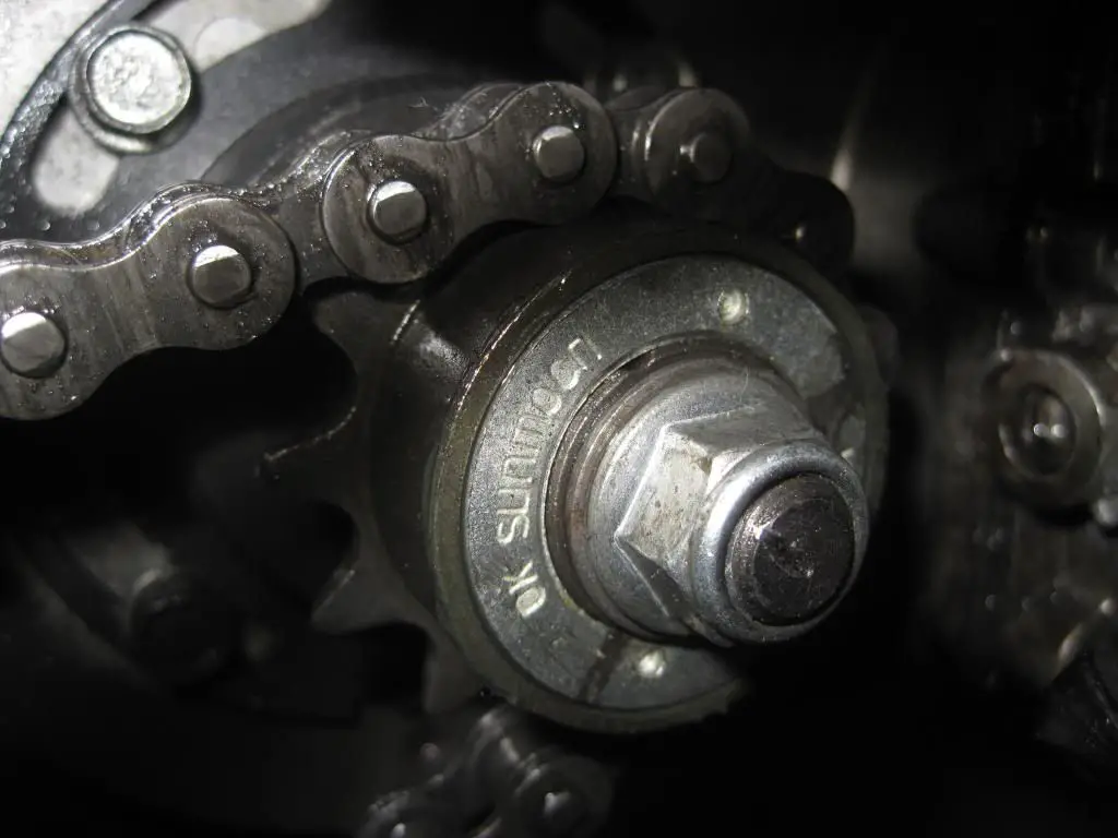

Stock bearing they throw in the box:
Heavy Duty bearing they put on all of their bikes:

That's not a one way bearing and what new and improved version? The one that came out in 2011 that everyones been buying for 2 years? The bearing is in the belt pulley,not the chain sprocket.
