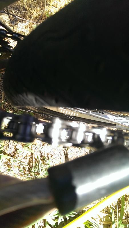

Almost without exception the chain guards that come with the kits will need to be trimmed and a little ingenuity applied to mount them. Usually they will need trimming to clear the rear tire. A lot of builders don't use them at all but some of us feel they are a safety device that should be there.

http://i2.photobucket.com/albums/y34/Nightrider1962/ZOE_0012_zpsd8f3be0d.jpg
tire and chain clearance

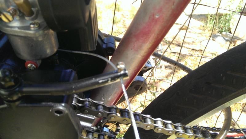

http://i2.photobucket.com/albums/y34/Nightrider1962/ZOE_0011_zps9e155cf1.jpg
the problems my brake lever and throttle are having

You really need to get rid of the small spring between the clutch actuator arm and the end of the cable. It serves no useful purpose and only makes the clutch harder to pull. The larger diameter spring that came in the kit is actually used as a heat shield to protect the clutch cable housing from cylinder heat. Retain it but discard the small one.
