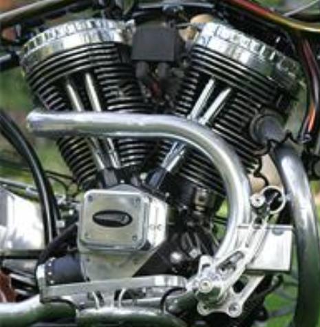

Oh yeah, have filed the edges of all the fins but not too much as I want to keep them thin but had to smooth them out before polishing. Am going to paint the bugger black and replace the clutch cover with one from SBP (that too will get polished). My goal is to make it somewhat resemble a microbial version of the engines I build day in and day out:
