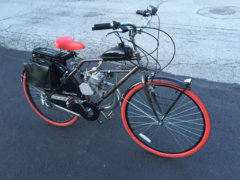

My first build, Huffy with Flying Horse - Was always too slow and vibrated much

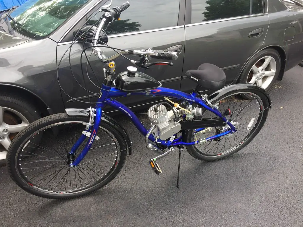

My second, Huffy with Silver slant 119.00 kit. Fast and smooth. I was pleased with this one.

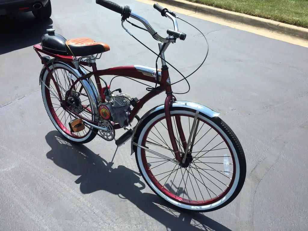

My Fifth, Huffy bike with Grubee engine. Very pleased so far. Just wish it was a 29er.

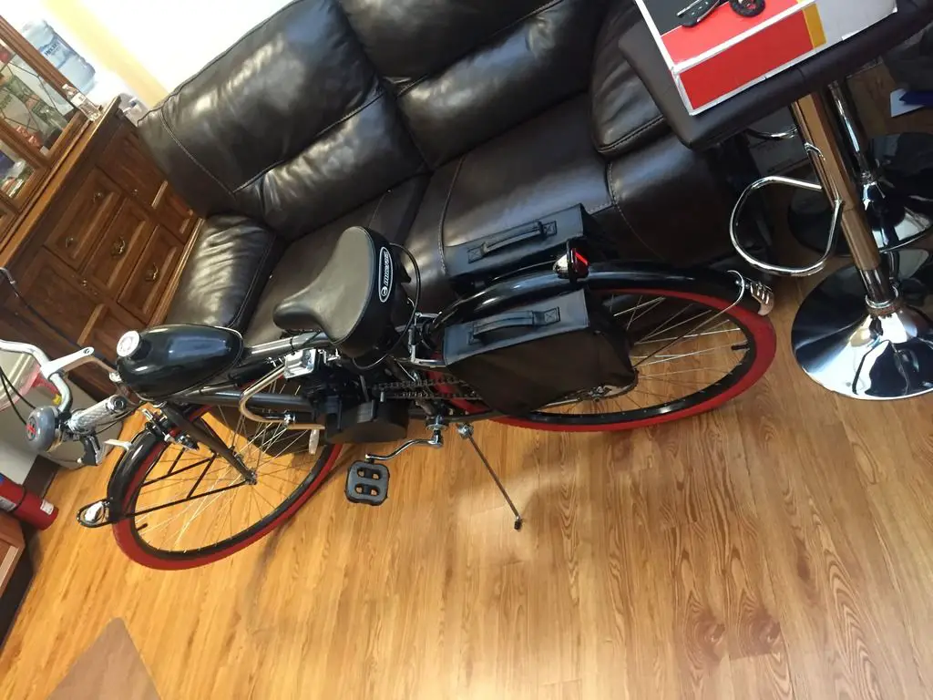

My dads four stroker, sorry bad picture angle, it's the only one I had right now
